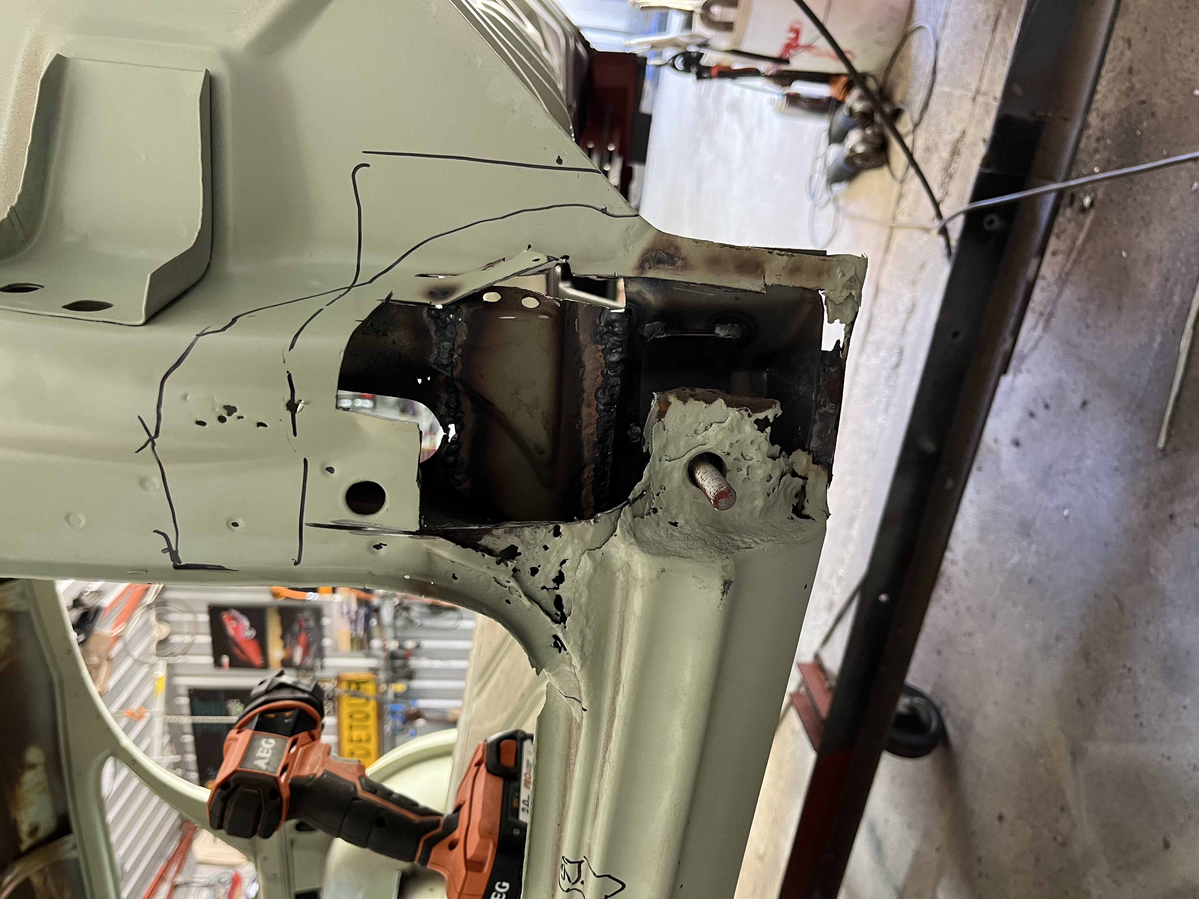

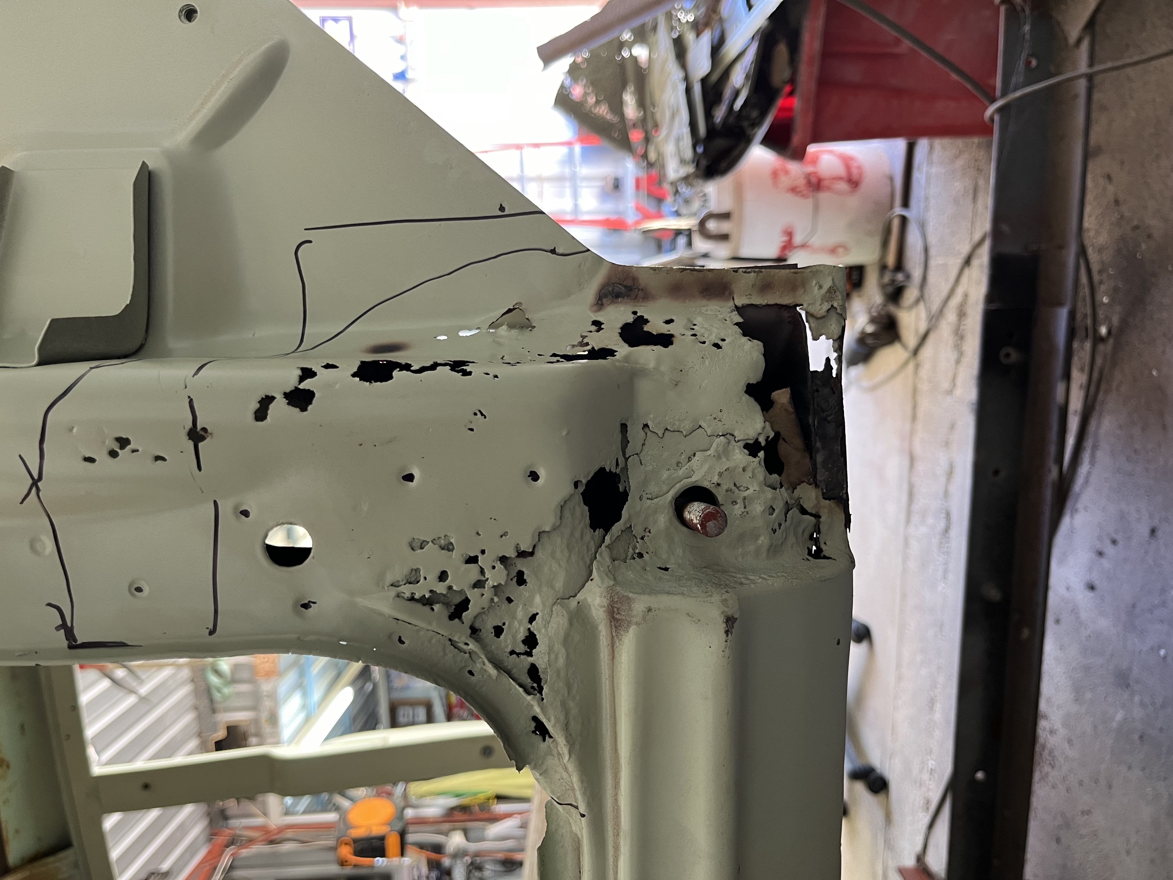

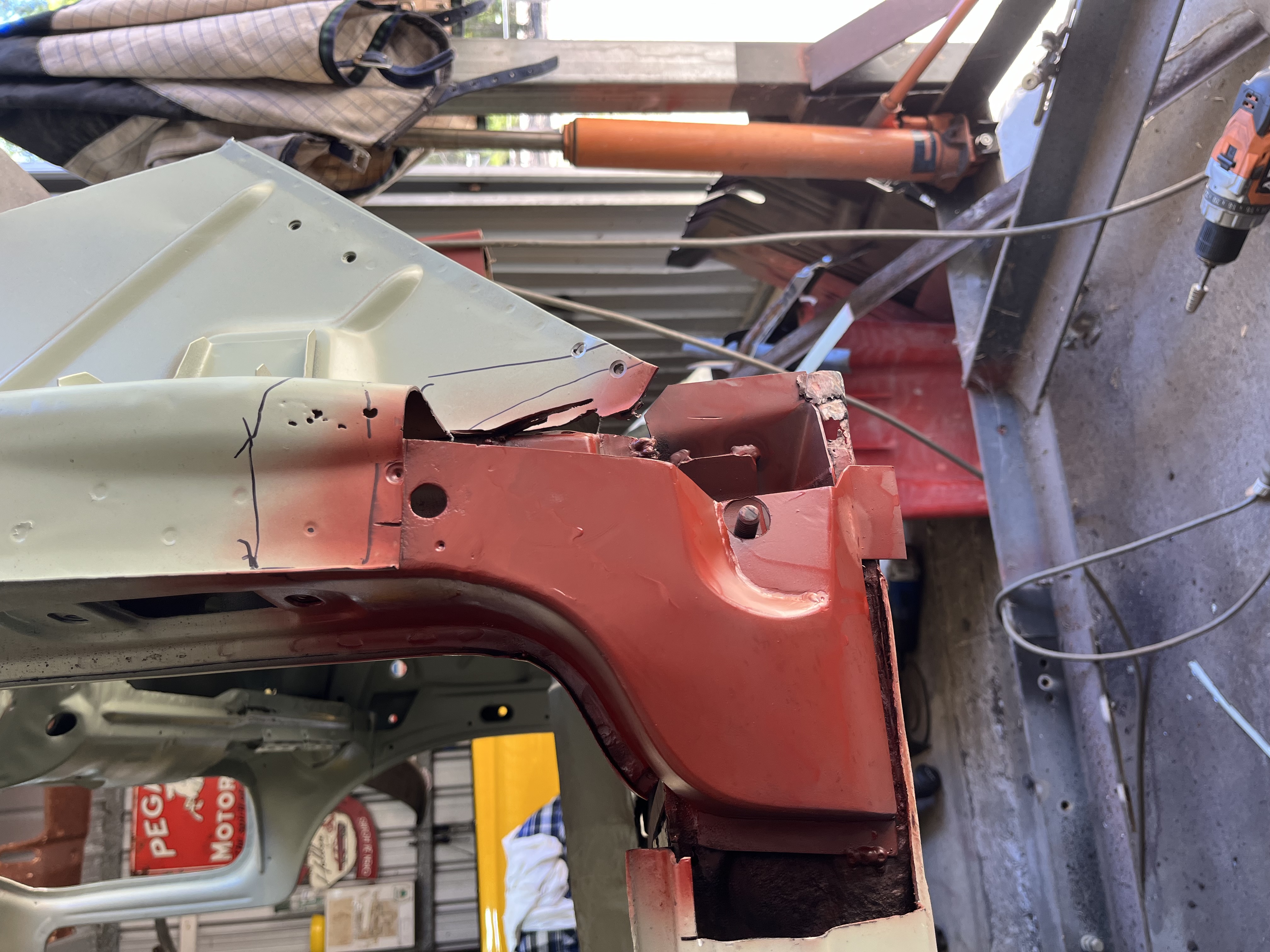

More done yesterday, decided to wait to fit the outer sill to the passenger side and start on the lower drivers side A pillar.
What a mess (thanks EK Mart :shifty: )
Looks like both the inner and outer on this side will have to be replaced.
Onwards and upwards I suppose. My grinding to welding ratio is still shit :lol: :lol: :lol:

Thanks Neil. I see that the inner pivots are moved inboard to suit the narrower track. Clever.
I see by your last photo that you are aware of the alignment of the subframe attaching hole axis’.

Posts: 2816
Re: Neil's FB Station Wagon

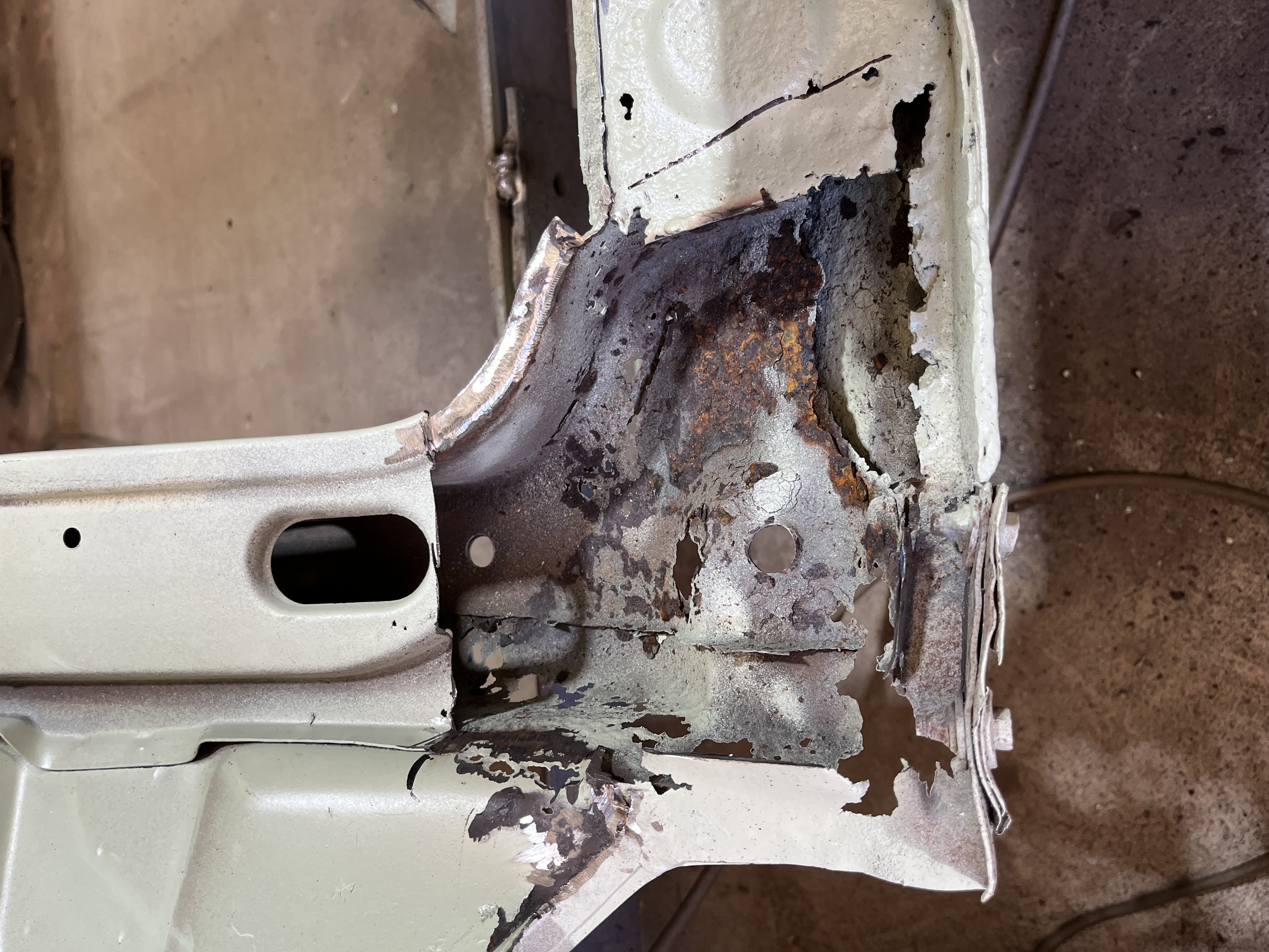

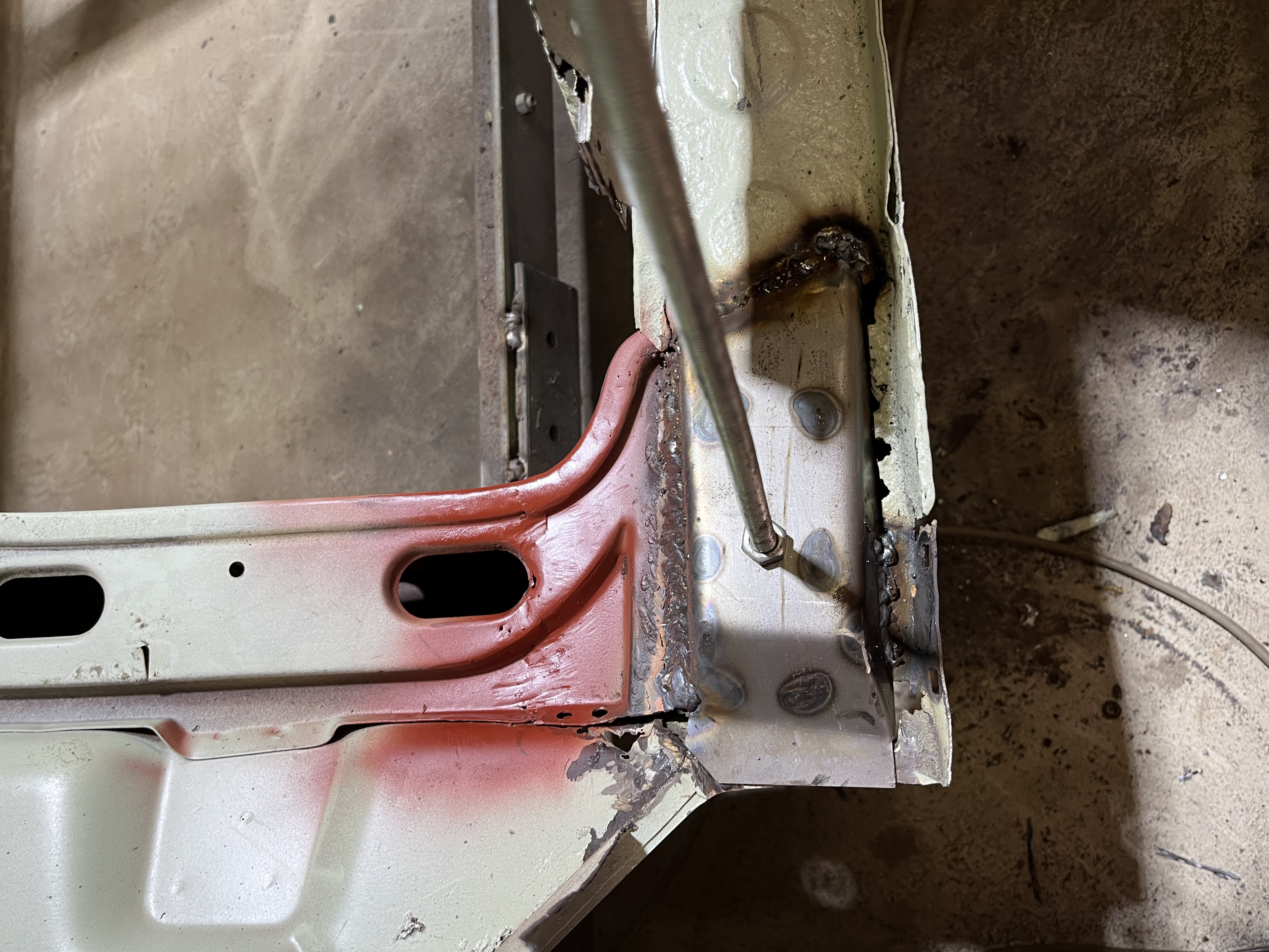

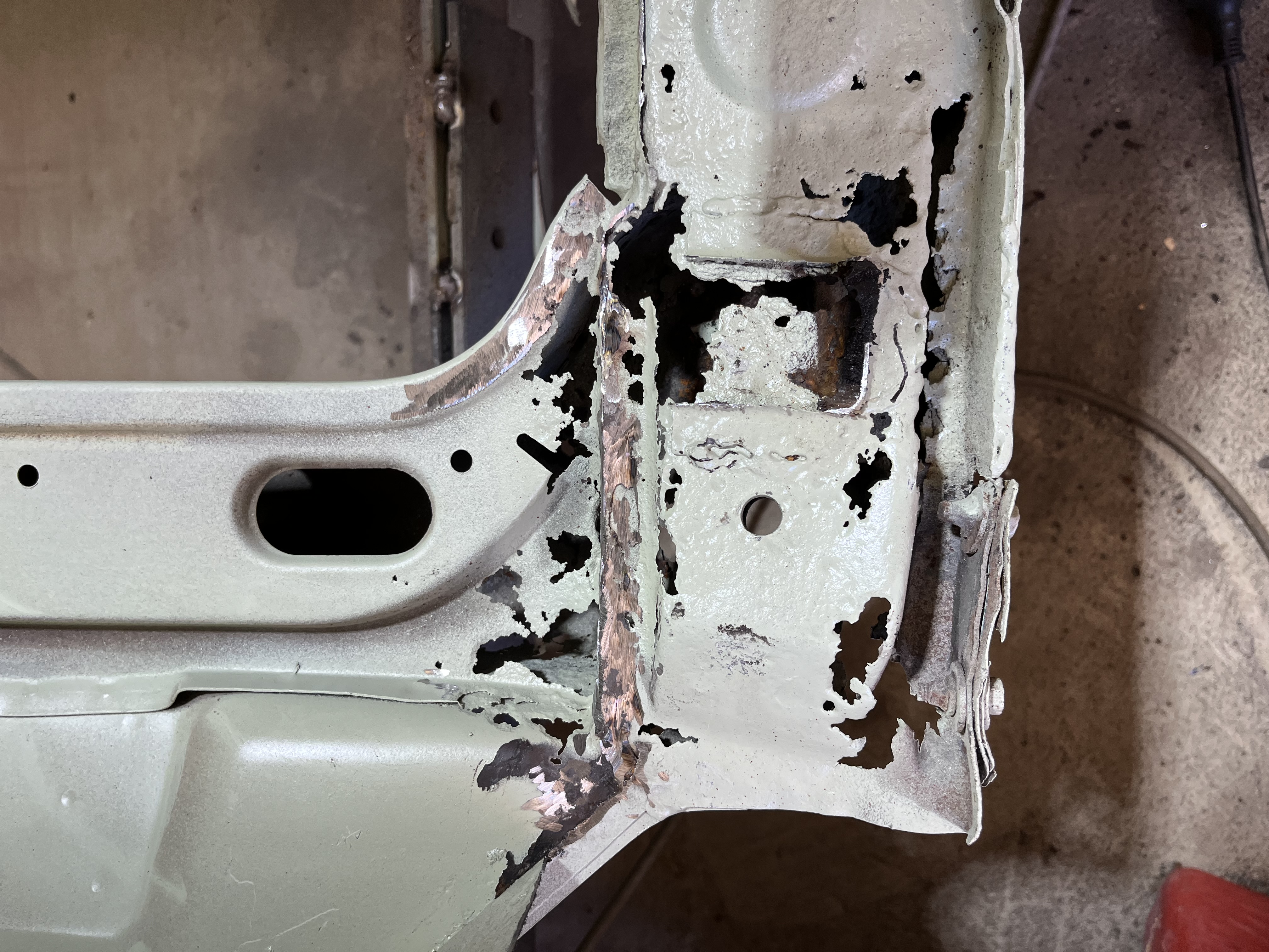

“Worked from home yesterday” still working on drivers side A pillar

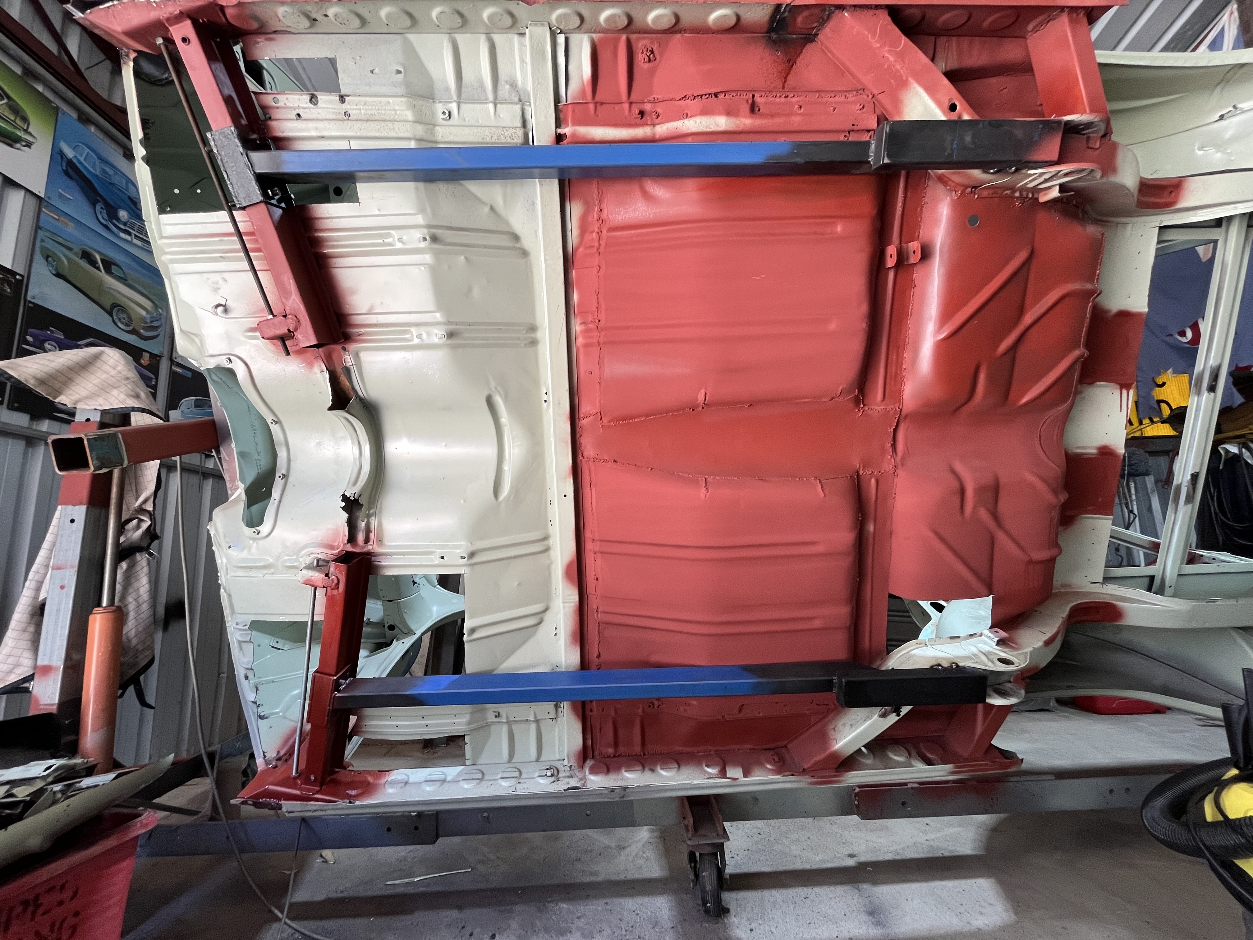

Fitted the No 1 cross member and chassis rail for strength
Rolled the rotiss down so I could get to the outer
Started surgery :lol: :lol: :lol: :lol:
Hopefully get most of it completed today, don’t know what the hell I'm doing, the passenger side was easy I think compared to this due to both the inner and outer being stuffed.
Fingers crossed.
ardiesse
Posts: 1207
Post by ardiesse »
Neil,
When you wrote, " . . . don’t know what the hell I'm doing, the passenger side was easy I think compared to this due to both the inner and outer being stuffed. Fingers crossed," you gave voice to what all of us who've done a lower A-pillar/cowl/inner and outer sill repair think. But yet it seems to work out. If in doubt, trial-fit the subframe. That's the important part.
Posts: 11675
Took me weeks to do the van ones but then I didn't have the luxury of starks replacement panels.
Posts: 2816
Rob I think a trial fit of the subchassis is on the cards I just need to repair it first :lol: :lol: :lol:
Clay if it took you a couple of weeks it would take me twice that, the repair pieces are great, not perfect, expensive but I would hate to have to try to make those sections.
Think I was a bit ambitious thinking I would get it all completed yesterday, got the inner done going to try to get the outer done today.
