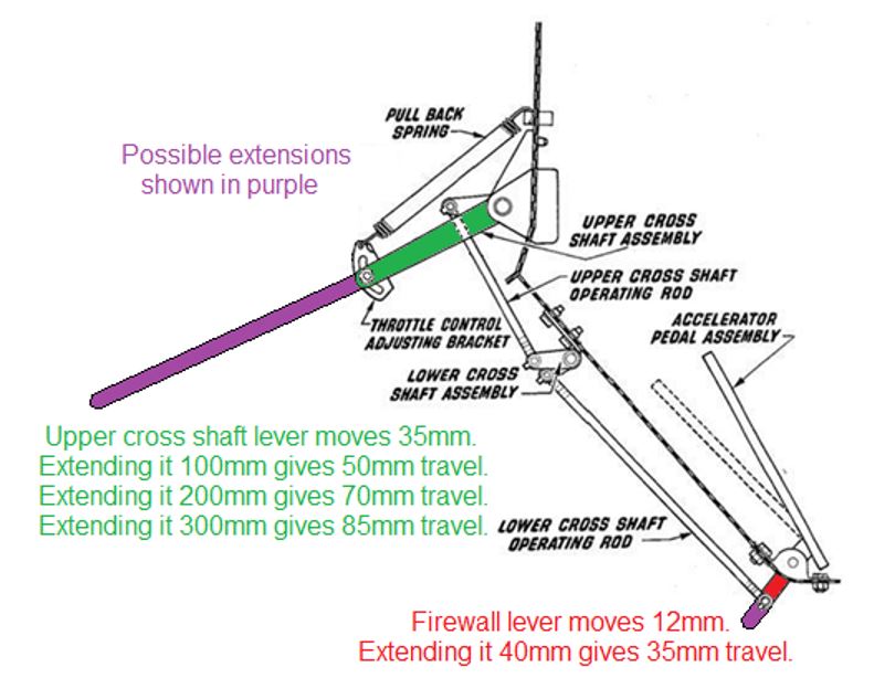

G'day Billy,
How much cable pull do you need?
To check it, have a helper hold a steel rule (or tapemeasure) near the Holley where the accelerator cable attaches. Use your fingers on the carby throttle arm to move it from idle to WOT, and see how much the cable end moves on the steel rule.
If you use the stock factory lever out of the firewall, you get 12mm cable pull.
If you extend the factory lever, you can make it about 40mm longer before you hit the subframe leg. This will give 35mm cable pull.
If you need more than 35mm cable pull, then you need to make up a lever somewhere near the manifold to multiply the pull.
Posts: 11416
Re: Accelerater Pedal
I extended mine to be 60 mm radius but should have been a bit longer. As harv says I reckon you could go to 70mm before you start fouling subframe. Makes for a more comfy pedal position at idle.
Posts: 5686
Couldn't find my sketch earlier today:
Cable pull.JPG (72.38 KiB) Viewed 10050 times
