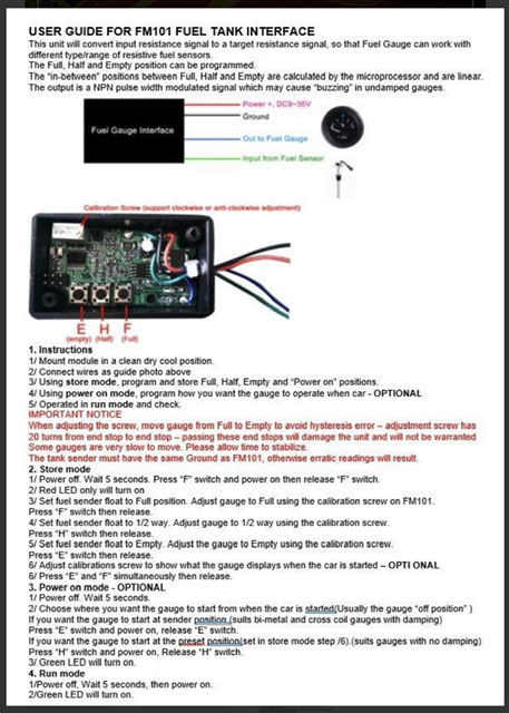

Here is a procedure I found on line for a brand I can’t remember, but I’m sure they are basically all the same
- A9D7D3AA-776E-4DF9-BBC3-258A069EEBA7.jpeg (100.01 KiB) Viewed 2189 times

Drew,
Electronics engineer speaking here: Strewth, that's a complicated set of instructions for the FM-101.
Go to your local Jaycar and buy two, fifteen-ohm, one-watt resistors.
"Full" calibration: connect the resistors in series between the green wire and ground. Adjust trimpot (adjusting screw) for "F" on the gauge. Press "F" button.
"Half" calibration: connect one resistor between the green wire and ground. Adjust trimpot for 1/2 on the gauge. Press "H" button.
"Empty" calibration: connect green wire to ground. Adjust trimpot for "E" on the gauge. Press "E" button.
Disregard the warning notice in red about damaging the trimpot - you can't damage them by turning the adjusting screw too far.
I was hoping that Jaycar sells trimpot adjuster tools (aka "twiddle-sticks" in the profession), but they don't.
