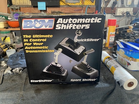

Diff all welded, ground and painted.
Waiting on one axle to be shorten by Rod Tech, hopefully by the end of next week.
I purchased a B&M Quicksilver shifter way back but I'm sure if I will use it.
Too big and ugly. .
I was keen of a Lokar shifter but at nearly a grand, too much coin for me. .
So now I'm leaning towards a T bar trimatic shifter from early commodore but these are scarce as I have found out.
Will possible combine with the top section on the centre console.
I did see this set up that looks ok but as 3 speed. .
All thoughts welcomed.

Re: Ammo's Ute
I run the Hurst Promatic 2 shifter, which is similar to the Quicksilver. In the Promatic, you can readily discard the black shifter base. The shifter guts can then be floor mounted into a more refined console, similar to the Conformadore one. Not sure if you can do the same with the Promatic, or if the black bit is structural on them.
Re: Ammo's Ute
Yeah the lokar is expensive and to the unweary, like myself doesn't have the ability to ratchet.
So that means select D and drive letting the tranny do the shifting.
Its all show and no go !!
I used to have a quick silver shifter back in the day and that was good for fast shifting between gears.
Thats all the info I have.
Re: Ammo's Ute
have a look at B&M unimatic i also like B&M pro ratchet
