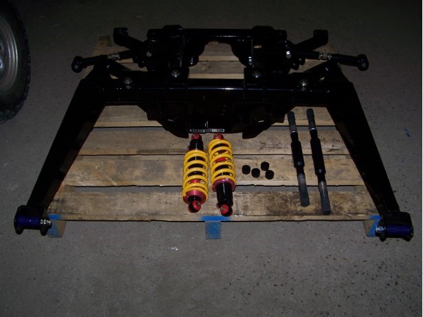

I have been toying with doing an upgrade on Frank or maybe installing on the wagon when I get to it.
Purchased a tear independent suspension cradle from V6 Conversions and a VE V6 2.92 complete rear suspension setup to go into the cradle.
It bolts into the existing spring hanger mounts.
Haven't received the cradle yet so if it interferes with to much already under Frank I will install it on the wagon.
Independent Rear.jpg (59.8 KiB) Viewed 2189 times
Independent Rear End with Diff fitted.jpg (49.14 KiB) Viewed 2189 times

That looks sexy , what is the width of it wheel face to wheel face ???

Hey guys, yes I'm hoping that it goes in fairly easy, Pat at V6 Conversions says you have to cut a bit out above it allow for the upper arms and as you asked Blacky concern is wheel track, he tells me it should be the same as I have now the concern is that he says SHOULD :lol: :lol: :lol:
My VE suspension arrived yesterday from a mob in SA Clay :roll: I will measure face to face on the new suspension and just see how wide it is.
Will post up the findings and hope it is going to work, at $4400 + freight this better work and it is the most I think I've ever outlaid, I would like his independent front end as well which allows me to use the original sump but at $5100 I'll have to save up and probably sell some of my stash or parts to keep the boss happy :lol: :lol: :lol:
Posts: 2751
Re: Neils Frankenstein Ute
Just Googled rear wheel track for VE and it comes up with 1608 - 1618mm so this is a fair bit wider than what Frank is which is roughly 1400mm from memory so I think I better ask some questions :crazy: :roll: :roll:

Thanks for all the comments guys I've put the deposit down and purchased the donor rear so will just go with it and see where it ends up.
The engineers report that comes with the cradle says max 1400mm wheel track if that is the case then I should be all good.
Looking back a bit closer at the photos that were sent I can see that the upper control arms come in a lot closer than the VE rear and they send shortened other arms that look like they bring it all in my only concern is the axles but I will talk to them about it.
You can see how much if you compare the photos.
V6 Conversion Rear end
Independent Rear End with Diff fitted.jpg (49.14 KiB) Viewed 2057 times
VE Rear End
Scored cross drilled rotors :lol:
Spoke to my engineer he seems to think it will be ok, if I fit it to Frank then I would have to submit and application to amend the approval that I already have if I fit it to the wagon project then I will submit it as part of the build application.
The engineer told me that I probably should have submitted an application for the VT twin piston caliper upgrade I did to the front as well :roll: :roll:

Looking good mate. Looks like the rodtech arms are similar length but pivot points have been brought in toward the centre?
Posts: 2751
That's what I'm seeing too Clay
I'vwe spoken to V6 Conversions on a couple of occasions now, 1 I wanted them to send me the fitting instructions so I could prep what I need to do and 2 I asked about axles but on both occasions I don't really get much back which in all the time I've dealt with them is pretty normal :roll:
