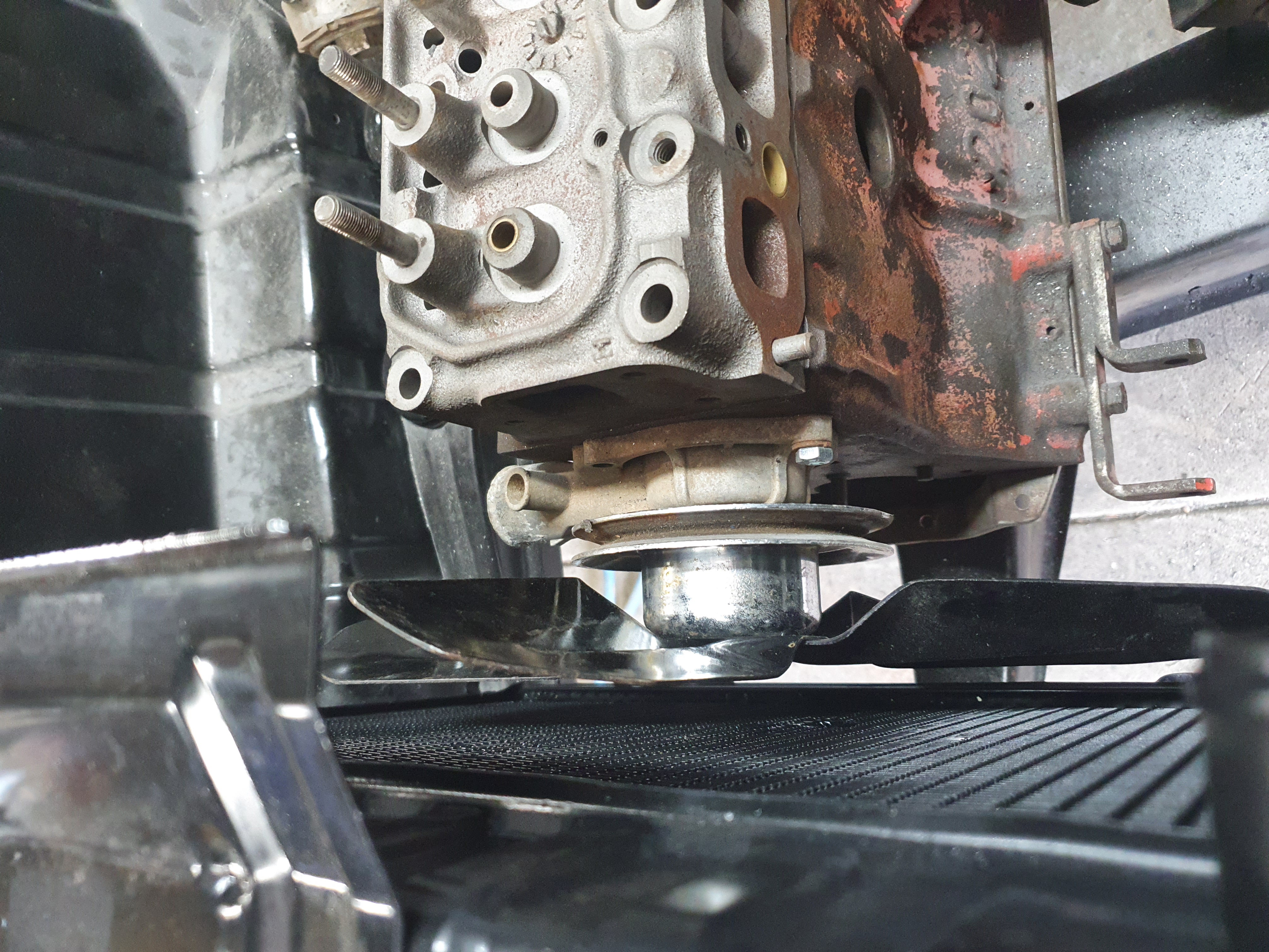

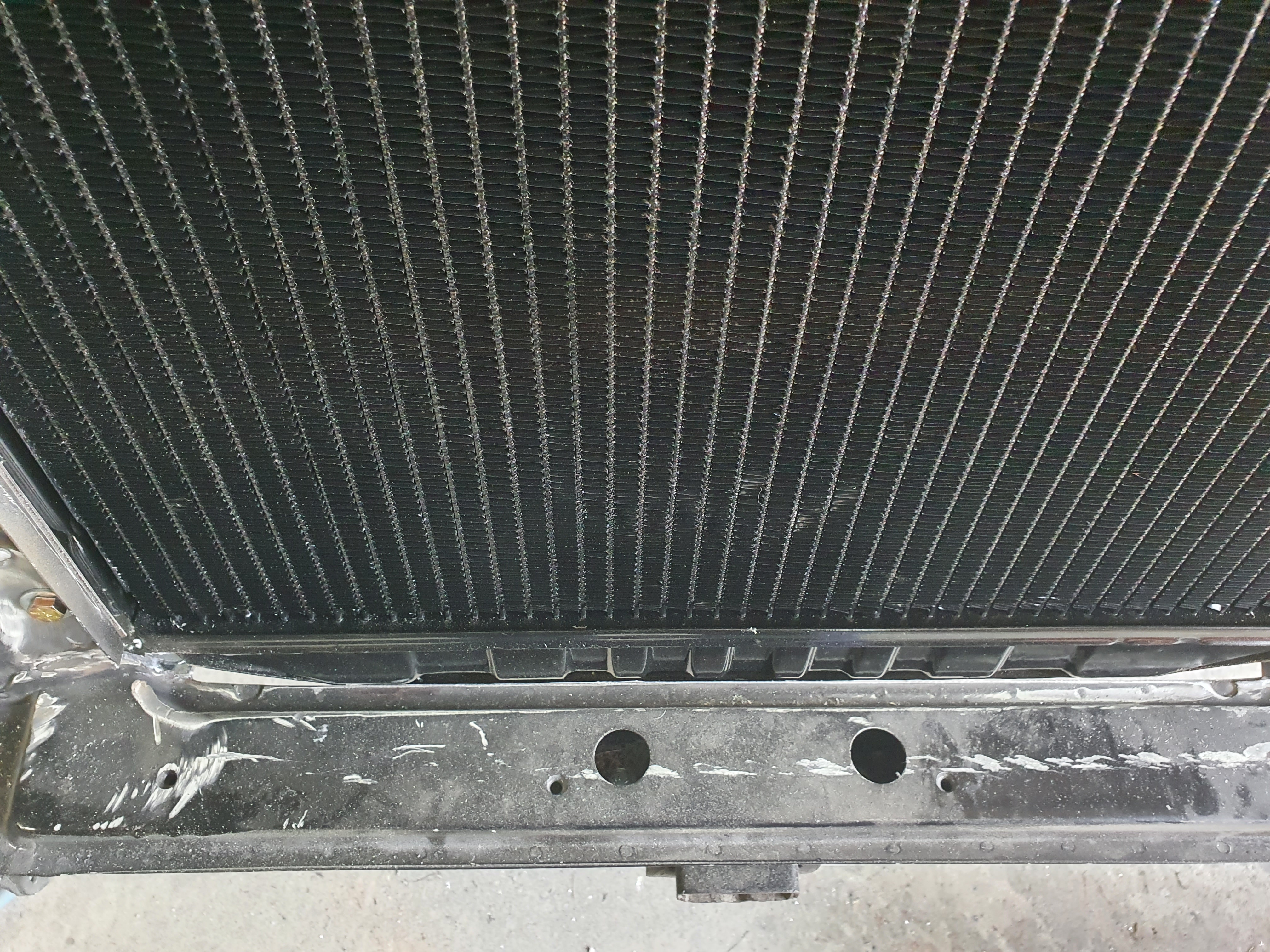

A bit more work on radiator housing mods. Cut up the surround sections previously removed and re- welded the right angle braces on the front for extra support. The changes yesterday to the bottom section of the kframe have given me an additional 13mm which is plenty of room.
Now just have to finish reshaping the guard brace to allow a neat fit of the header tank.
All up, pretty happy with this.

Very tidy, in fact so tidy I can’t see how you have moved it forward apart from the bottom tie iron clearencing. Unless you have moved the radiator side tabs rearward.

It's all about cutting the sides out. The original radiator side panels angled in, so cutting 45mm off each side to fit the wider radiator brings everything out a fair bit. Then I sliced through the panels each side at the bottom and re-welded it so that the bottom moved forward about 10mm. That straightened the vertical mount. Slicing off 12mm along the kframe bottom (which took out the bit with the semi circle for the pulley tool) and removing the indented pieces where the side panels join the kframe and welding up again allowed the bottom tank to move in 10mm. And finally, cutting out 10mm from the top crossbar to fit the header tank in- thats the bit I'm playing with now. It's magic😀
