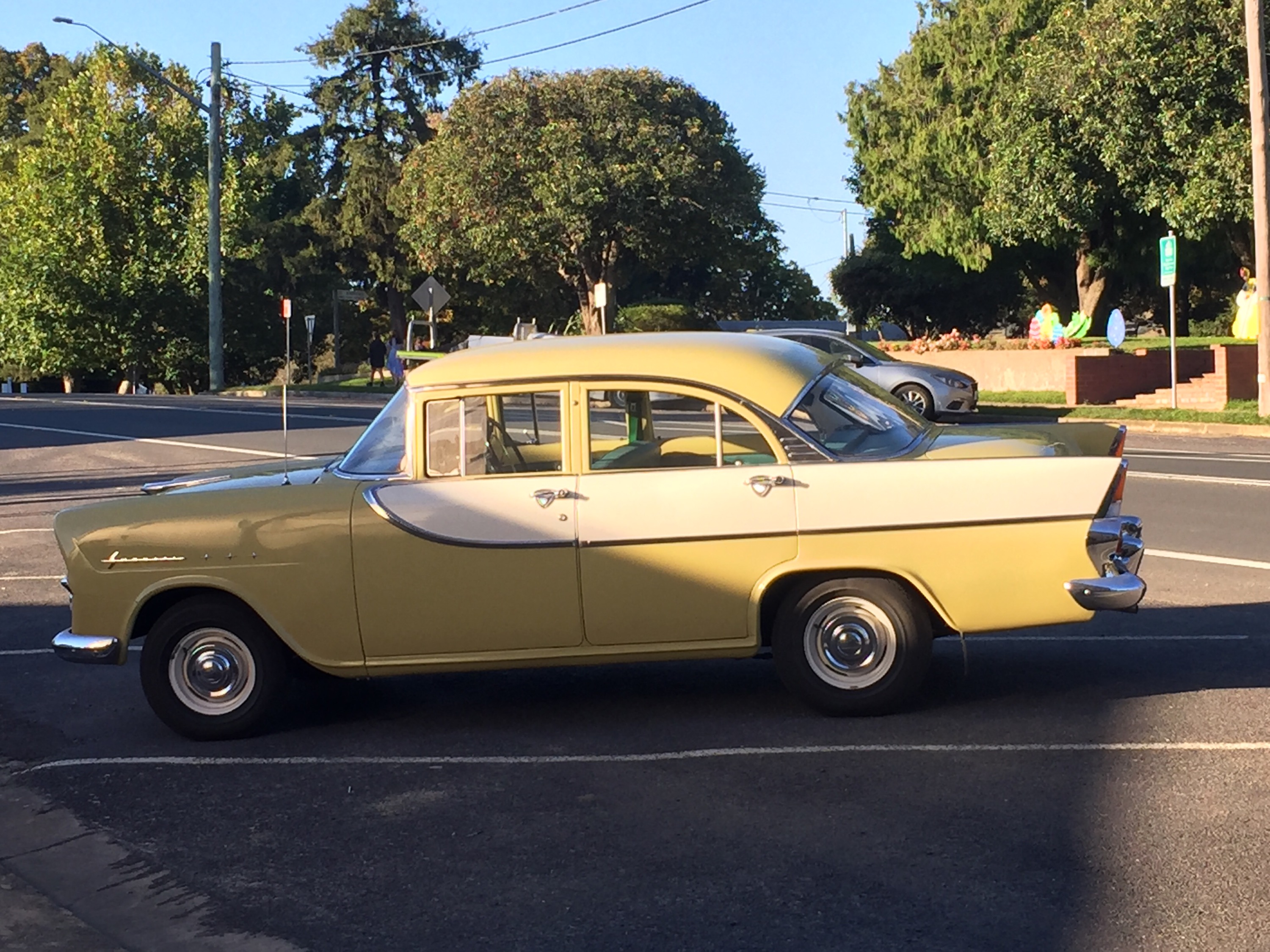

Took poor old neglected Wilma for a cruise to Braidwood and back on Sunday afternoon. Kate and no.2 pooch came along for the ride and we went with our '52 Chev friends. Ran out of petrol on way back
. I may live this down one day, but not in the forseable future.
A bit of an absence and reaquainting myself with her has produced a list of improvements to be undertaken before putting her on the market. These are:
-Replace original fuel sender.
-Replace steering column shaft with Rares reconditioned one set asside for Project 2. Steering is just too loose in the straight ahead position to inflict it on potential buyer.
- Swap rear door scratch plates with Project2 so that all 4 on Wilma match.
- Swap rear bumper overiders over from EK to FB.
- Fix passenger side door lock so that it raises button.
- Install brake booster previously purchased but not installed.
- Fix heater water tap cable.
- Tidy up 2 paint chips that occured when windscreens were installed.
-Finish buffing paint and polish.
Other than that I am very pleased with her. Motor is freeing up and is very responsive for a standard grey. No whines or other mechanical issues. Kate was very keen on Wilma's front bench seat and is happy that I am temporarily ditching the bucket seats in Project 2 in favour of a bench.
Photo of Wilma in afternoon light gracing the historic main street of Braidwood.
- IMG_7578.jpg (1.22 MiB) Viewed 3097 times

Looks to me like she is ready for a drive to Nuriootpa…….
Re: Wilma FB project
Bench seat very romantic. Look out Brett... 8 ) 8 )
Yes, and I remember you pointed that out some time ago Clay. Presumably learned from rich life experiences
