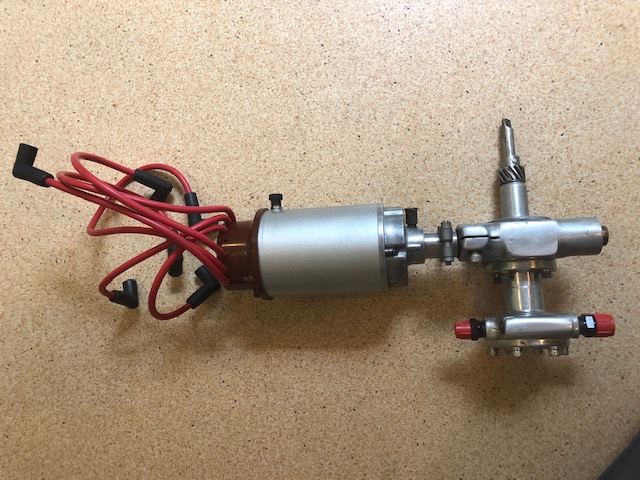

The Repco inlet manifolds are really close to the dizzy mounting hole, so I have to turn the dizzy sideways in order to get the magneto to fit. I've got a McGee angle drive that will do that, though I need to be wary that a lot of weight is then cantilevered off the angle drive. My angle drive (and many like it) had cracked, and I had to have it rewelded. I'll need to make a brace for the magneto back to the sideplate to stop the magneto pendulum cracking the angle drive. Plan at this stage is to use modify a Vertex dizzy timing clamp to do so... should be fairly simple.
The McGee angle drive lets me run a mechanical fuel pump where the dizzy would normally live. Methinks those Repco inlet manifolds are too close to run a Hilborn pump, but the stubby little McGee pump shown above should fit. I rebuilt and had the McGee pump flow tested a few years back, and it failed... still need to sort out the clearances in the McGee pump, so will have to make my own scaled-down flow test rig (flow some kero in/out of a bucket, drive the pump with the drill press, increase the back pressure with some form of needle valve, measure pressure with a gauge, time the flowrate by stopwatch).
