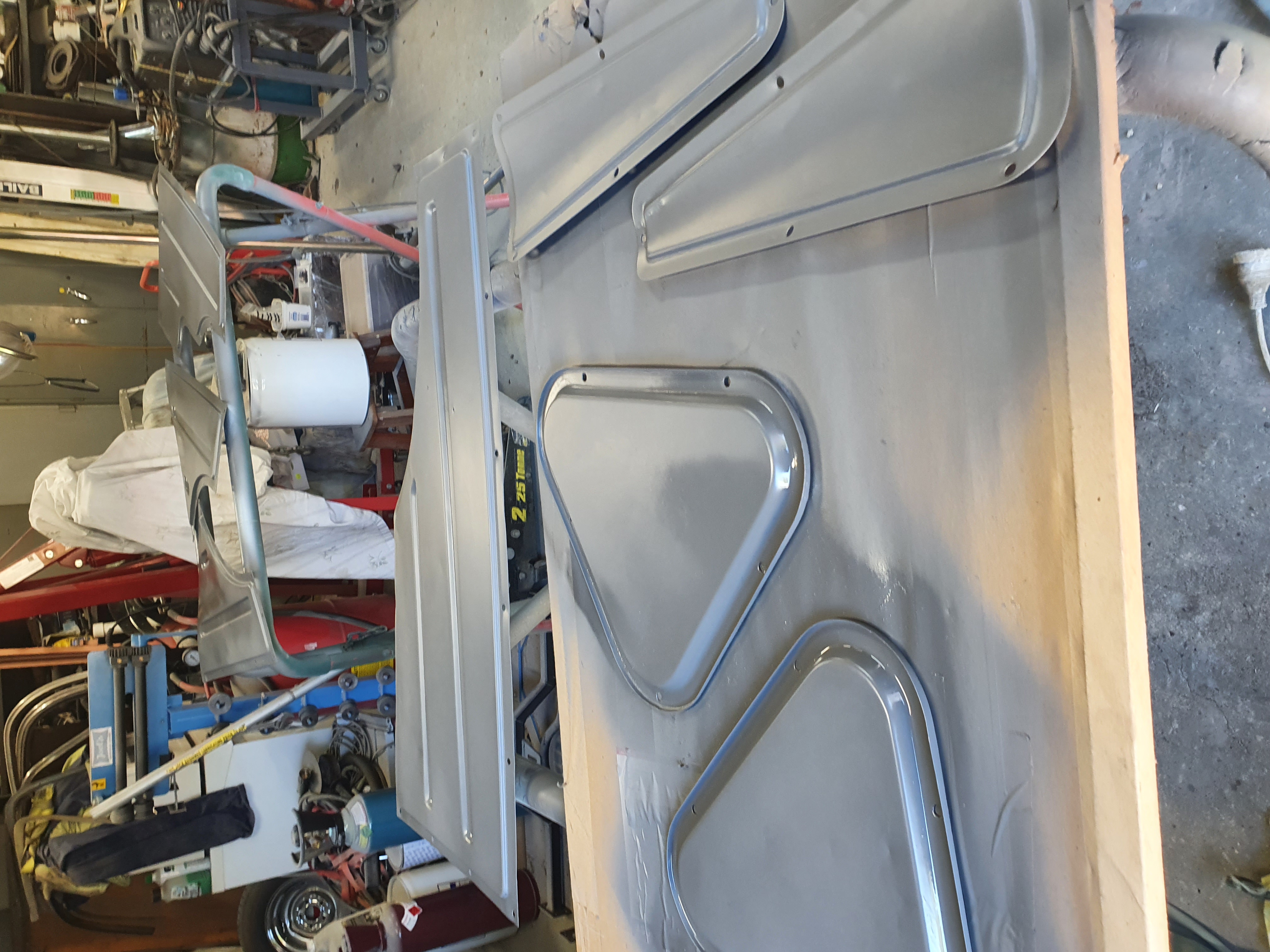

Happy days. Lots of prep work to get these pieces ready for paint. Etch primer this morning on one side, other side this arvo.
Posts: 11619
Re: Project 2.
Departed from the epotec?
Posts: 2518
Re: Project 2.
Yes. Some of these bits have been primed previously with what I assume is acrylic. So just to be safe am using acrylic etch and then usual primer and top coats.

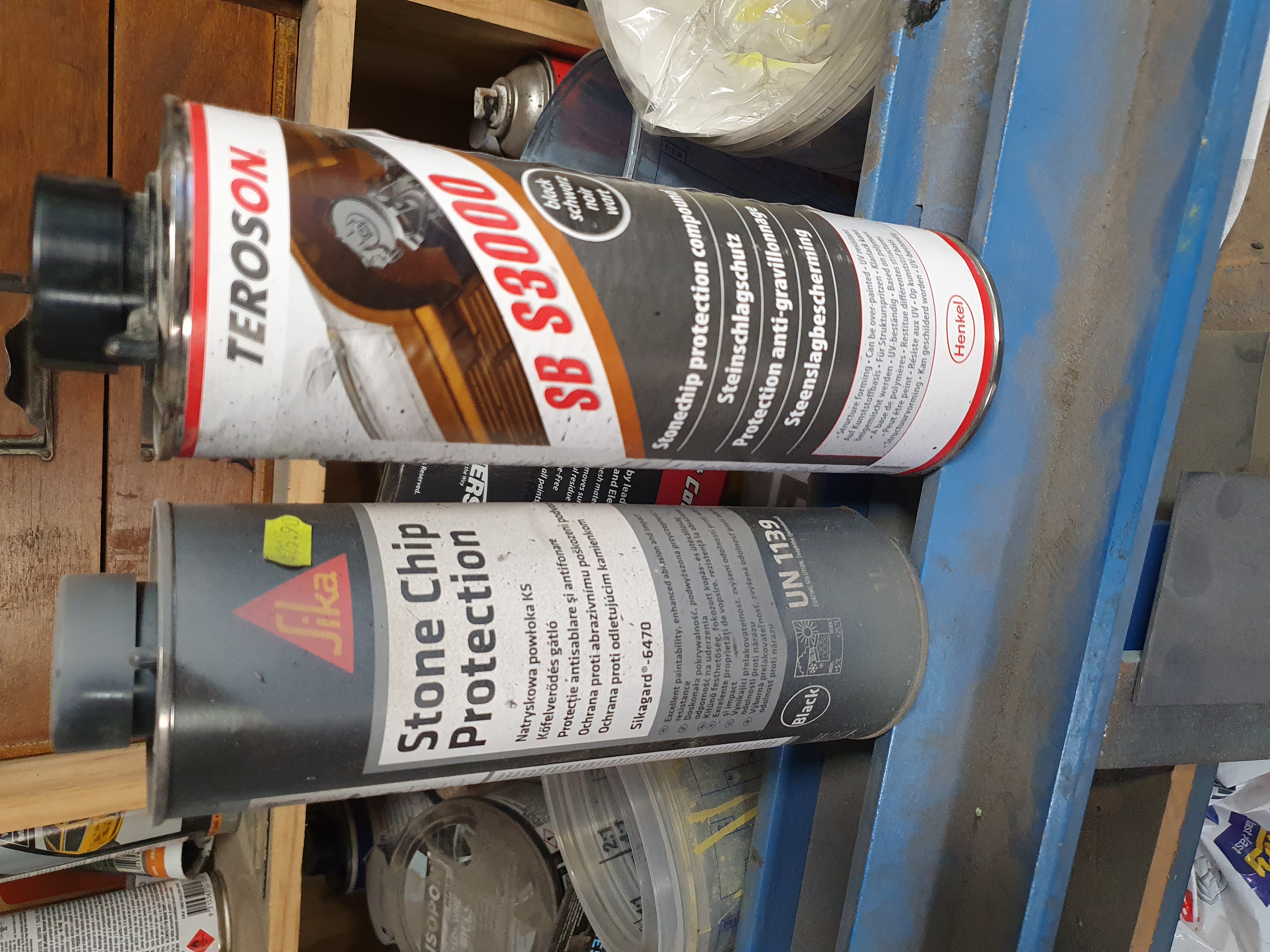

Sprayed a bit of stone chip goop on this morning. Photo of 2 types I've used. Prefer the Sika as it dries off a bit quicker.
