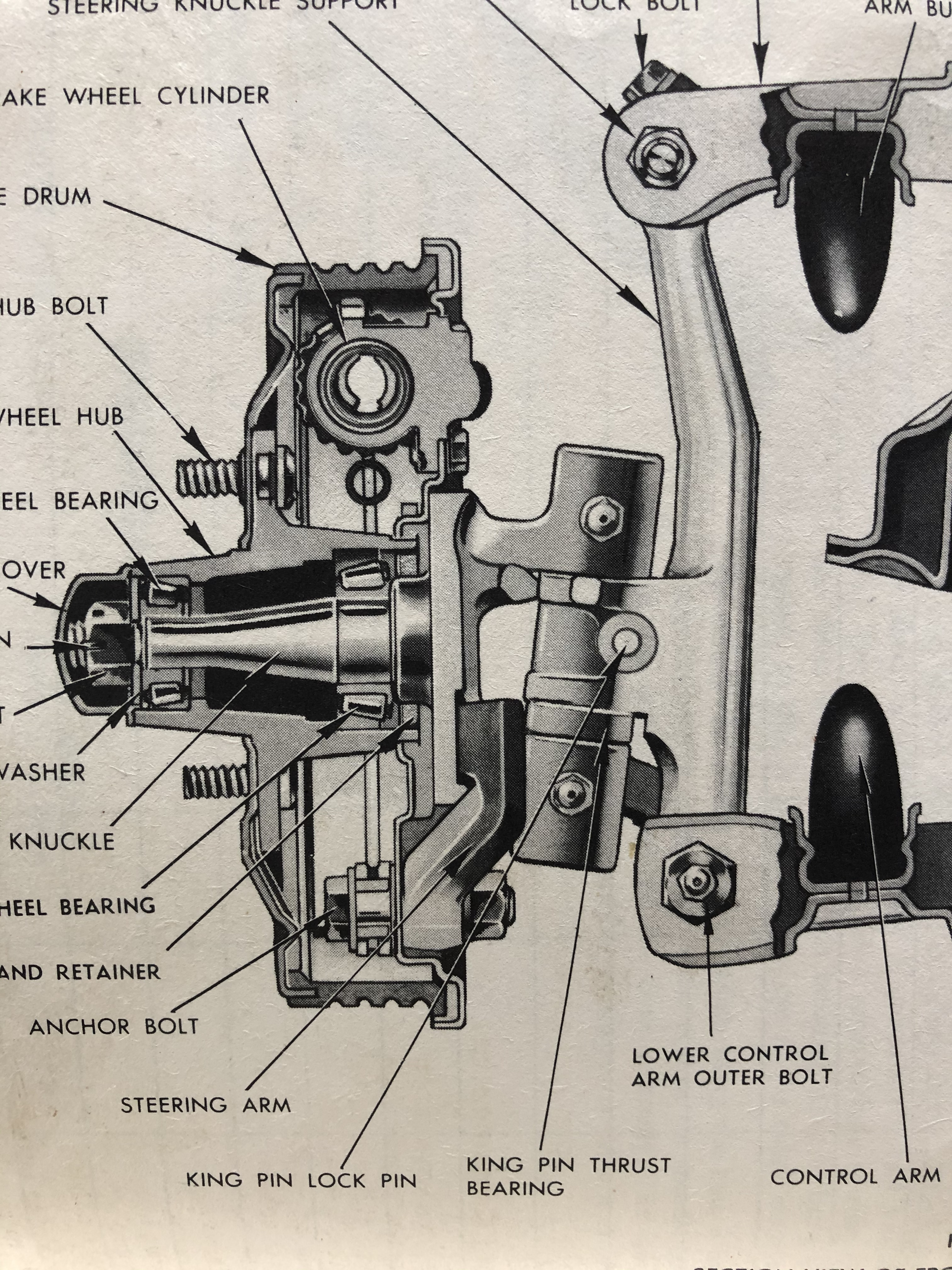

It's amazing what transpires overtime and gets lost in conversation. I hope no one is running these drums with standard rims. The original drums were dished as was the rim. Think about it. The stud mounting face on EJ EH drums is flush with the outer rim of the drum. THIS FOULS on standard FB EK rims. It may not be noticeable as the wheel will still bolt up, BUT the rim doesn't sit flush with the drum and has to be distorted by tightening of the wheel nuts to get the rim to seat against the drum. As a mechanic this stuff scares the crap out me seeing disinformation being taken as gospel.

eBay ad says they suit EJ EH Craig, which ran the same wheels as FE -EK. Not that I would put much stock in what an eBay seller says, but I reckon the problem comes when the wider brakes and drums are used with early wheels. You can see that the hubcaps sit out further from the wheel on the HD HR rims for this reason, which doesn’t look quite right on an FB, the reason I rejected them for my ute. Torana are another story again, as the drum outer dits well inboard of the mounting face.

Sorry but its to do with the rim offset on HD HR that causes the hub cap to stick out not drum width. Not all the rims were the same across FE -EH.

I would like to reiterate my post of 12 months ago. I have now been running EH drums on my FB with standard wheels for two years, regularly, and nothing has happened! As for the "dish" in the wheels etc all I can say is that before I fitted the drums I put little dobs of plasticene all over the drum face and sat it inside the wheel. Without tightening it up the wheel and drum made contact in all the right places with no distortion. I did check also with the manufacturers and discussed with guru Ken McLean and they were OK with it.I would have thought that if there was a problem with drum/wheel mismatch it would have shown up by now. Cheers, Fraze

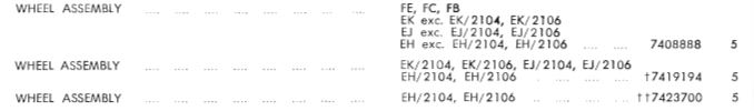

My understanding is that the wheel offset (steel rims) are identical offset FE-EH. The wheel assembly (wheel and tyre) differs in the commercials (rivets, 6-ply tyres on the commercials). The workshop manual lists the same track (54.5") for all models, with identical diff width (1396mm).
HR changed, with a track increase to 54.9" on non-commercials. This was achieved by widening the diff (by 0.4" to 1406mm), with the same wheel offset. The commercials retained the same 54.5" track... same HR diff as the non-commercials, but different offset wheels to non-commercials.

Dr Terry wrote: Fri Aug 10, 2018 7:35 am Hi Guys.
AFAIK all FE to HR rear axle assemblies are around the same length (width).
HR's wider track was due to a change in offset of the wheel rims & this was for sedans & wagons only. HR utes & vans got HD rims with the reduced track dimension.
The rims with the reduced offset (wider track) are easily identified by the small 1/8" hole in one of the ridges between the wheel nut holes.

Dr Terry wrote: Sat Feb 16, 2008 5:55 pm Hi Guys.
All factory FE to EH wheels will interchange, the only difference is the larger valve hole in FE & early FC rims.
FE to EH will not fit over HD/HR drums.

I just went out and checked some original wheels and drums.. the wheel's mounting surface is basically a flat surface with indents - the drums have some protrusions which fit into those indents
So putting a standard wheel onto a flat surface (like the drums discussed) doesn't appear to be a problem
(only problem I could see was if you tried to put a flat wheel without indents (if they exist) onto an original drum it would sit on the protrusions)
