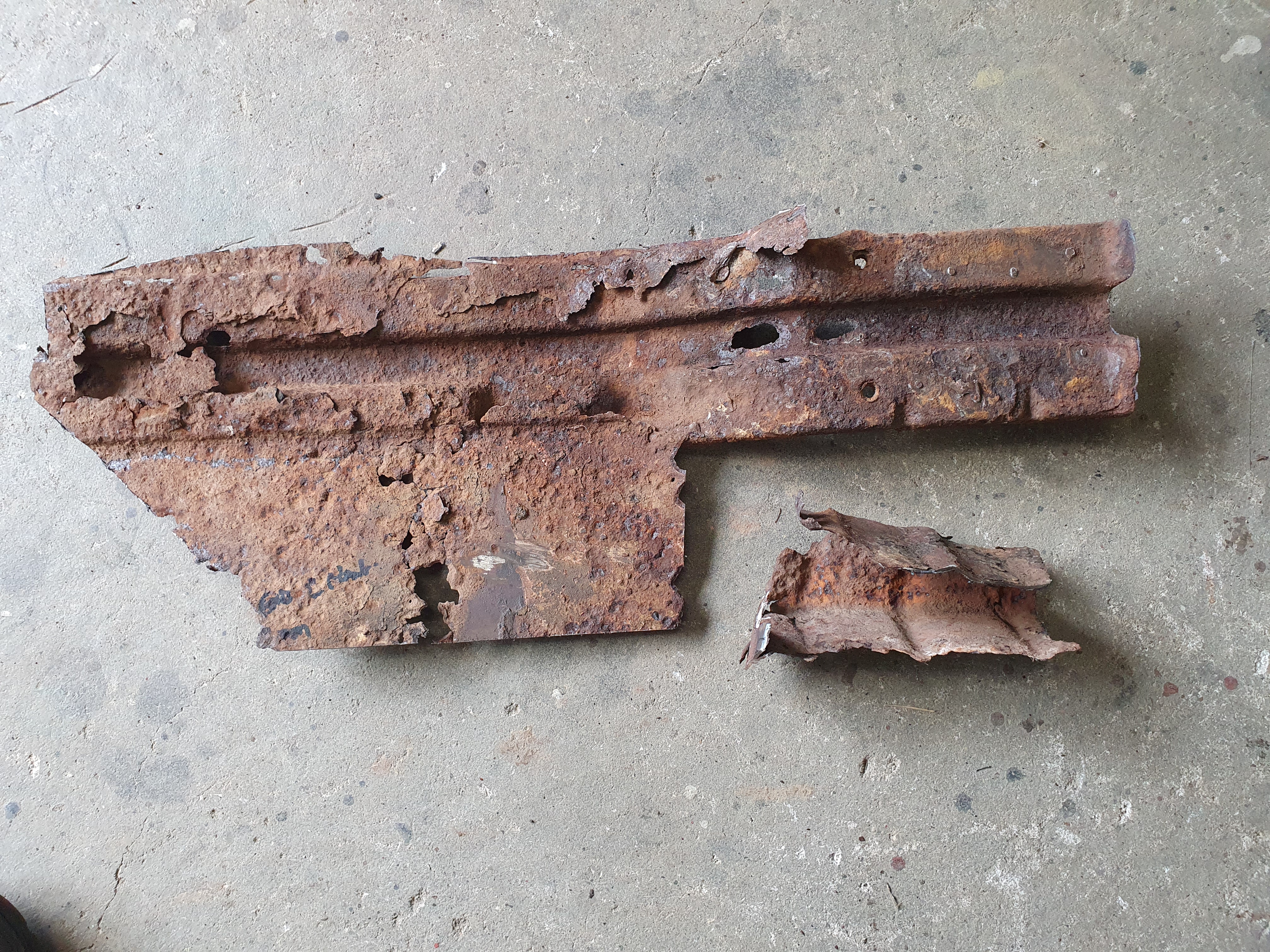

Just in case you are thinking I've gone to sleep on the job. Chasing rust along the floor. Working around the drivers rear wheel well and sill area.

Good work Brett
Appreciate the sill pics.
You would be on a weekly tetanus booster with the amount of rust you have got there!!
