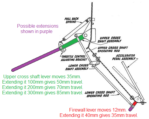

I've got a HZ pedal/cable in the wagon. It works, but is not overly exciting. Mounted easy though. Some more options below.
Pedal extensions.png (75.65 KiB) Viewed 836 times
