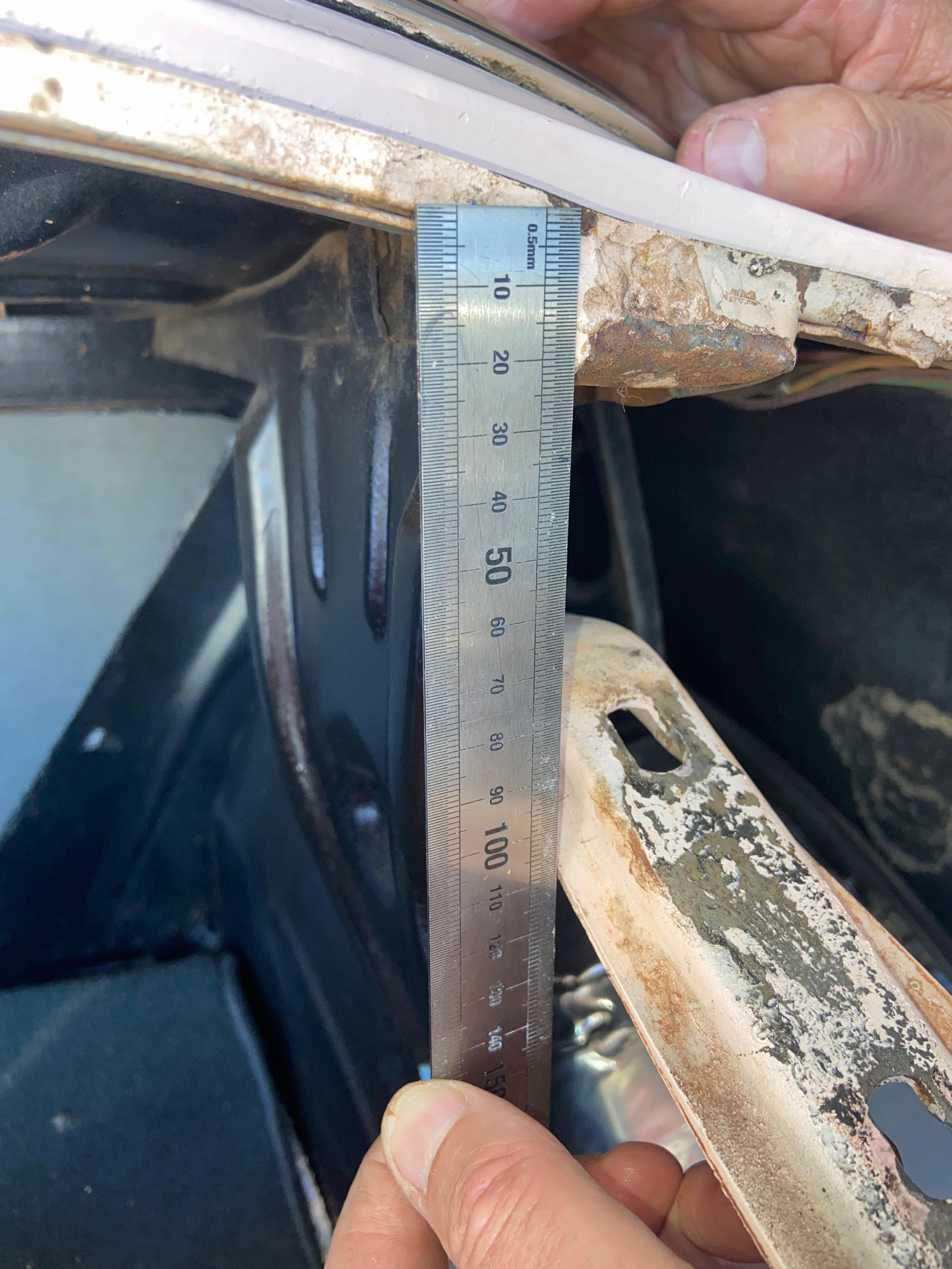

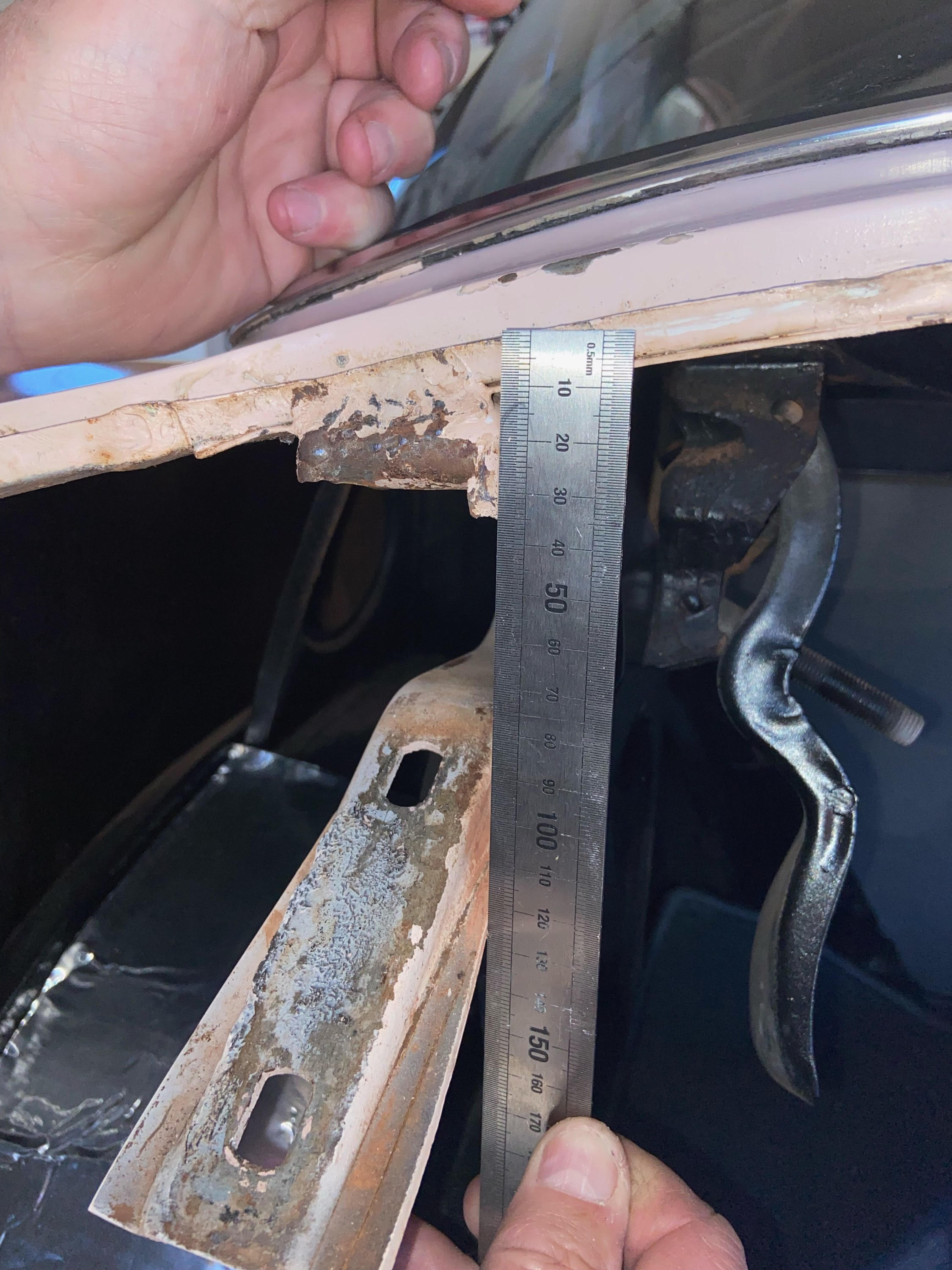

Hi ,
Looking for some guidance re boot hinge stops. The boot in the open position is finishing with the lower edge very close to back window. The bolt holding bolts were right to the end of the mounting slots on the hinges, so no adjustment there. After removing the boot it is obvious that the two metal bits on the end of the parcel shelf are slightly different and appear to be a home remedy from a previous owner. Question ; 1 ) Is there supposed to be a rubber strip / stopper between the hinge and the stopper? 2) Anyone got a pic of what this originally should look like?

I've saved you the trouble Blacky as I have a pair I removed from my donor FB sedan a few years ago.
First photo isn't thst relevant as it shows the position with boot lid removed from car and hinge down.
Second photo shows the lid fully open position. Hope this helps.

You can see it is a vertical face, no stopper.

Great that explains it ... this one has been mashed under .
Errol are you able to get me a couple of measurements ?... see your pic edited .
Distance between blue dots horizontal
Distance between white dots ... vertical
Much appreciated
Much appreciated
- Boot hinge stopper detail .jpg (1.64 MiB) Viewed 979 times
Re: Boot Lid stops
12mm 69mm

Thanks Errol ,looks like the original tab is still there ...
just needs some persuasion to get back into shape .

Thanks for that Clay ,
Was the end of the parcel shelf bracket ( top blue dot in the photo ) originally welded to the under edge of the boot seal gutter? .
Or did it just sit underneath ?
The brackets on this one are welded to the gutter , which I assume was a later fix up ....?

Sorry i can't remember although I think it may have been. I took it off a while ago and it has been sitting out in the weather since. I will try and remember to look at the 'couch cut' in the morning.
