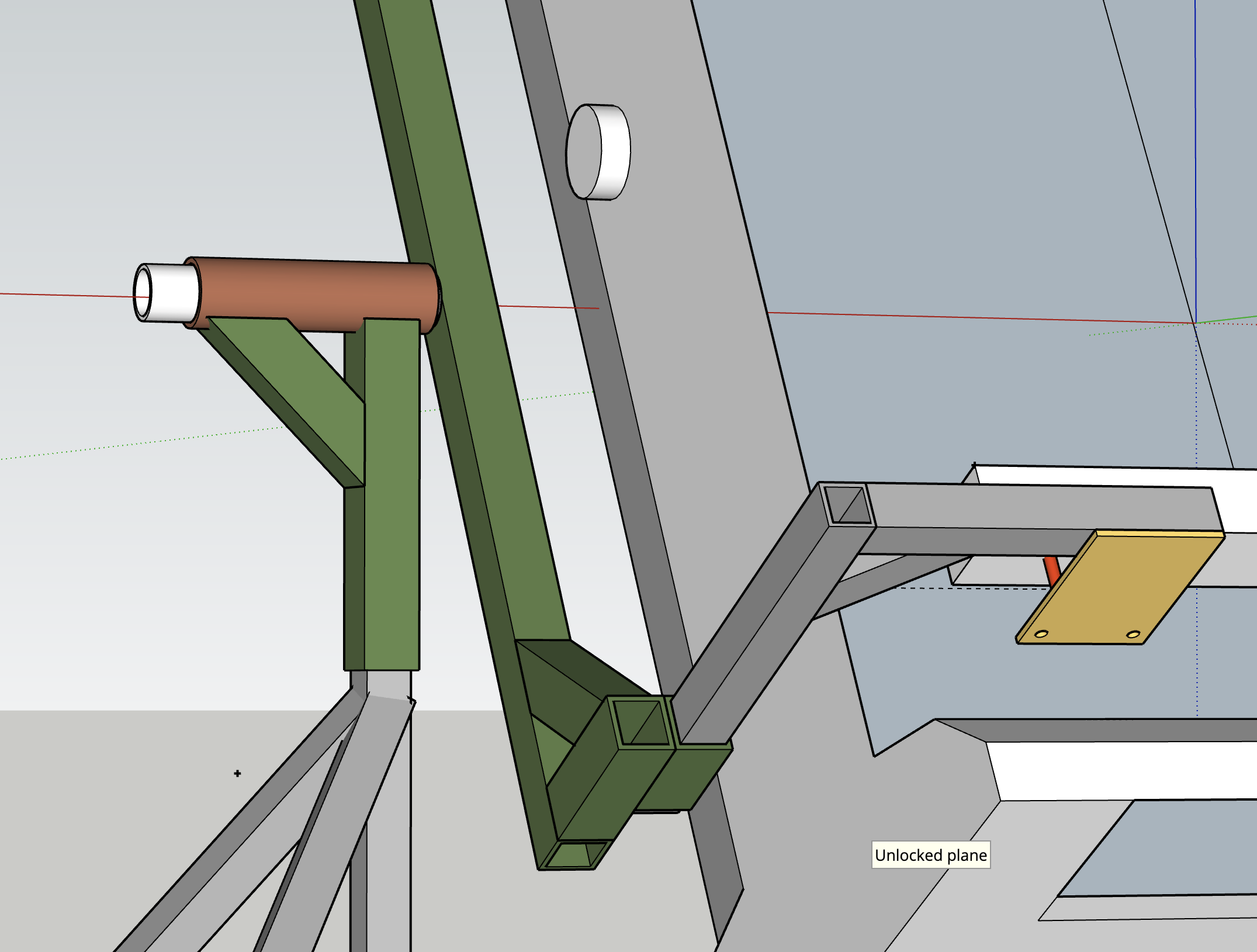

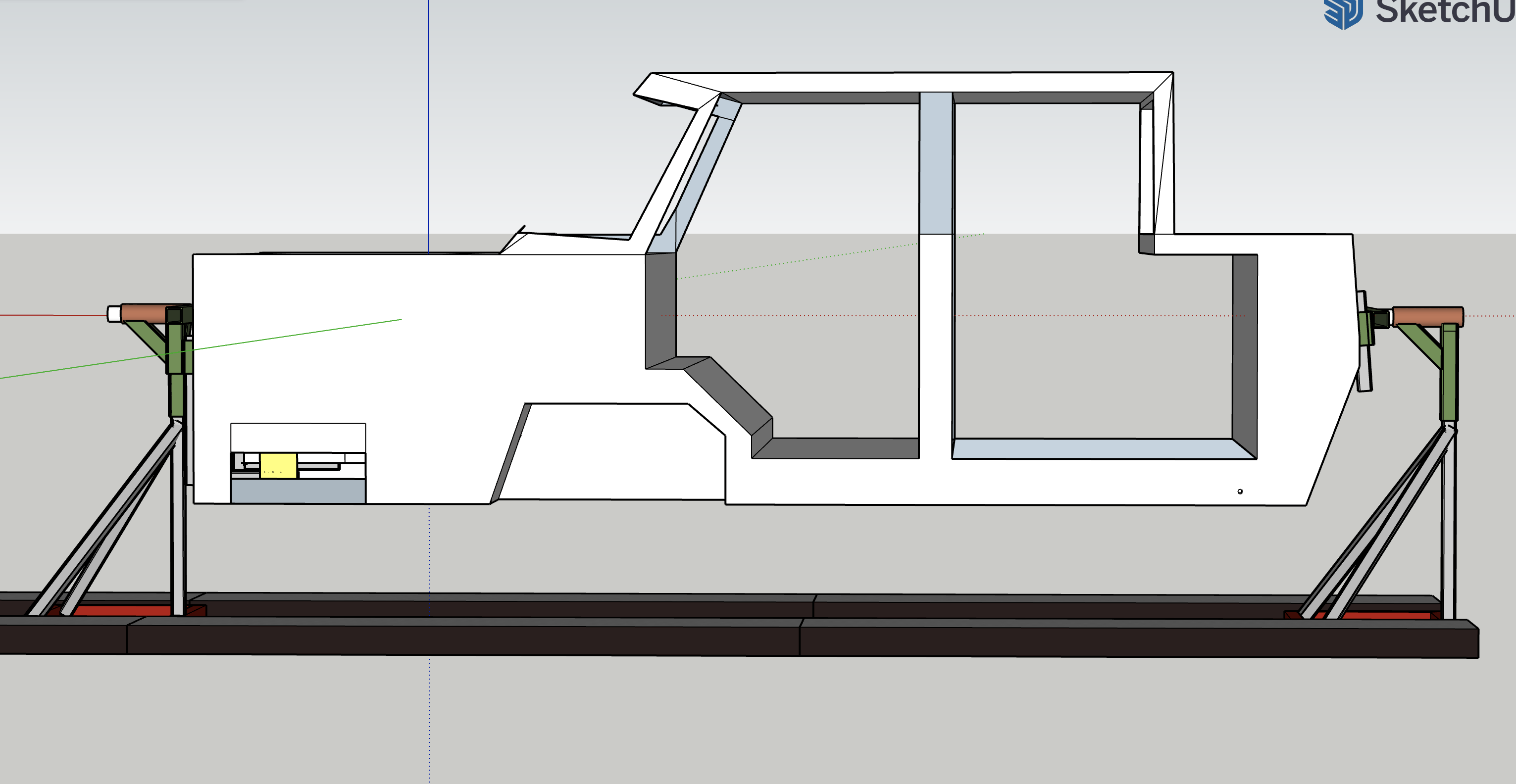

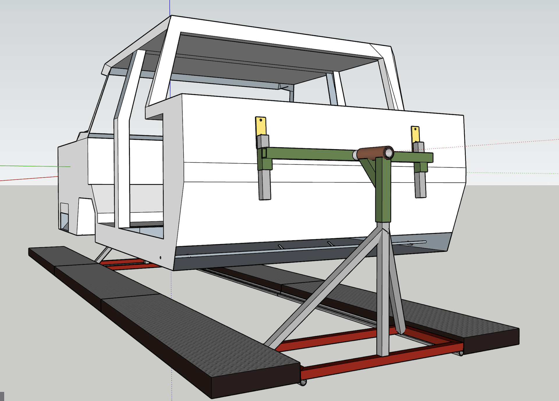

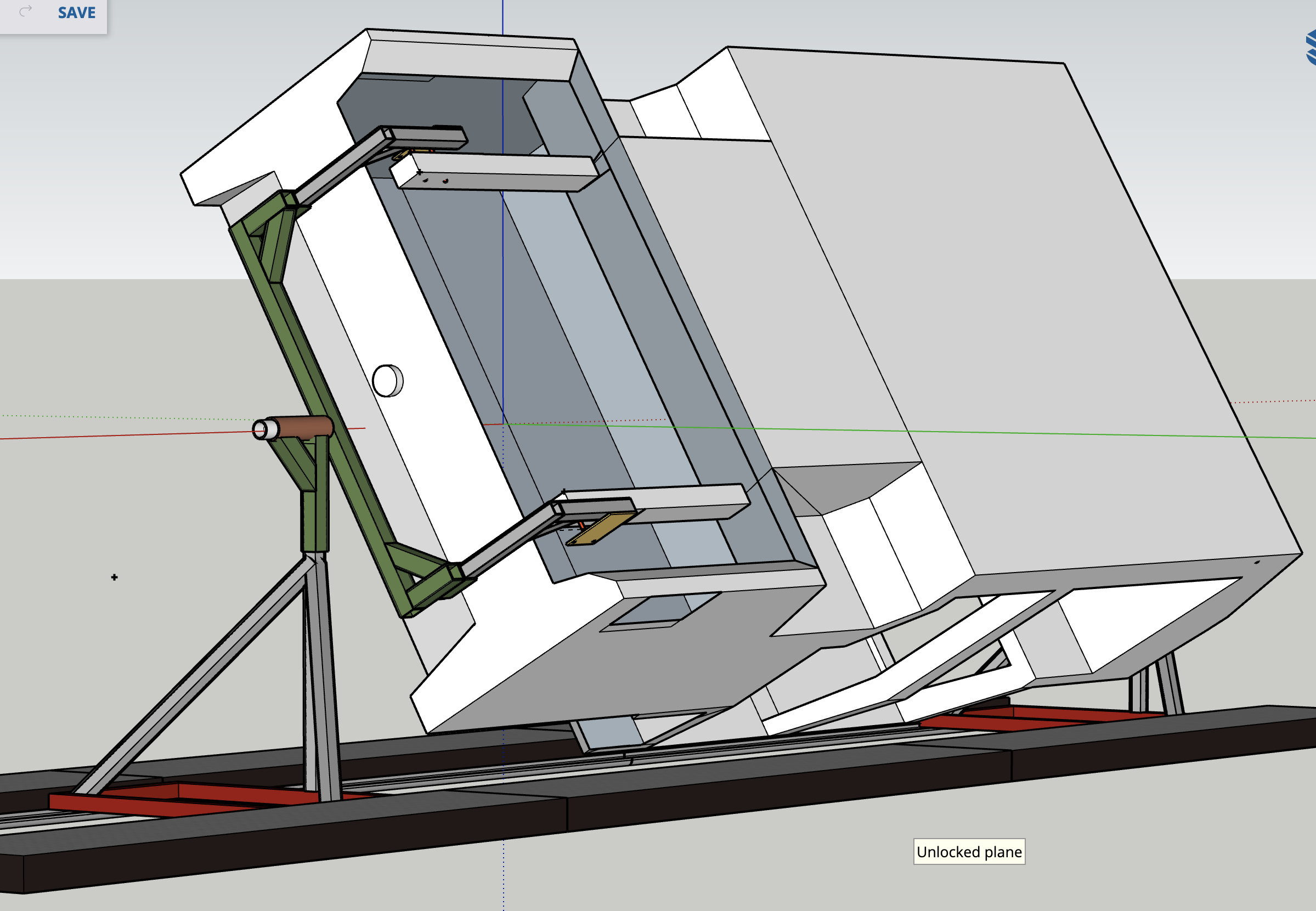

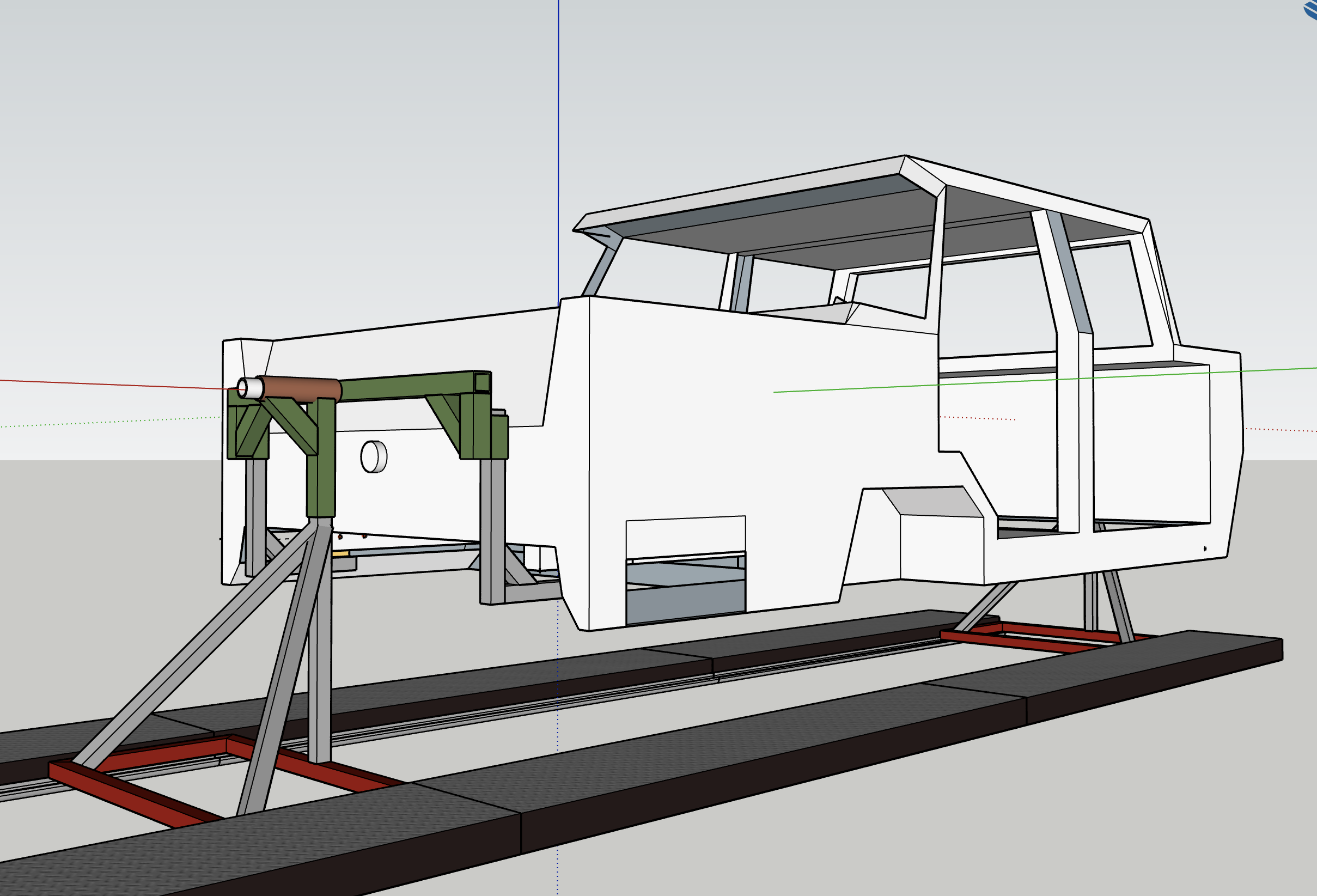

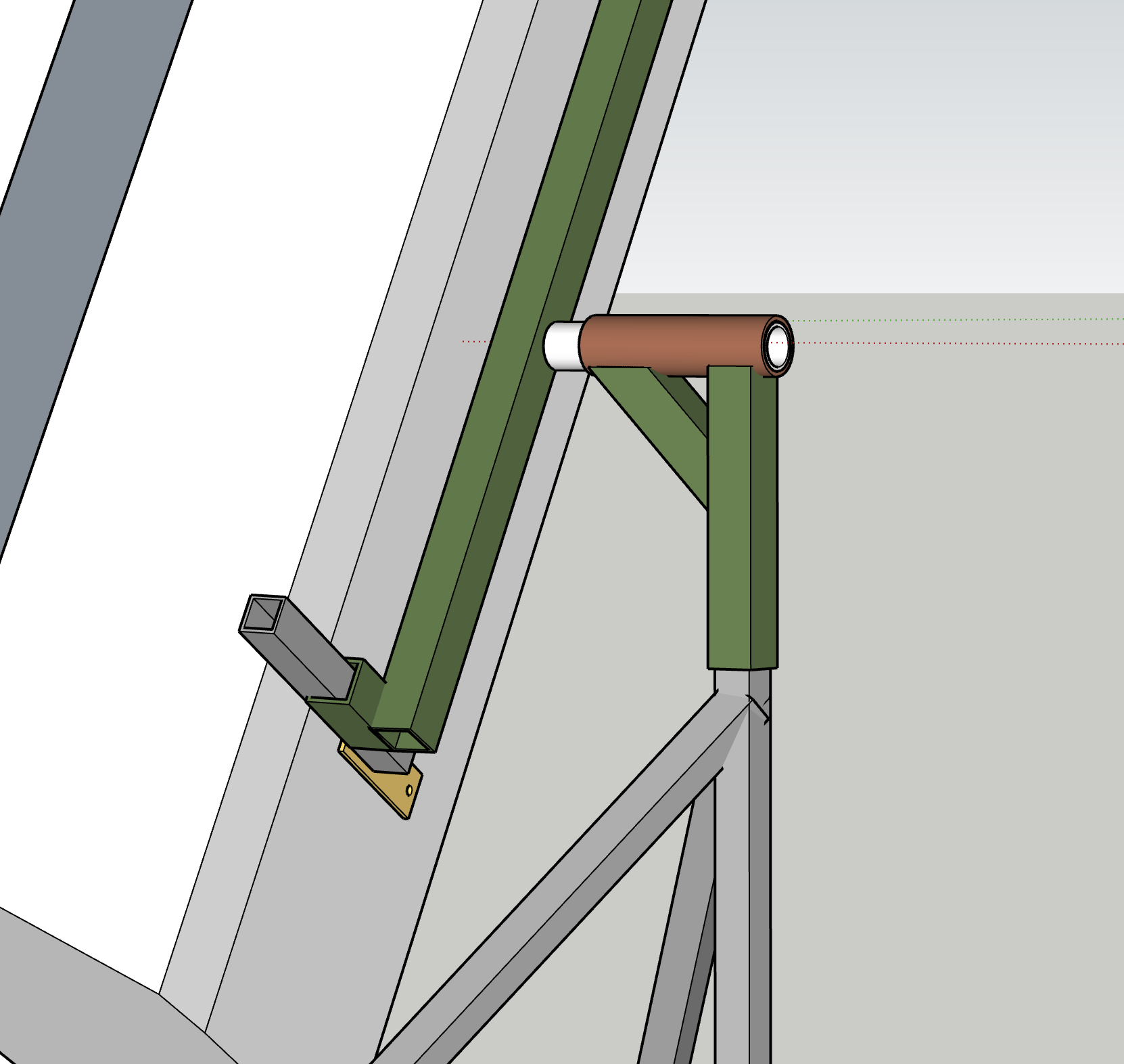

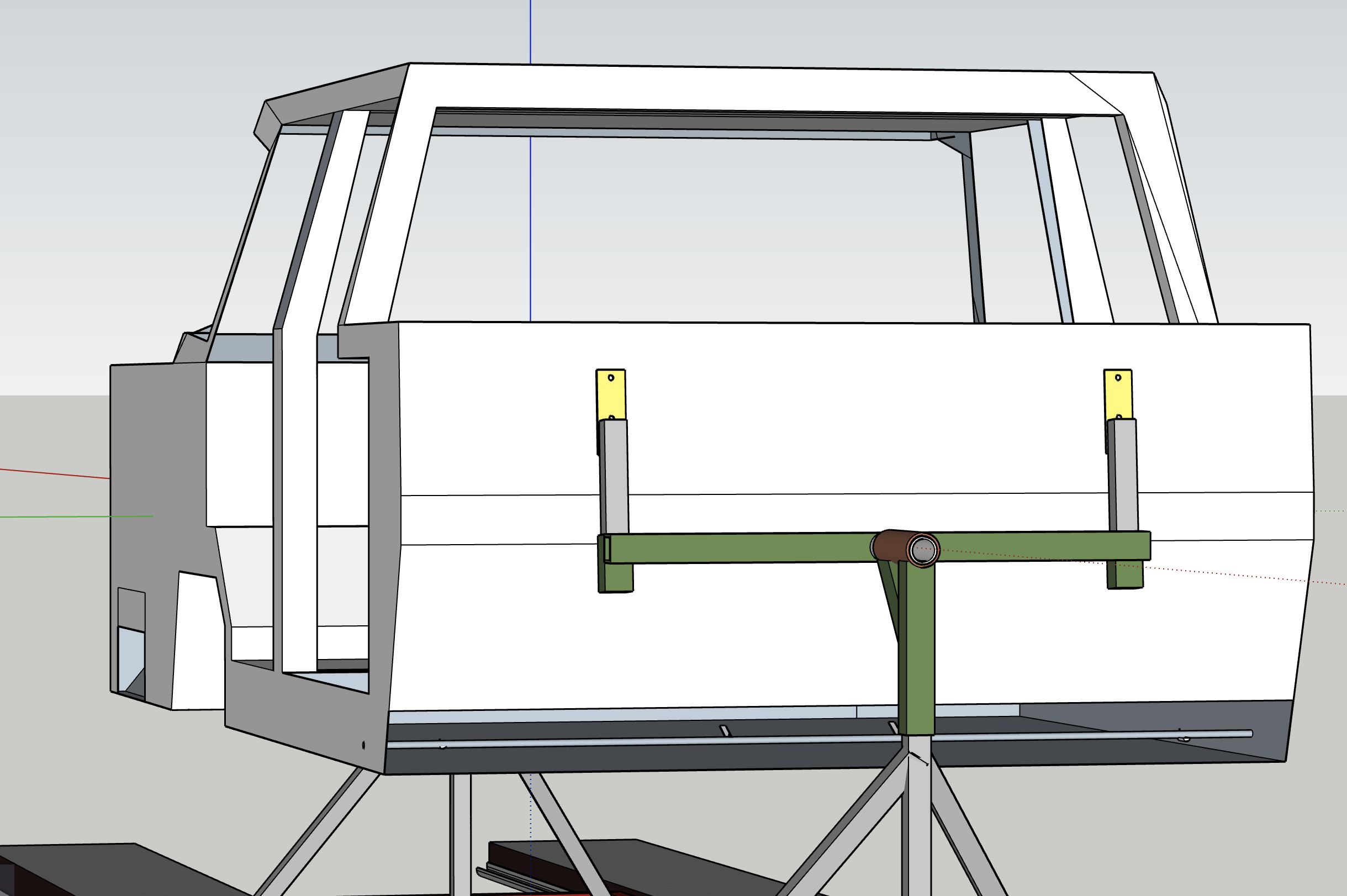

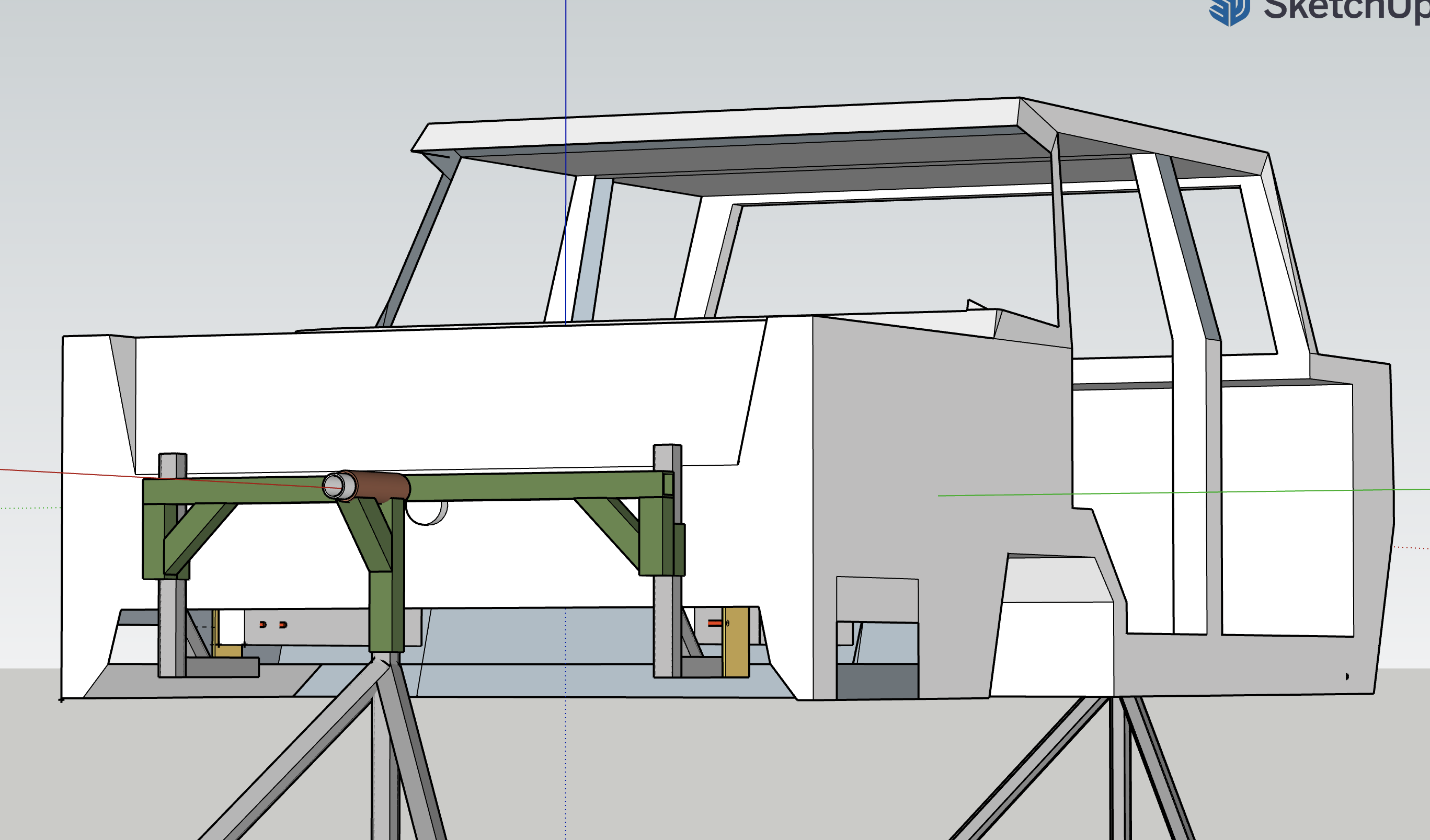

So me and my new ‘friend’ Sketch Up have been hard at work.
Took lots of measurements of the car, then took some more, then remeasured when I still didn’t think the numbers were right. They are all guide at this stage to work out material costs and feasability, but most are pretty close.
Ended up with this.
Rear Spun.png (386.41 KiB) Viewed 6110 times
Although both braces are pointing to the rear I don’t think that will be an issue. Should not be much front to aft movement
There is enough adjustment to go from a centre of gravity at the firewall seam which lines up with the fuel cap at the back….
34 Front Low.png (253.71 KiB) Viewed 6110 times
34 Rear Low.png (267.69 KiB) Viewed 6110 times
… and if need be can be adjusted to about 40mm below the bottom bonnet hinge bolt at the front, and 150mm above the fuel cap centre
34 Front High.png (763.83 KiB) Viewed 6110 times
34 Rear High.png (442.23 KiB) Viewed 6110 times
The Green section below the pivot can be raised if needed. Green SHS is 50x4, Grey SHS and the red base is 40x4. Pivot inner is 40 NB HBPE (48.3 x 4mm), and pivot outer is 50 NB HBPE (60.3 x 4.5mm). Yellow mounting plate is 50 x 150 x 6mm front and 150 x 112 x 6mm rear
Front Tight.png (164.46 KiB) Viewed 6110 times
Rear Tight.png (278.12 KiB) Viewed 6110 times
Can’t say its been easy using Sketch Up but I have learnt a lot. My next “task” is to re design the kitchen! :roll:
Scott
