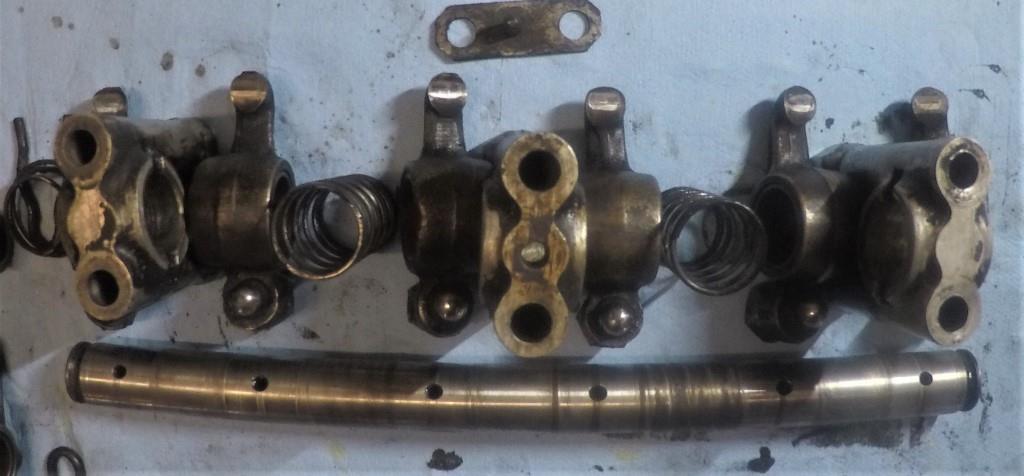

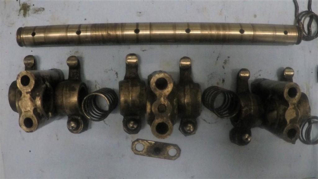

Thanks all for the advice. Cleaned up the rocker arm assembly a little:
Rockers left bank.JPG (71.99 KiB) Viewed 1130 times
Rockers Right Bank.JPG (71.99 KiB) Viewed 1130 times

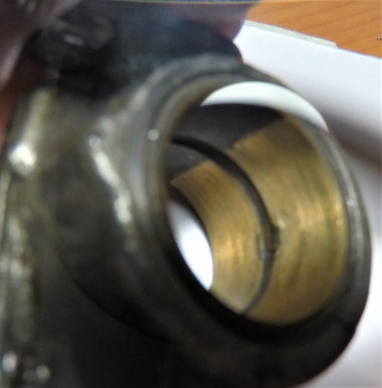

Definite wear marks on the rocker arms and 'nubs' on the ball end. Also ALL the rocker bushes have a raised bit on either side of the oil groove and directly opposite the oil hole. Picture below doesn't show it very clearly but it can be clearly felt with a finger tip.

Both rocker shafts don't look great and the right hand one was pretty well gummed up internally. The shafts appear to have a 'plug' in each end, I assume that can be removed for more thorough cleaning and replaced?

Hi Dave, are the rocker shafts s'posed to look like bananas?😁.

Brett027 wrote: Mon Jun 21, 2021 5:37 pm Hi Dave, are the rocker shafts s'posed to look like bananas?😁.
Ha ha you had me worried so had to duck out to the garage to check them! Definitely just an optical illusion from the GoPro :peaceout:

The raised bit on the inside of the rocker bushes shows how much the bushes have worn - this is the part of the bush that sits above the oil hole. If you can find a set of rocker arm bushes, good.
Don't remove the plug from the rocker shafts. Use a test tube brush (or a similar arrangement to a rifle barrel cleaner) to clean the sludge out of the shafts. The rocker arm tips will need refacing. An oilstone is good if you're very patient, or a grinder if you have a deft touch. Just follow the original contour.
