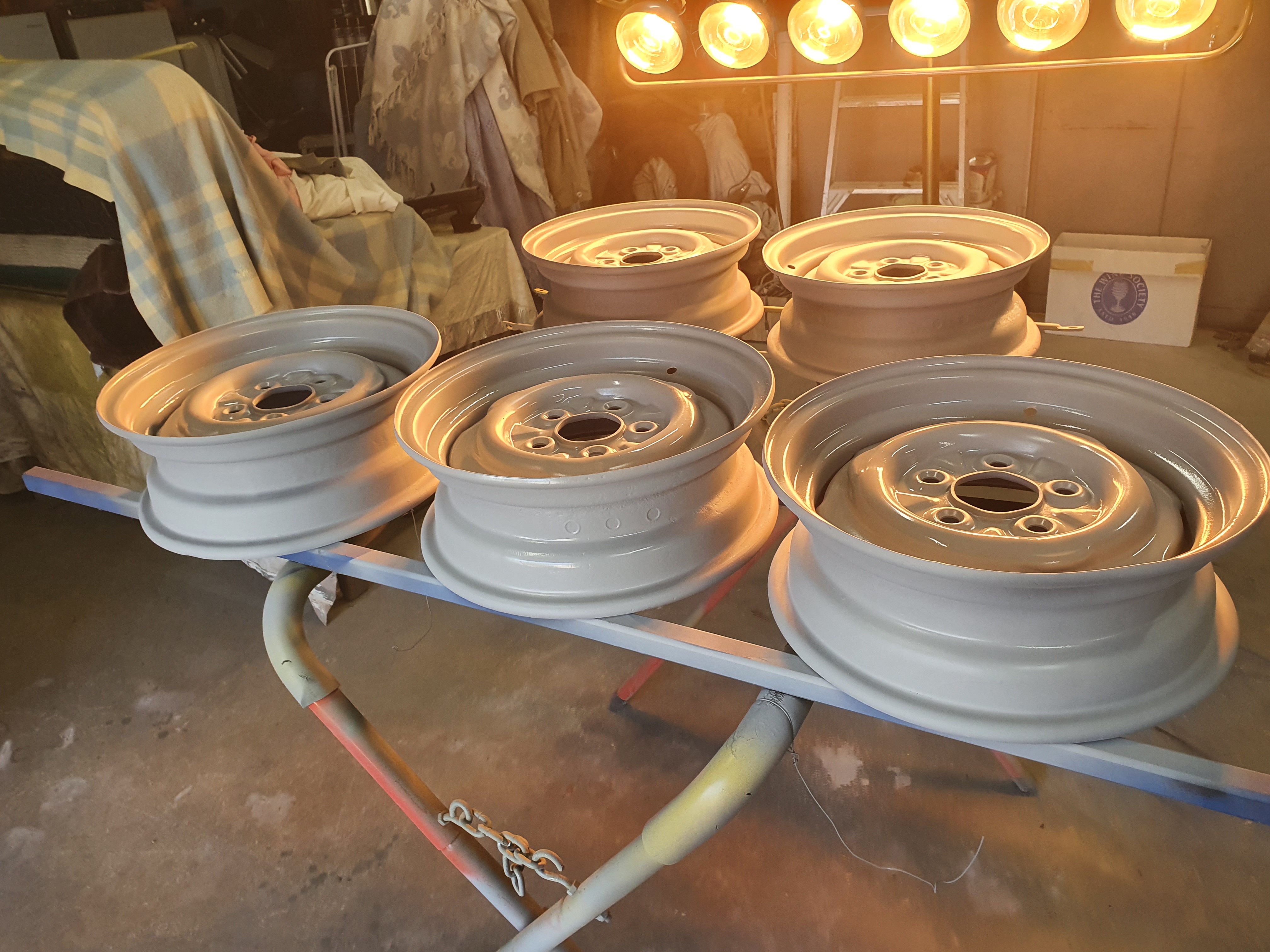

Thanks Blacky, Clay. Putting tubes in these old rims. There is too much pitting and unevenness for tubeless to work.
Dates show four 1960 and one 1961.
Treated for rust and etch primed and now waiting for primer to dry. Decided that as there was 1 layer of black on back of rims, that I would paint Artic Beige on front and black on back. Black first and Arctic Beige overspray on band as per how I found them. A bit harder to do than straight colour over whole rim but period correct I think. Staying with acrylic lacquer because it is easy, matches car colour and can be touched up easily as needed over the next 60 years😀.

Ha. Not my finest hour with the gun, but effective. Will be more particular about the front. Image

Xmas (maybe)😁. There are some 17°C days coming up at the end of the week and into weekend. That will probably be my last chance to finish bonnet and ashtray and glovebox lids in yellow, front seat trim in Scarab Green and Arctic Beige wheel fronts under lights. Fingers crossed.

Odd job day. Wheels finished, clutch and flywheel sorted, motor ready to attach to gearbox ( or vice versa). Image
