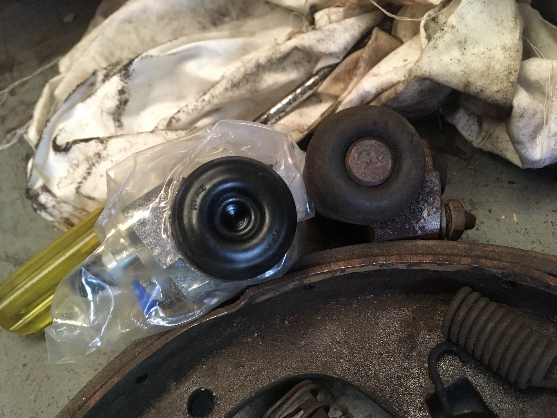

So I have a HR diff in my FButEKsedan. When I stripped it down last year I replaced the rear wheel cylinders with the HR option from Rares.
This is the box they came in Here is the new one compared to the old one. Clearly different. But hey rather than question it at the time - what the hell, lets install them anyway! Maybe when you press the peddle the piston will push out? Well still haven't fit the diff back into the car but the shoe/cylinder combo just looks wrong.
Any ideas?
Any ideas?

Rares part on the invoice was 7420771, "Holden Cylinder Wheel Brake Rear with Drms EJ EHHD HR LC"
Scott
Re: Rear wheel cylinder identifcation HR Diff.
Scott,
You have managed to get the rear wheel cylinders for 4-wheel-drum-brake cars.
You want 9/16" bore rear wheel cylinders, which are for cars with front disc brakes.

Thanks Rob - So when I re read the invoice that makes sense!
Oh well - anyone need a set of rears let me know. If not I'll stick them on gumtree.

So went back to Rares site to order the correct ones. Did a search for "HR rear wheel cylinder". No products found.
Looked on Kingswood Country but this time searched "rear wheel cylinder". Found a picture of that looks right but the description reads....
Holden REAR Brake Wheel Cylinder x1 HD HK HT HG Torana LC LJ WITH Front Disc
HD, HK, but no HR. Surely HR is going to be the same as the previous and next gen Holden. But once bitten.....
Description does not mention bore size.
So back to Google "holden HR wheel cylinders". Second image is an Ebay seller "2 Rear Wheel Cylinders LH + RH for Holden HD HR HK HT HG Torana Sunbird LC LJ". The description on the site includes the bore size 14.28mm. Convert to inches = 0.5622. 9/16" is 0.5625
We have a winner.
Now I'm annoyed though. How can this be so hard?
Back to Rares and search "rear wheel cylinder" like I did on Kingswood Country (omitted the HR). Filtered Holden Only. The only hit is for FB/EK.
Sigh. Lets do this the manual way.
Brake Compontents > Holden > HR. Scroll through and the only product they list is the ones I incorrectly purchased. This explains why I would have got these ones - they are (seemingly) the only option. Then I remember the Kingswood listing that didn't mention HR. Turn off HR filter and change it to HD.
Page 3 has the following listing Holden Wheel Cylinder Brake HD - G LC - J Rear With Frt Discs
Success!
Bit frustrated by the search engine / item description on Rares site, but got there in the end.
Scott
