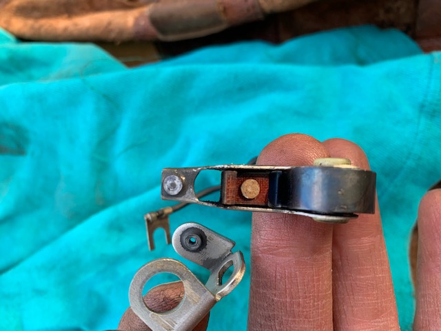

Checked the points and hmmmmm..... not good. Measured the point gap and I reckon I had 3-4 thou
Put a new set of points in, then proceeded to check the plugs. They all looked reasonable. Did the one plug at a time compression test and no unusual noises just the internal pssst. Cranked the motor over and no observations of z as nothing coming out of plug holes.

- Old points
- 90649767-2D69-43DC-BC04-7FC5640F546B.jpeg (81.92 KiB) Viewed 2448 times

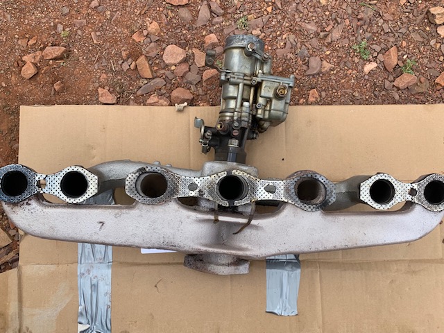

You have a split manifold gasket at the centre intake leg.
In what condition are the front tailpipe support and rubber (the one under the rear floor)? If loose or absent, you'll split manifold gaskets on a regular basis.
Also, the inlet and exhaust manifold faces go out of plane, and this is another cause of split manifold gaskets. Take the manifolds off (you'll have to do this anyway) and lay a straightedge along the faces. If there's a noticeable offset between inlet and exhaust faces, it's a good idea to take the manifolds to a machine shop and get the faces milled. This is easier than trying to undo the hot-box bolts . . .

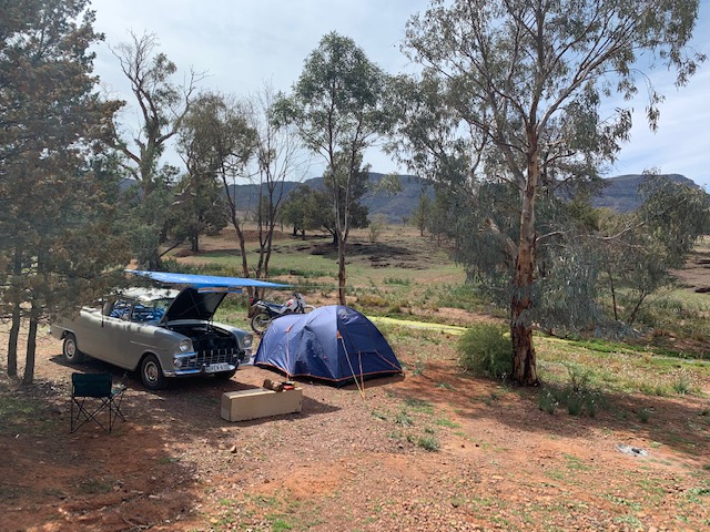

Took it for a spin and still lacked power. Got onto my local Repco store at 11.00 am for a new gasket and they had one in warehouse other side of town. Two hours later it was in store then onto transport co. Next morning at 8.30 it was 450 km from home near me. Jumped on my bike picked up the part and proceeded to swap gasket in the garage see picks. It is now running smooth but still lacks a little power but should get me home, I hope!
- Bush garage
- 526388D3-AB40-4E95-9E60-0A99DD316927.jpeg (175.89 KiB) Viewed 2405 times
- Old gasket blown at inlet port 3&4
- D8DE3363-3E3B-42EC-A113-B313279F8E79.jpeg (140.55 KiB) Viewed 2405 times
