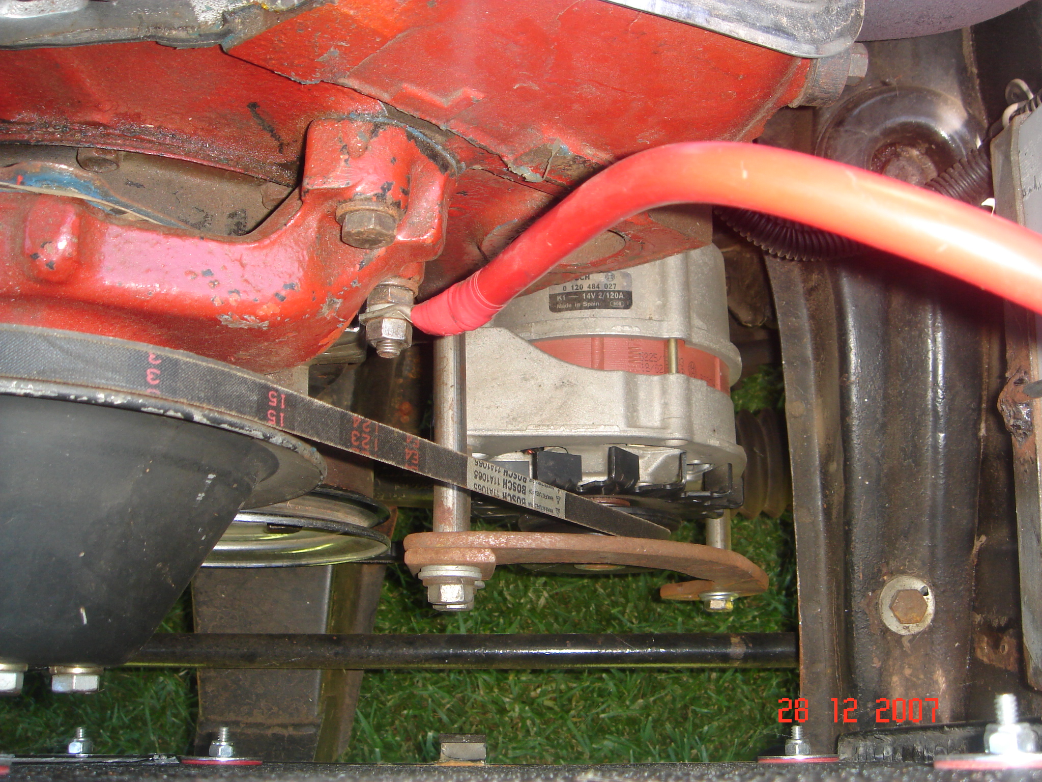

Forgive the old photo (2007? really? :oops: :oops: )
EK wagon alternator.JPG (1.43 MiB) Viewed 836 times
Bosch BXU12121A 120amp unit, driven by a Bosch 11A1065 fanbelt. Low mount, just clears the sway bar. Car starts, but idle speed is not enough to excite the alternator (lazy, lumpy old Chev) and idiot light stays on. Blip the throttle, alternator gets enough revs to excite it, and the light goes off (and stays off).

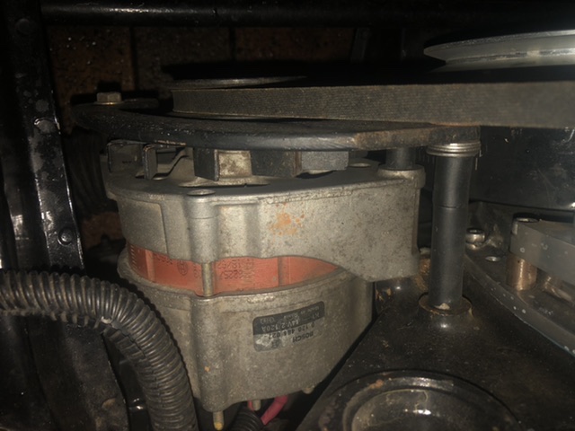

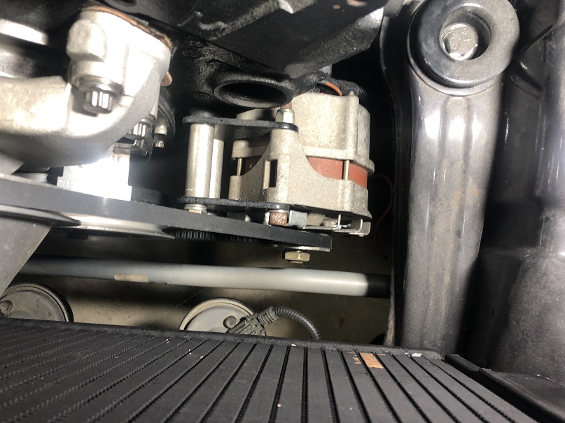

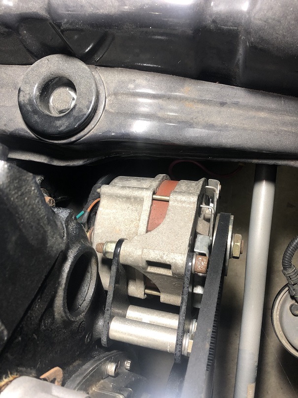

A couple of photos Bill.
My adjuster / slide is on the bottom.
BILLY BLACKARROW
Posts: 1065
Re: Alternator
Post by BILLY BLACKARROW »
Mine is similar to your's Greg but adjusting bracket is seperate I had to lift my motor 3/8" to clear steering shaft I wouldn't think that it would make that much difference but I can't get it to fit properly there doesn't seam to be enough room between motor and chase rail
Harv is your's homemade

Harv's Alternator is also attached at the block where as mine uses the bracket, Harv's is closer to the engine.
Posts: 5709
Re: Alternator
Yep, my bracket is home-made, cut out of a bit of plate.
I promise I painted it and replaced the fasteners sometime in the last 13 years :lol:

OK
I have got mine sitting like Harv"s I think from what I can see your earth is in the way Harv :lol: you have mounted in the lower hole in the block and you adjusting bracket in the top hole with home made bracket It's been tooooooo cold and wet for an OLD bloke to be working in the shed today and I have a dental appointment tomorrow so that's out to. All I have to do now is to work out my adjusting bracket setup if I can't do that I will go back to a high mount fingers XXX
BILLY BLACKARROW
Posts: 5709
Re: Alternator
BILLY BLACKARROW wrote: Sun Jul 26, 2020 4:37 pm you have mounted in the lower hole in the block and you adjusting bracket in the top hole with home made bracket
Yep - that’s how mines mounted.
