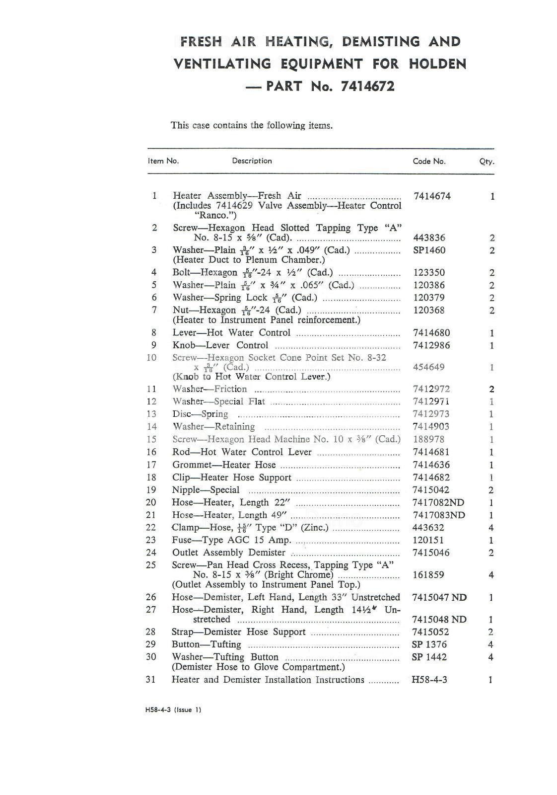

Dragging up an old post but need to know how the warmaride heater mounts.
So, I have the plenum flap and my heater has the rectangular flu bit. Does it just screw up below the above pictured flap ?
My heater also has the 2 brackets to mount it on the back of the dash.
Not sure if there is spacers between the plenum flap and the heater shroud or does it just screw up and compress the foam gasket ?
Thanks Greg
Posts: 11524
Re: Air Vent seal
If it’s like this one Greg, uses the outer two plenum vent screws at top. Can’t remember how it bolts to dash but mine didn’t have anything in between when I ratted it from a mates car in 1988.Image

Posts: 5709
Re: Air Vent seal
They mount like this:
7414672 Fresh Air Heating Demisting  and Ventilating Equipment FB Holden 1 of 7.jpg
7414672 Fresh Air Heating Demisting and Ventilating Equipment FB Holden 1 of 7.jpg (13.81 KiB) Viewed 11240 times
7414672 Fresh Air Heating Demisting  and Ventilating Equipment FB Holden 2 of 7.jpg
7414672 Fresh Air Heating Demisting and Ventilating Equipment FB Holden 2 of 7.jpg (336.4 KiB) Viewed 11240 times
7414672 Fresh Air Heating Demisting  and Ventilating Equipment FB Holden 3 of 7.jpg
7414672 Fresh Air Heating Demisting and Ventilating Equipment FB Holden 3 of 7.jpg (180.39 KiB) Viewed 11240 times
7414672 Fresh Air Heating Demisting  and Ventilating Equipment FB Holden 4 of 7.jpg
7414672 Fresh Air Heating Demisting and Ventilating Equipment FB Holden 4 of 7.jpg (151.11 KiB) Viewed 11240 times
7414672 Fresh Air Heating Demisting  and Ventilating Equipment FB Holden 5 of 7.jpg
7414672 Fresh Air Heating Demisting and Ventilating Equipment FB Holden 5 of 7.jpg (193.81 KiB) Viewed 11240 times
7414672 Fresh Air Heating Demisting  and Ventilating Equipment FB Holden 6 of 7.jpg
7414672 Fresh Air Heating Demisting and Ventilating Equipment FB Holden 6 of 7.jpg (205.5 KiB) Viewed 11240 times
7414672 Fresh Air Heating Demisting  and Ventilating Equipment FB Holden 7 of 7.jpg
7414672 Fresh Air Heating Demisting and Ventilating Equipment FB Holden 7 of 7.jpg (267.71 KiB) Viewed 11240 times
Posts: 2661
Re: Air Vent seal
A picture tells a thousand words !!!
Champion effort Harv Thanks.
