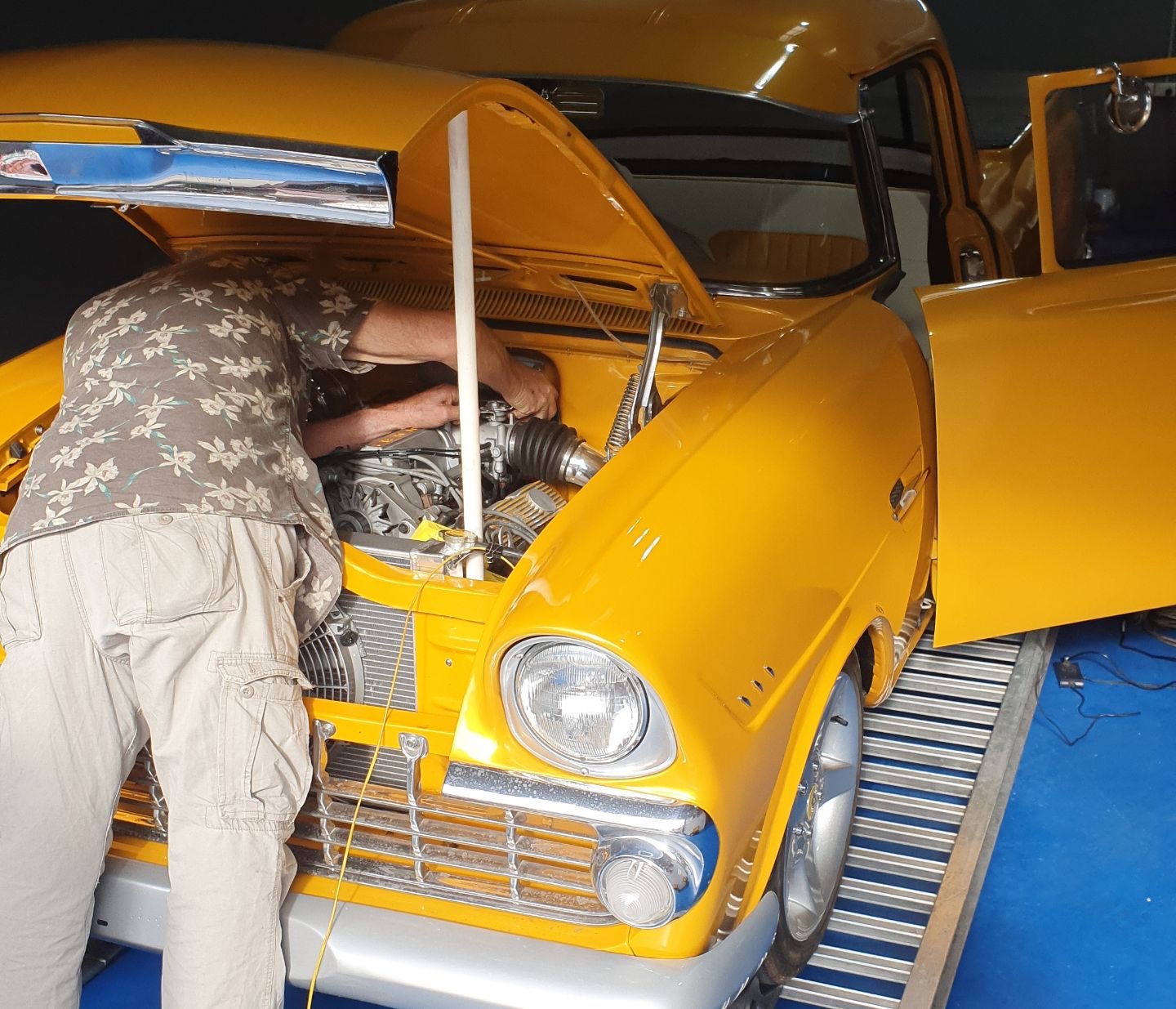

Frankenstein was delivered to RJM Custom Auto' yesterday for surgery Ryan informed me this morning that they have already installed the high stall and he was able to drive Frank for a very short time, he says it is over fueling a lot so now onto the dyno for tuning, should be done by Tuesday and then need the engineer to witness and sign off on the tune, after that need to have weighed, wheel alignment, final inspection by engineer including brake test I assume and then oh so close to registration :clap: :clap:

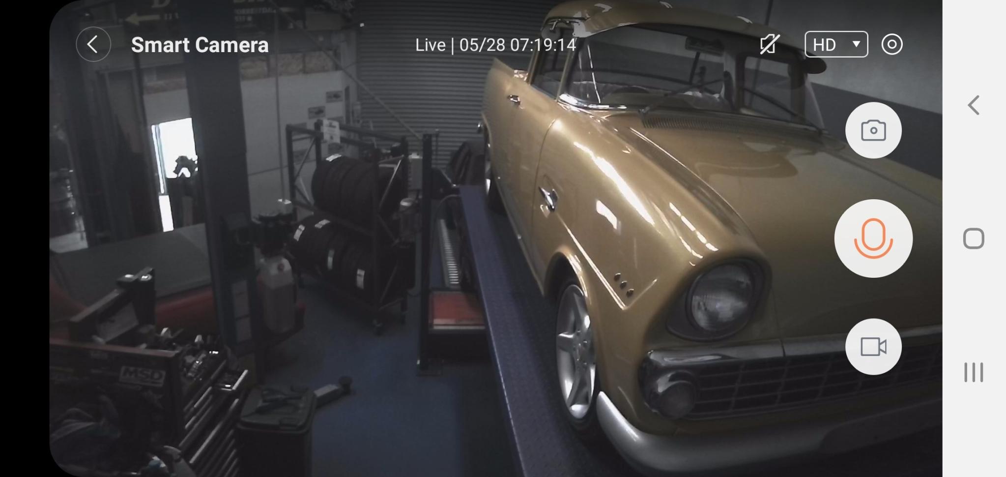

Frank asleep on the hoist in Ryan' workshop last night.
