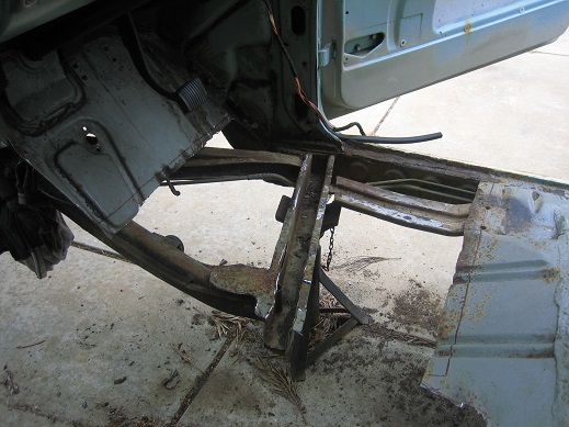

As what appeared to be a good start on the rust, quickly turns sour on closer investigation.
Doors did not line up at bottom, sill repaired with bog, etc.
It was a little crunchy under foot so pulled the carpet and found floors rusted under the fiberglass batches, so out they came. Added crush tubes for future chassis rails. Pulled the front clip off and found more. By now I’m a little concerned with the quality of any previously repaired sections and my " quick " turnaround look out of the window.
As we have all seen, it looks good when it is filled with bog and painted.
The guys who owned this ute had several other cars in this workshop. HR van with V8, EH premier and a LX SLR 5000 Torana so my brother tells me.
I have started now so the only way in forward.

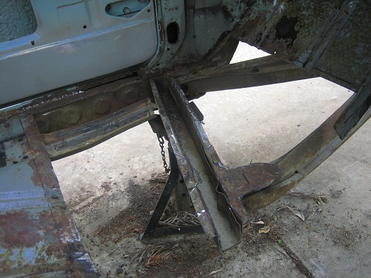

A couple more photos of the rusty sections I cut out these and purchased patch panels from Rare Spares. I thought you only over lapped when spray painting not doing rust repairs.
Made the mistake of welding these in on the bench. When I fitted the guards to the ute the panel were out of shape.
I had to cut the welds open to relax the metal and then slowly re-weld. Another lesson learnt.
Cleaned up the fire wall and weld up any hole that was not required. Smooth out area that were rough and deleted the battery box. Add a new tunnel for the Trimatic.
You just have to love laying on your back and welding and grinding over your head. As yet no full face mask for grinding and old welding shield. Lots of advice from Anne-Marie on safety, which is helpful. I so wanted a rotisserie but had to settle for a couple of 44's ( 200 litre ) drums.
