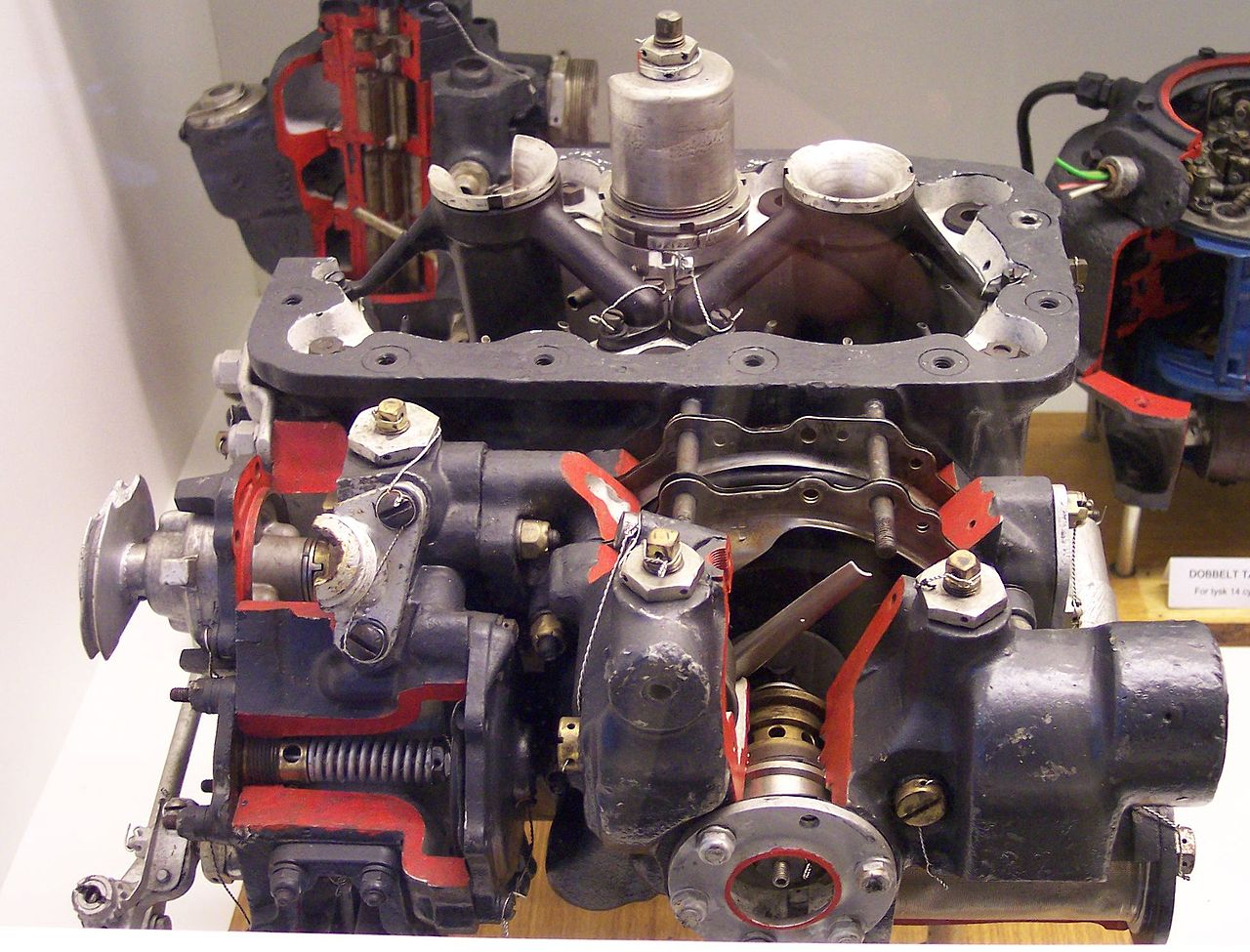

Is that the latest model Stromberg?
Posts: 5741
Re: Red Rattler Revamp
60Special wrote: Tue Mar 17, 2020 8:07 am Is that the latest model Stromberg?
I really hope so :)
AFAIK, Stromberg didn't make huffers, though they did make some complex, funky floatless carbs for aircraft - cutaway version below:
Stomberg pressure carb.jpg (229.02 KiB) Viewed 724 times
