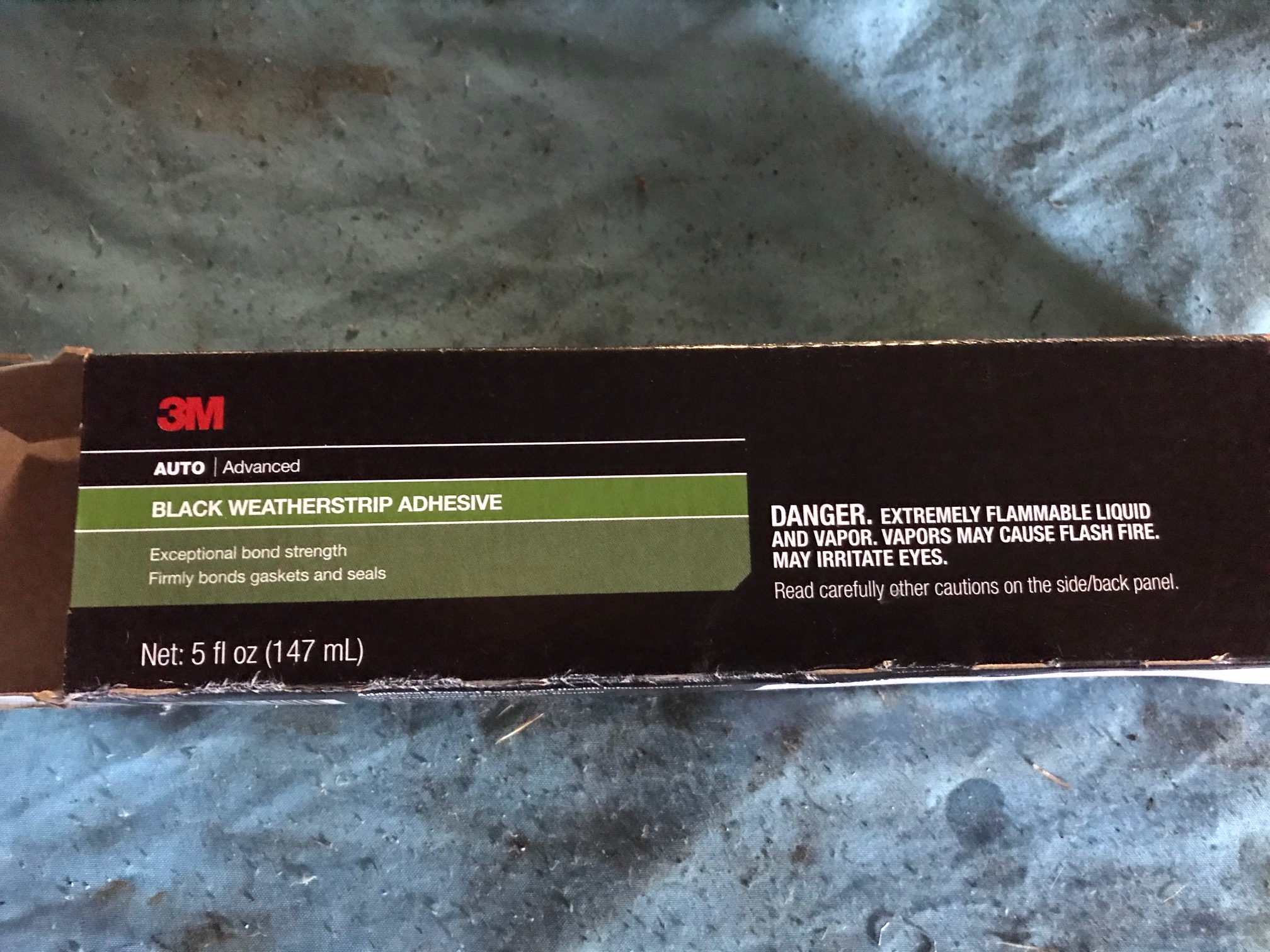

Rare Parts had a 3M product (mastic) specially for glueing this stuff but the name slips me at the moment, I will take a photo of it and post it up, I was told I had to key the paint underneath where the rubber goes so it sticks better so I did this yeaterday afternoon after work and so far it looks like it is going to stay in place really well and both my windows go up and down no problems.

This is the 3M product that Rare Parts supplied for the weather strips, sticks like shit to a blanket.
And the ID on the invoice that they gave for the rubber was Laser/Mazda/Capri rubber outer D belt if anybody is interested.
