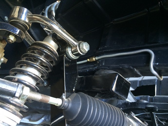

Back at it again after a Iong lay off ....got the hand brake working with the 9 inch diff ..
BA &*#@ discs grafted on the diff housing and using the BA &*#@ h/brake cables to the photo,ed splitter then to the modified FB Mechanism activated by the standard FB handbrake handle ..works well looks standard ....now the brakes

Got the brakes all plumbed up ....just need a tidy up and fill with fluid and bleeding ....

Back into it , brakes all done and bled up , used &*#@ BA rear discs and handbrake mechanism and cables and VT Commodore discs up front ,, used standard FB handbrake lever ,remounted the standard mechanism and hooked it straight to the BA &*#@ cables , fuel tank has been fixed and painted inside , Question .... just getting ready to fit up seat belt in the FB 327 sbc sedan anyone got some photos or drawings of what and where you have mounted them ?? ...My engineers wants 100mm x 150mm minimum plates
