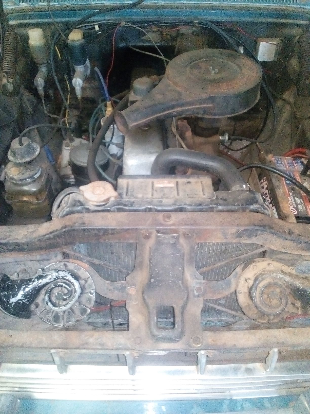

I got it to work today after taking the original low horn off and cleaning the terminals, all fixed. Funny how problems are usually fixed by the simplest things in the end, seem to over think things a bit....
Looks pretty don't you reckon and sounds pretty cool. Thanks for you ideas and help once again. Al

Good stuff Al and yeh it looks good. The new horn looks a bit out of place though. I think you need to rub it in some brown dirt to match the other one
Your washer bottle looks cool too
Re: Hi low horn wiring question
Yes. Lucky feller finding one of those hens teeth. I love the symmetry.
