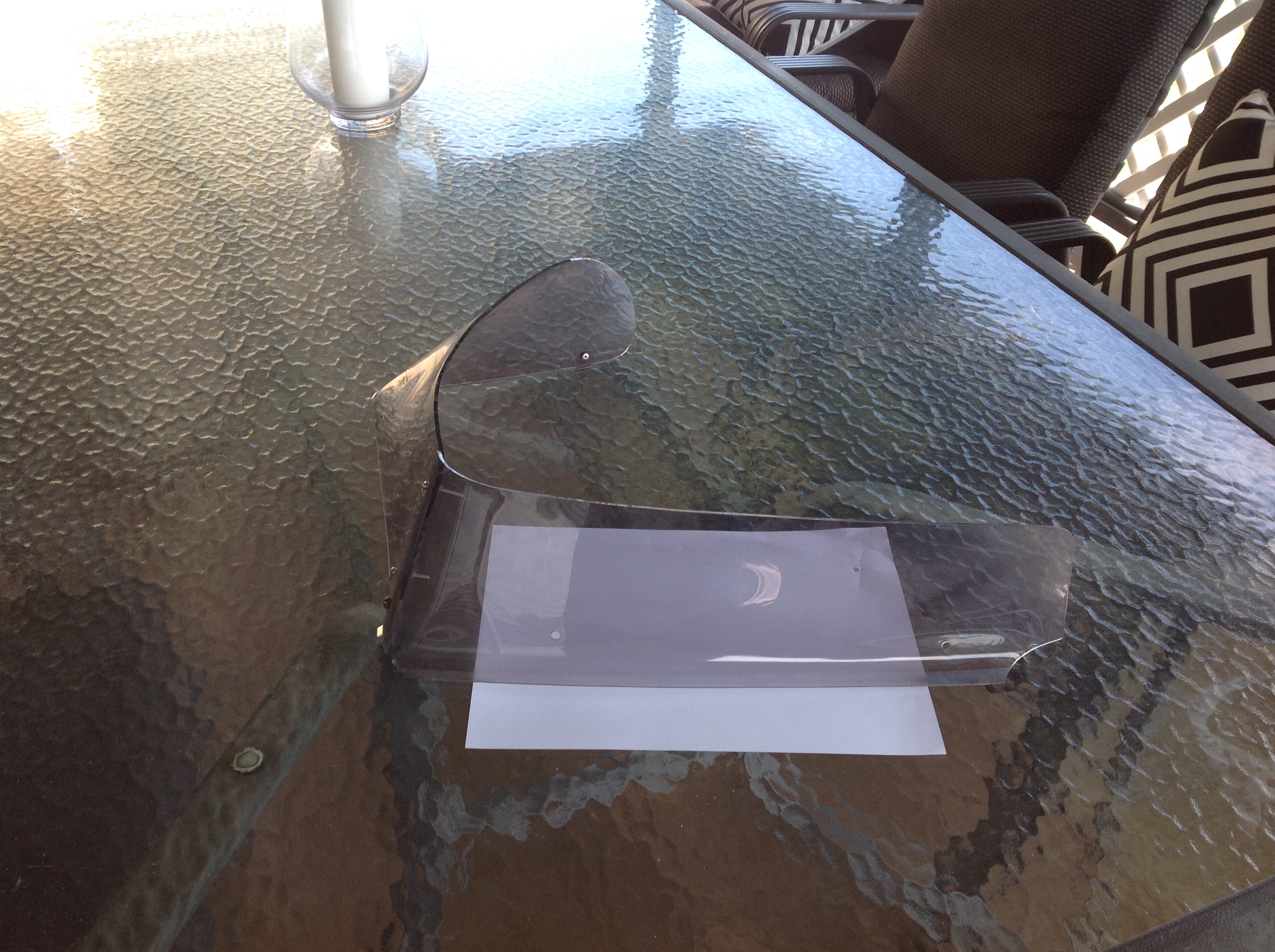

I have one i think it is blue on the top i will have a look tomorrow and post photo i don't know if it is what you want.

The one I have is for a sedan/wagon it is a smokey grey, I have tried to show the colour as best I could. it is new never been fitted & all hardware $90 + post

A word of warning. I have two weathershields the same as Billy's, one for drivers and one for passengers sides. I am in the process of fitting them to my EK wagon. The weathershields come with four brackets that bolt on, two of which need modification (shortening). No big deal. The fifth bracket is supplied pop-riveted on (you can see the rivet in Bill's photo). The body of the pop-rivet (the bit that gets compressed when you rivet) sits between the weathershield and the top of the door. This part of the door is painted. The rivet will try to tear the paint, both during normal operation and when installing (dont ask me how I know). Drill this rivet out, and replace with something soft and rounded.

I don't know yet. I installed the passengers side, scratched the paint, swore, took it off, and put it into the naughty corner.
Could turn the rivet upside down, and use a dollop of silastic to seal it (let the silastic set before installing) though that gives the manky end of the pop rivet sitting up..
I'm thinking a nylon bolt, simiular to this:
https://www.ebay.com.au/itm/Clear-Nylon ... :rk:1:pf:0
Perhaps even cut the head off the bolt, tap the weathershield hole, screw and glue the length of bolt thread into the weathershield, then use the nut to hold it on.
