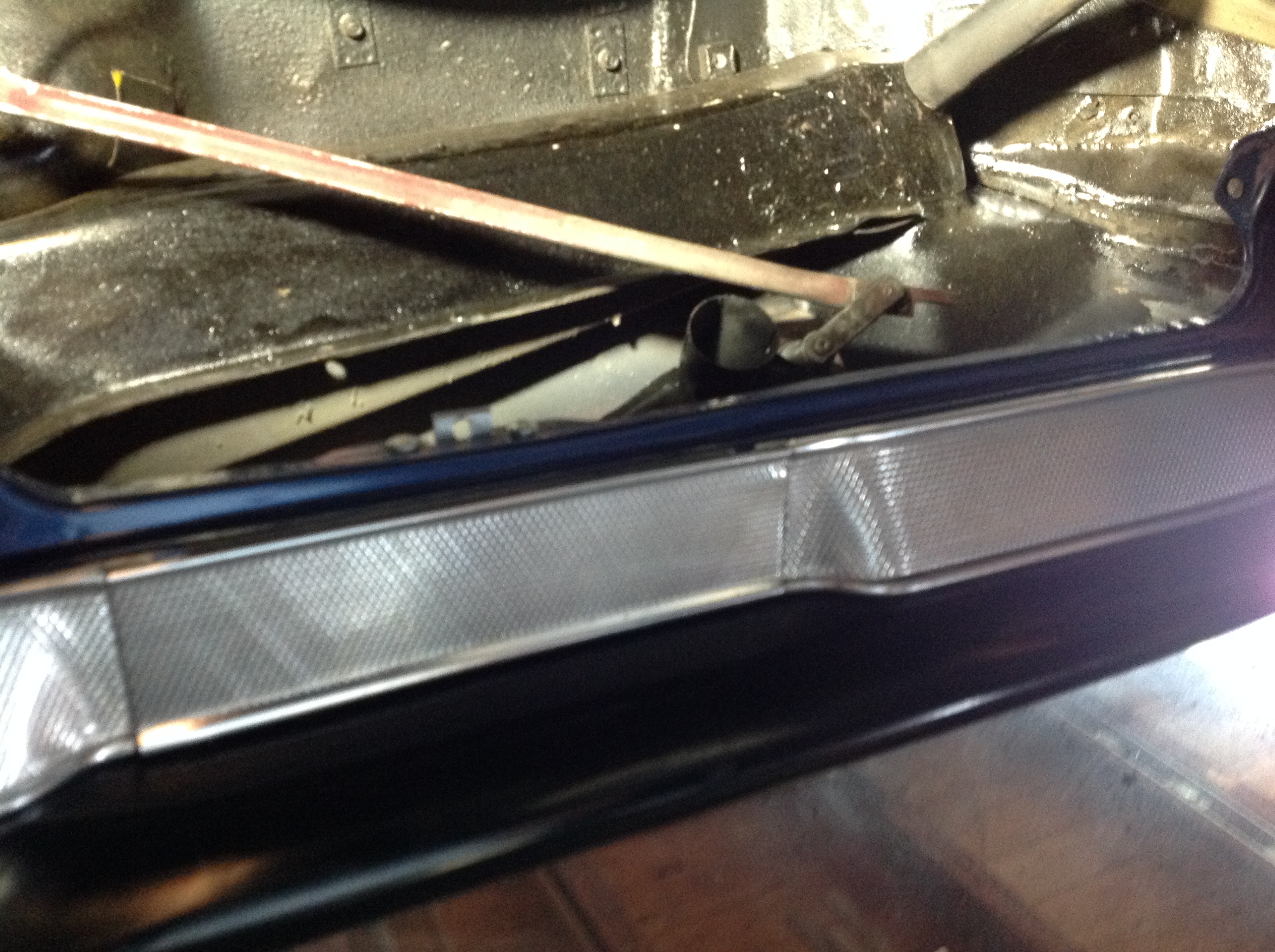

Image Passenger first.

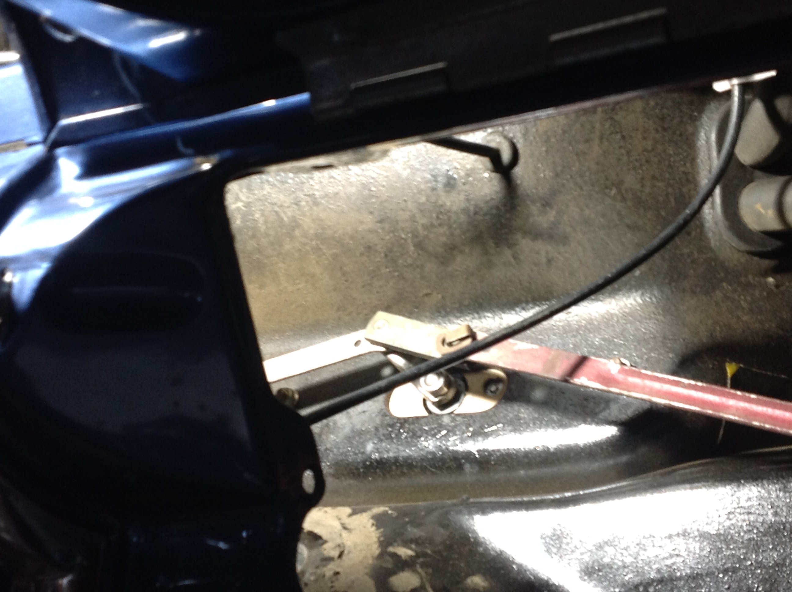

Image Driver.
The driver or right arm is the kinked one and goes on last just in case you’re in any any doubt. I installed ek arms and motor in the fb ute. The fb arms are the same shape but slightly different ends:ImageEK on the right. The FB ones have a hex bush to suit the vacuum motor, which rotates back and forth through about 160 degrees, achieving the same effect as the rotating crank on the ek. Just in case you are using fb connector arms.

Image Hope this helps Billy

The photo's help a heap Errol62 at least i no the arms are around the correct way and it parks but the arms move at a different rate / speed . I have to leave it at this stage as a friend is coming to give me a hand with the wiring of the car i will get back onto it when i can meantime if anyone has any ideas as to why the arms move at a different rate / speed please post

It has to be the crank you are using, unless the slave arms are mismatched. They should be both the same length. VR may well have a different sweep each side. Stroke at the crank should be the same each side.

I am not sure what you mean by( both big end centres are on the same radius or stroking the same ) ( slave arm lengths ) ( slave arms should be a reflection of each other )
This is my set up not the best photo i know if they dont help i will try to get better tomorrow some are upside down i know not why

it is not in the park position and photos are upside down.

Okay. I’m pretty sure you just need to disconnect your crank and turn 180 degrees on the shaft. Then reconnect actuator arms with the wipers still in the park position.
