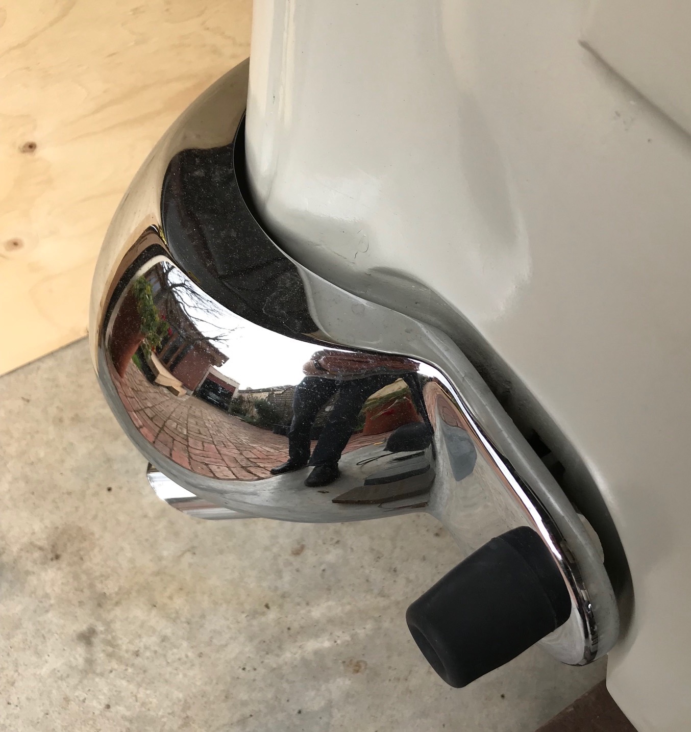

Good to hear your back on the job. For the bumper rubber stops I grabbed some from Bunnings (door stops). I think the next size down might be more suitable but these do the job.

Sweet! Yes I think those stoppers are the ones that Harv mentioned as well.In the Shed wrote:Howdy Joe,
My biggest dilemma is finding the right chrome, dome-top bumper bolts round the side of the bumperettes. I currently have hex head bolts and I’ve whacked my shins on them more than once... they are longer than most I have seen on Rare Spares’ website as there are rubber blocks between bumper and body. Same as the front bumper.
Does anyone know if there are bolts from another Holden model, available through Rares, or elsewhere, that will do this job?
Re: Leroy the EK Ute
why would those ones be different from a sedan?
The ute ones for the bumperettes are longer. From memory, sedan are 1.5" and ute are 2". I couldn't get a "pack" from Rares, so ended up mixing and matching. I think the bumperette bolts were from a &*#@ pack.
I've got two 1.5" bolts (one rough, one pretty good) and one 2" (new) here. Can throw them in the mail if it helps.
Yes you can use front or rear sedan wagon. They tend to get bent from front rear bingles. Pretty sure rares have them and the bump rubbers as well.
