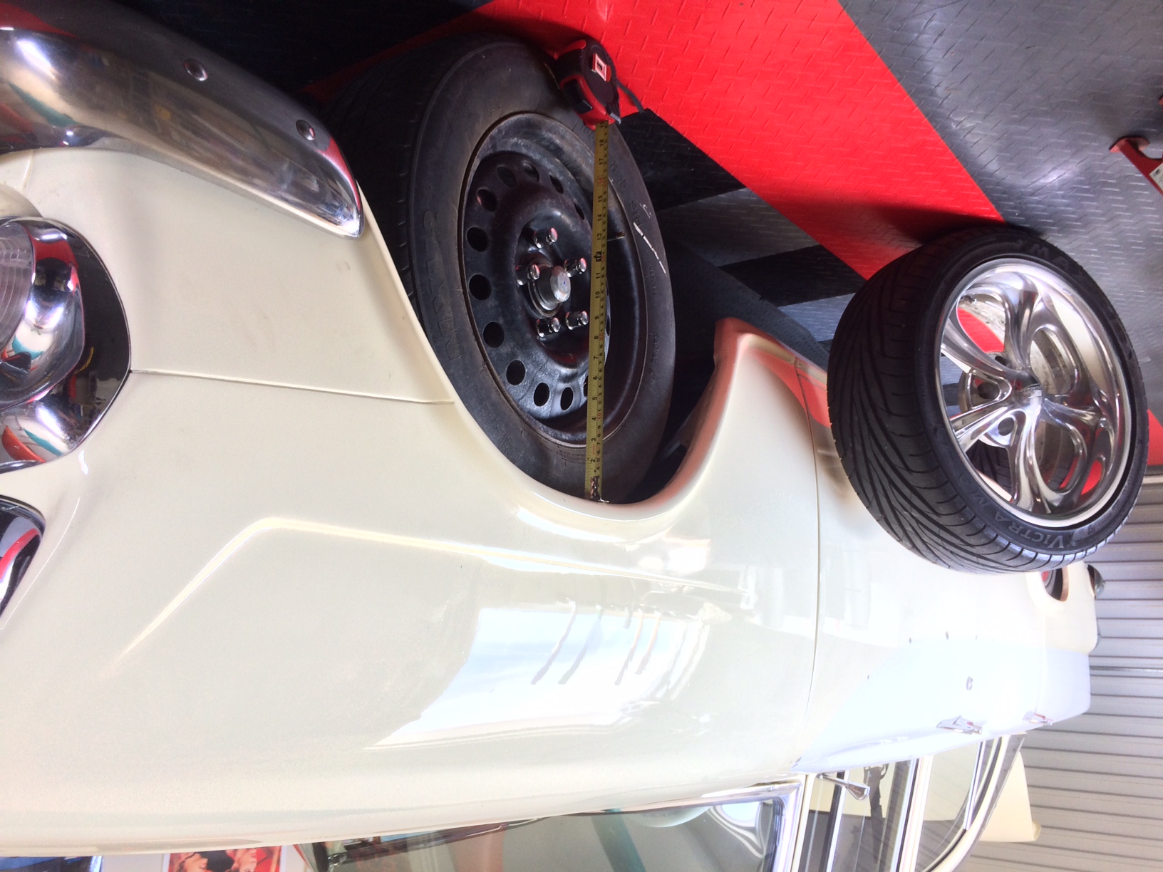

Sorry about the rotation - it's upright on my computer..
Here are more pics.
This is with the lowered springs in - thank god my trailer wheels fit and happen to be the size I want to go to 195/65 R15 on 6 inch rims. It's 245mm from centre hub to top of guard (60mm lower than previous spring) According to King Spring techs, standard springs will be 30 - 40mm higher, about here.
This is the level that I took the photo of the caliper at, it just hits it. The previous spring was about 25mm higher (raised King springs ??).
Here are more pics.

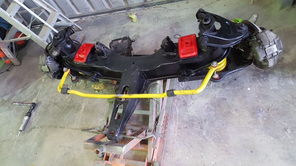

Jay,
Have a look at this photo its off a HK, you can see the wishbone difference.
If you were going to grind the wishbone out I would suggest bracing it for peace of mind.

Cheers Greg,EK283 wrote: Thu Feb 22, 2018 7:36 am Jay,
I don't think grinding out part of the wishbone is an ideal solution. I think I will just return to the billet wheels and previous springs and live with it if I can't find another solution. The low profile wheels don't make it fun to drive everyday.

I think I have solved the problem, need to wait until the new springs get here and see how they fit in and settle in relation to the angle of the control arm. Actual settled coil height on the Kings standards will be the key. I was jacking the vehicle up 30mm (as per previous photos), from centre of cross member and not considering the fact the control arms moving in relation to the caliper, so wasn't getting a correct measurement - I know what I mean, hard to explain.
Fingers crossed I am correct in my thinking. Cheers
