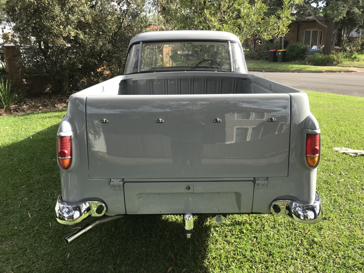

I wasn't too sure about those tonneau bungee-cord clips. Part of me wanted to remove them, and fit Nasco-type lift-a-dots. The reason I kept the bungee-cord clips is that it lets you pile stuff up quite high in the tub, put the tonneau (or a tarp) over it, then tie back to the bungee-cord clips... not that I've ever done that :oops: .
Optimized-Towing 2.jpg (880.34 KiB) Viewed 846 times
Harder to do that with the lift-the-dots.

Looking great Harv - Paint will be fine - thats the beauty of getting a new re-spray - very easy to touch up so I'm sure they can fix for you without drama.
Did you use a replacement spare door or was the orriginal still good? Mine is a bit cheesy and will take some repair but can't bring myself to get a rares plastic one.
Nut-sert idea from Black is cool - will pinch that too thanks Blacky - Why the double height pins though? Wont that let more water in as it holds the tarp higher off the surface? I'm going with nuts all around mine - might even get them tacked from behind so they can be painted and sealed from rust.

The ute had double-height studs when I bought it, From memory, the studs sit between the rear window and the tub lip. The double height helps get over the tub lip.

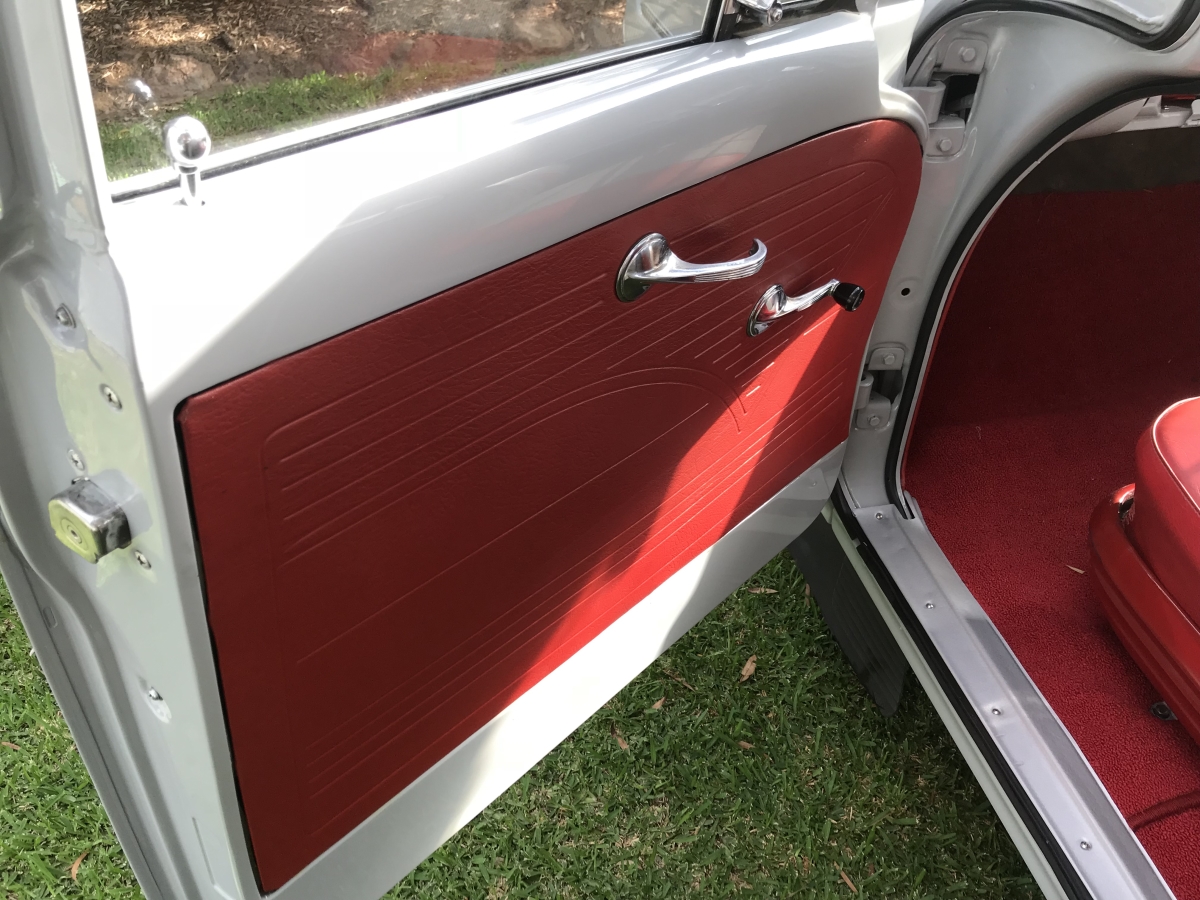

Do you have any photos of the hammertone scuff plates? I'm trying work out how to paint mine, that won't look garbage... seeking inspiration ;)
Posts: 5741
Re: Harv's (Grace's) EK ute
thebrotherj wrote: Wed Apr 04, 2018 12:33 pm Spectacular! Wow Harv, I'm officially green (or should I say Silverton Grey?) with envy. Huge effort, feels like this came together very quickly indeed.
The ute was quick, as it needed little work. Not much rust, and most of the "bits" had been cleaned up in a previous resto about 10 years ago (just needed a good clean and polish).
Photo of the scuff plates below. The hammertone suits the era, is a little more forgiving of scuff marks, and seems to set a bit harder than normal rattlecan paint.

Harv is it a Hammertone silver or ???????? my FC ones really need a birthday :ebiggrin:
