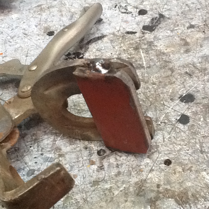

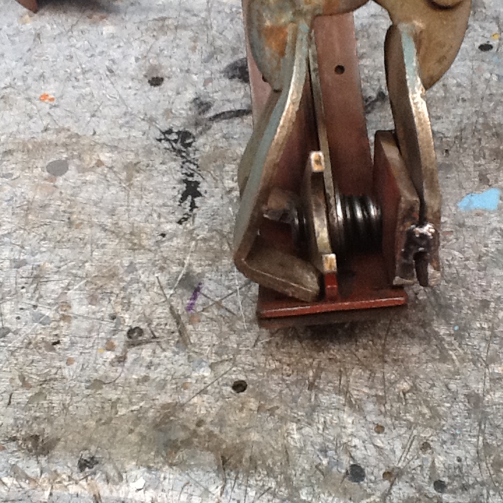

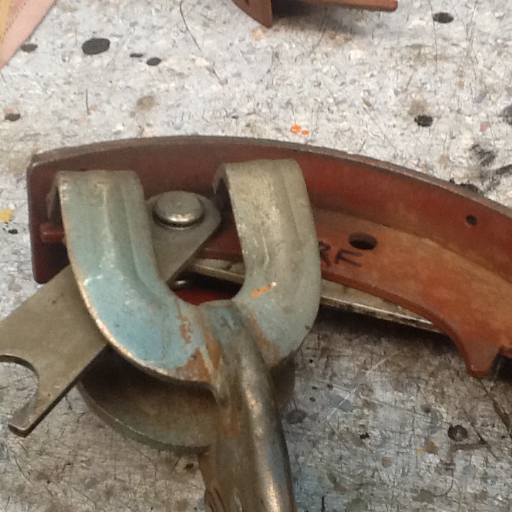

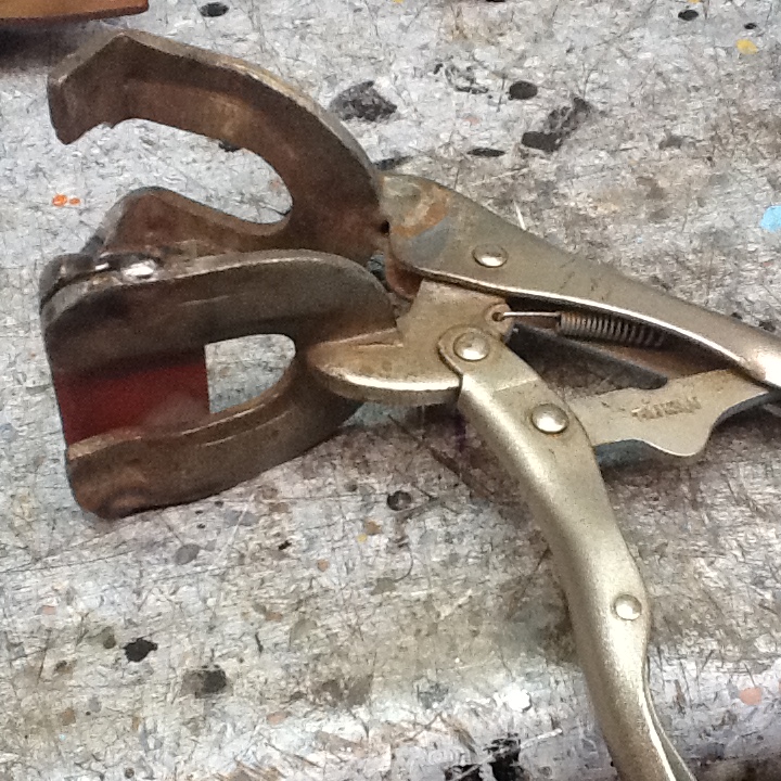

While I was overhauling the brakes I noticed that Holden used the same circlips to hold the shoe locators on as Chevs of that era. I had made this tool while doing some brake jobs on early Chevs and Pontiacs, so it came out again with the Holden. They are a bit of a bugger trying to compress the spring and get the circlip on. This is the tool I modified to make the job a bit easier. It started off as a cheap welding clamp, which wasn't much good for the original job, but I hung on to it "just in case". A short bit of strap was tacked across the bottom jaws, and the corners ground down to roughly match the curve on the inside of the shoe.
The bit of strap is centered over the spring, and the open jaws straddle the circlip end, so when the clamp is closed, the groove in the pin is exposed, and the circlip can be put on, and peened down. Just make sure the arm is free to pivot when you have the clamp closed.

nice work mate, make a fiddly job lots easier !
