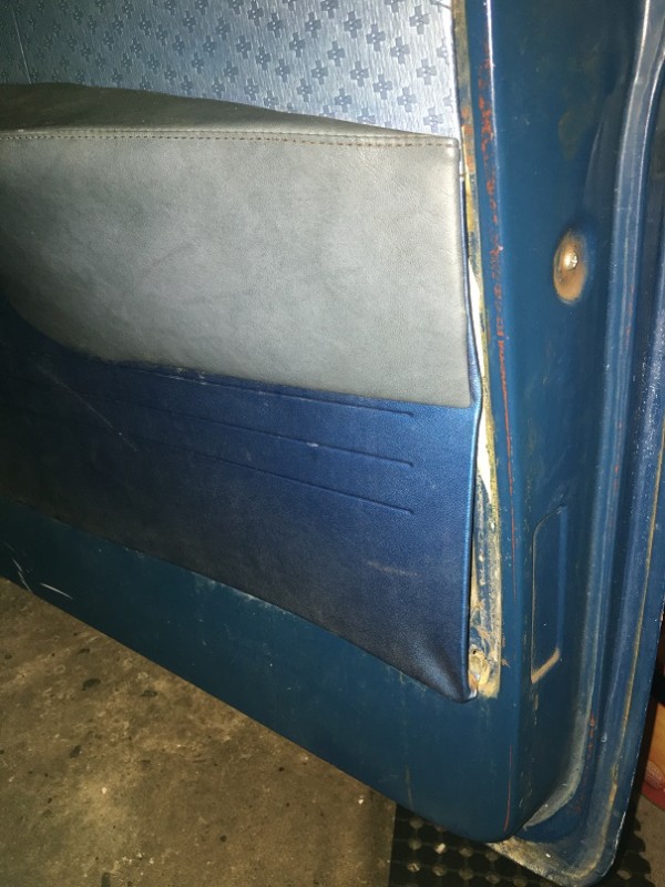

Hi all.
I'm ready to replace my door seals....so I've gotta remove the doors ...so I've gotta remove handles/winders and trim to get to the door bolts on bottom hinge (I think)..... while I'm at it, there's those pesky perished quarter vent seals that need changing while I'm at it.... did I mention the window channels?
But I digress. The original vinyl and arm rests on each door are in pretty good nic, but the woody/cardboardy door cards are warped and need replacing, as well as the clips and plugs. So I have found a new set of cards (available on ebay for $130 --> am I a fool?). My plan is to carefully remove the vinyl from the warped cards and re-attach em to the new cards while I have them off the doors.
Any pitfalls others have found when doing this? Suggestions? Helpful advice?
I dunno if staples or glue was used - till I take em off and look. I know that later model cars have a clear plastic liner to keep water away from the trim (installing door speakers into my Gemini back in the 80's haha). Should install plastic like that for the EK?
There are a couple of small spots on the original trim where the vinyl isn't sitting flat and taut. Is there some way I could get it back to looking good and flush on the new door card. I'll post some pics I think.
Cheers all

Thanks for that. Here's that Trimboard on eBay:
http://www.ebay.com.au/itm/252559948388 ... EBIDX%3AIT
.... and some pics of the original trim as it is now.

Those trims on ebay are Masonite, I have found that they don't curve well which may be a problem on the front door if it has the same complex curve as the FE/FCs, if the trim sits perfectly flat then it isn't a problem. Other trouble I have had with Masonite is that it is brittle and if thump it too hard putting the trims in, or if a clip gets stuck when removing them it will break, so be gentle.

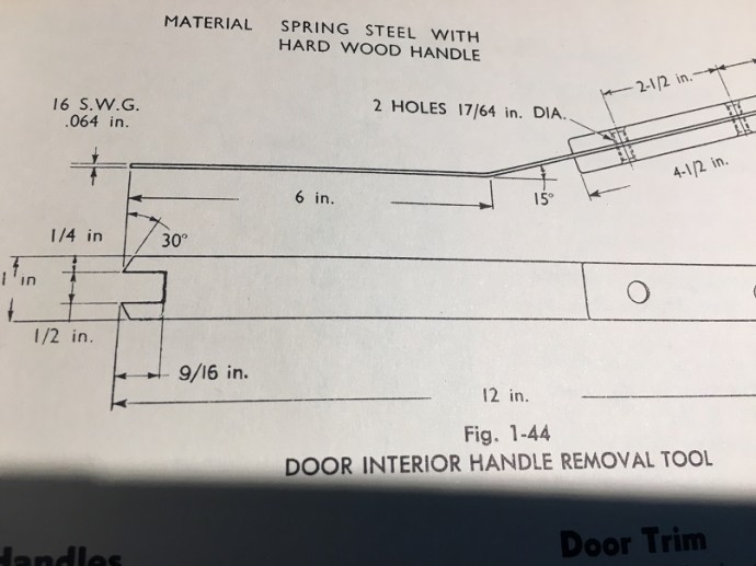

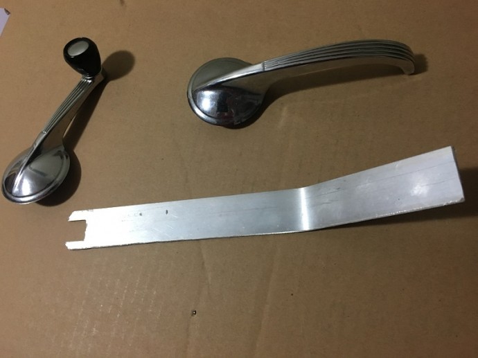

First I had to whip up one of these tools to remove the window winder and inside door opener. This diagram is from the Holden shop Manual.
I tried to use a strip of cloth as someone else suggested but I couldn't manage to jag the end of the wire clip.

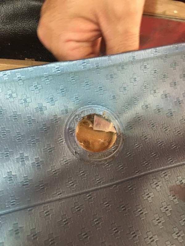

Removing the vinyl from the door cards was done slowly and carefully...easy done with a thin paint scraper. Most difficult where the door handle and winder was.
The old adhesive (looked like the old shoe sole glue dad used to use) came away easily by rubbing the vinyl with my fingers.
Now I'm ready to get some of that spray adhesive and thin foam and re apply both to the new door card.
