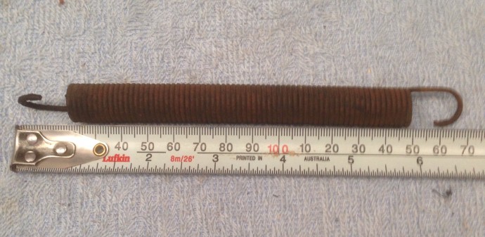

Hi Folks
Details of a spring off my Dads original FB. Wire dia is 15 swg or 1.5 mm. Spring dia is 15 mm. 170 mm long overall
- image.jpg (49.43 KiB) Viewed 1689 times

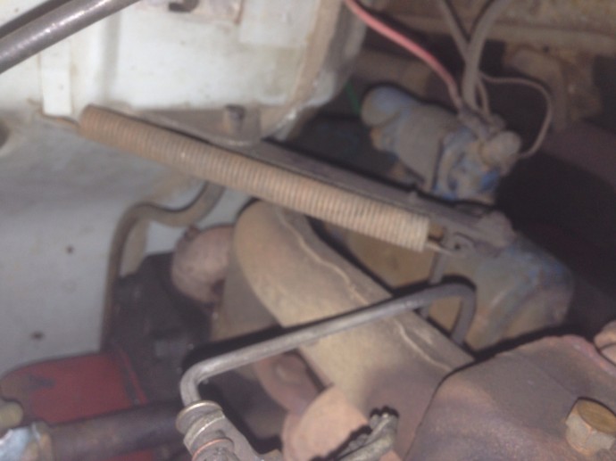

Re: Spring measurement needed
In the Shed wrote:Hi Folks
- image.jpg (69.94 KiB) Viewed 1687 times

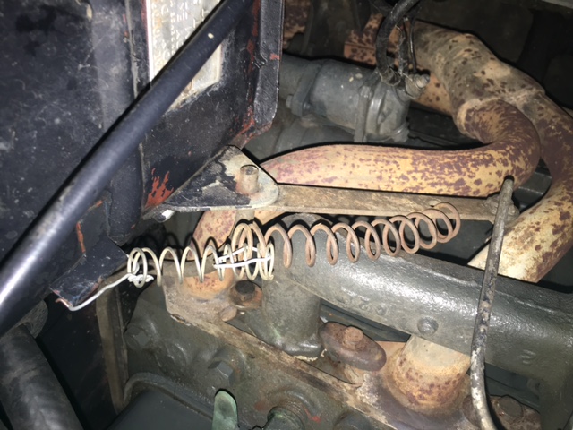

Those springs certainly beat mine hands down! Thanks for your help everyone.
- upside down pic sorry
- IMG_5002.JPG (134.32 KiB) Viewed 1671 times
