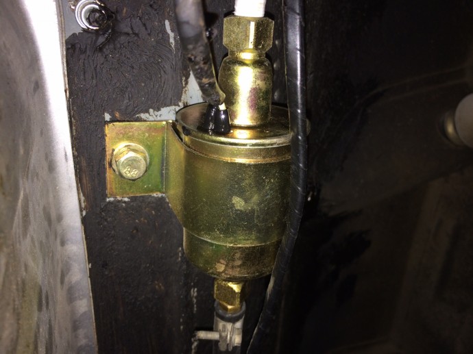

Anyone able to identify this electric fuel pump for me just by looking at it. I need to replace it as it appears to be leaking out of it's electrical connection that leads into the pump. I haven't removed it yet to see if any other markings, as I was hoping to get a replacement and do it all in one hit.
Lift 3.JPG (72.71 KiB) Viewed 608 times
Lift pump to surge.JPG (88.07 KiB) Viewed 608 times
It feeds from my fuel tank to a surge tank for a V6. If it can't be easily identified, what kind of PSI should I look for in a replacement pump to feed the surge tank?

All good folks, looks like it is a universal marine pump according to evilbay and the flow rates are close to what I calculated. Think I might change it out for a Carter or similiar quality. Sorry to waste time and bandwidth :erm:
