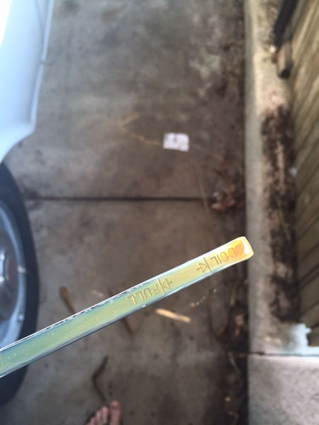

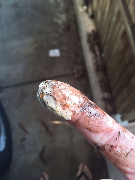

Attached are some pics of my finger in the oil at top when it was cold. (it looks bad) dipstick ( over full).

- oil at top. Cold. before start up

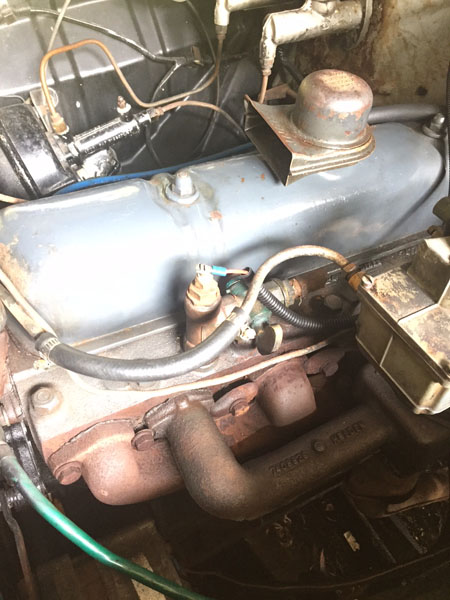

- engine - old girl

- dipstick - full and a bit mily

Are you losing water from the radiator as well? Sounds like head gasket or cracked head if your having trouble getting it to run properly i.e. water is effecting proper combustion.
Could also be holed welch plug behind the sideplate as well if its not related to the running/backfiring issue.
Sometimes older high mileage engines would suffer with milky sludge in the rocker cover due to excessive combustion blowby. Yours sounds like you have water leaking into the crankcase.
What ever you do please stop running it. Water damages engine bearings very quickly. Combustion pressure and resultant forces on the conrod turns the water into steam from the impact forces. The change of state from water to steam coincides with the water/steam expanding to 9 times of the volume. As it tries to escape it splays the bearing shells. After that you've got corrosion issues if it gets that far.
Pull the side plate and have a look for leaks (pressure test the cooling system). After that I'd pull the head and have a look.

I am with Craig. Is it missing at all? If not it may minimise a leaning towards a head gasket / head even though the gasket or head may only be compromised between the oil gallery and coolant galleries.
I would lean towards a welsh plug or two based (or three) on your description. Even if it isn't when you go to check I would definitely replace them if they haven't been replaced in the past with brass ones. They will only cause you a headache down the track. If it gets to the point of getting a pressure test done and it confirms a head gasket or head, I would also replace the welsh plug on the head as well. Ken McLean from FE FC Holden club would also suggest that if you have the side cover off and doing the welsh plugs that you take the opportunity to get a pressure cleaner and go berserk cleaning out he water jackets. Once completed complete a reverse flush on the cooling system.
Don't run the motor for the reasons Craig mentions but also if the oil is over filled as you are describing you will blow gaskets and seals as well. A job down the track I am sure you don't want to do, especially the rear main.

Agree with Rod and Craig - looks like a blown head gasket or cracked head.
The other thing that comes to mind is that the oil level is waaaaay overfull. At that level, the crank acts like a mix master, throwing oil around a lot more than normal. It will aerate (foam) the oil really quickly, leading to bubbly oil and a loss of oil pressure (the oil pump doesn't like pumping foam). This is probably why the idiot light came on.
It could be two separate events (blown gasket and overfull) though as that oil is very white. Hard to tell though as the engine has been sitting idle for a while. If you don't fancy tearing stuff down, start with a pressure test. Your local radiator mob can do one (would need to get in fast though as they will soon be closing for Christmas).
