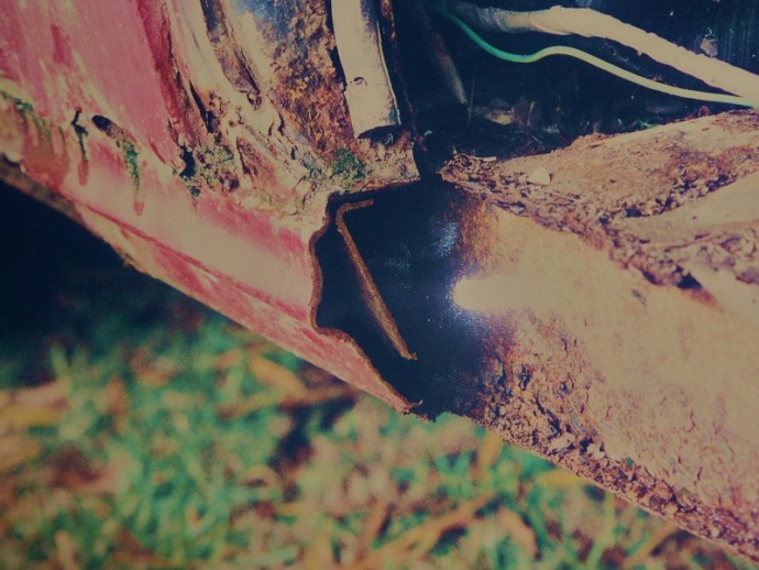

Please excuse the quality of the pic it's a copy of a photo I took over twenty years ago of an Ek parts ute I had at the time, though it clearly shows the inner reinforcing member. As far as I know this inner member was only fitted to the commercials. A real good place for dirt and rust to hide!

Thanks for the reply oz EK. Anyone seen this in sedan or wagon? Not hard to replicate this when fitting new sills. Just need to be very sanitary and allow for drainage.

Looking at an old Holden master parts catalogue the reinforcement is listed as item # 45 group 12.934. Interestingly its not listed for the FE/FC utes, nor is it listed for the FB/EK sedan or wagon.

That's some nice work your doing in your thread!... When I get sometime I'll read the rest. The reinforcement in your pics is listed in the catalogue as item # 41, group 12.934. The reinforcing member in the commercials runs the full length of the sill.
