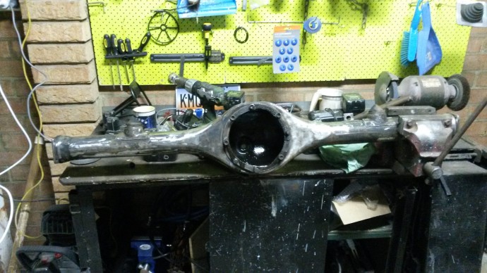

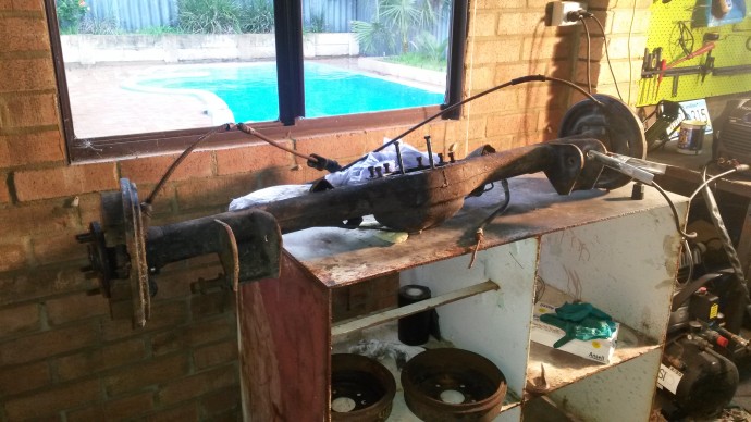

Gday blacky ,
Ive shaved the lj diff down close call nearly put the grinding disk straight through the diff breather which hides under the upper control mount and i have ordered some spring perches , if they are no good ill use the fb ones.
Is there a degree to look for for the pinion angle, i was going to remove the loweing blocks so the fb back to std then put a digital level on the std pinion and go for the same degrees with the lj pinion.
Edit, everybody like pics :D

Posts: 14319
Re: torana diff hand brake set up in fb ek
That will work , easiest way to do it .
