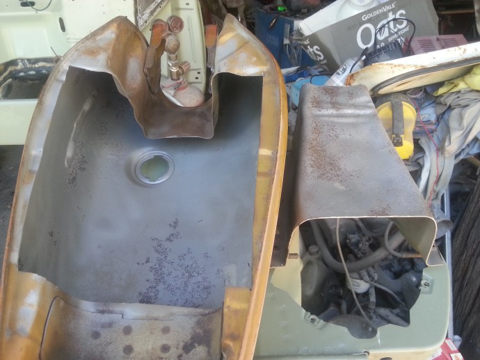

I do a heap of tanks. You probably dont want to hear this but if you have a tiny pin hole the other side will be rust about ten mm in diameter. I usually split the tsnks and get them sandblasted Inside and the weld them back togetber repairing the holes.
I did a bike tank that way today.
When you use the tank liner kits follow the Instructions to the letter. Having said that ive have a few fail and then you have another pro
blen trying to get the liner out.
I dont like using the liners but I still do them because I cant think of another way of sealing the tank from rusting after its welded.
Its labour intensive and expensive. A tank liner kit for a bike is about $80. A car one is more than double that plus all the labour

Hey bootlegger - I am totally prepared for the worst with this. Its been leaking for a while. I can't work out how to post a pic here?
After having the car warmed up and idling for about 10mins I noticed it coming through a couple of pin holes near the original spots I had patched with epoxy (knead-it)
The patched spots are about the size of a 20cent piece. Would replacing the tank be a better alternative? Thanks for all the suggestions :)
