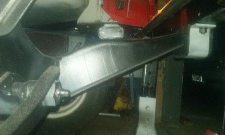

That last photo looks WAY wrong - has to be your problem
Re: RENNO's Rebuild / Resto
Lex,
Craig is right - definitely engine tilt:
Top of breather: You get 35mm, I get 50mm. 15mm out.
Front of rocker cover: You get 55mm, I get 80mm. 25mm out.
Fan tip: You get 10mm, I get 60mm. 50mm out.
The FB front outrigger is nearly flat (turn your head to look at the photo below... it's on a tilt). Compare the top of the outrigger to the straight lines of the pavers behind it.
Sound like you may need to cut and shut the mounting plate to drop it.... or if there is not enough meat, change the outrigger
Looking at that I'd say its the wrong front end. The dish is too deep in the centre as the gap is huge between it and the sump. Something looks to have chopped or modified with the front end or outrigger. Has the outrigger been welded on also? Should only have 4 rivets and two spot welds on either side.
This looks more and more like a FX/FJ front end that has had the wishbones changed and outrigger (not sure if its dimensionally possible to do that.....been too long for me).

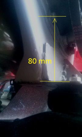

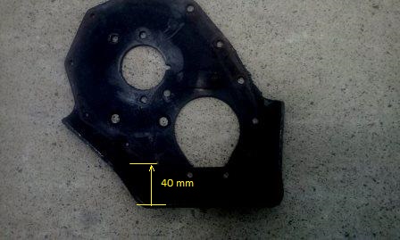

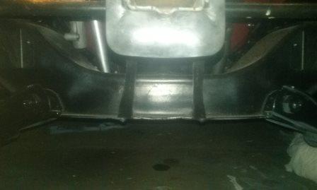

OK........
I have compared the the cross member that came out of the stock 138 FB Sedan I stripped down and the cross member that came with my project car, they're identical, original with rivets and spot welds as in pic.
I think the problem can be solved by replacing the 132 engine cover plate with the 138 cover plate. As you can
seeby comparison the distance between the bolt holes and bottom of the plate are 80mm and 40mm respectively. This displacement will then give me realistic distances.
The next question is, is the 138 plate a simple swap with the 132? .....Let's see
- Cross member (outrigger with project)
- CAM00420.jpg (21.42 KiB) Viewed 2261 times
- Cross member (outrigger out of FB Sedan with stock 138)
- CAM00428.jpg (27.18 KiB) Viewed 2261 times
- 132 Engine cover plate (hole to base measurement) 80mm
- CAM00431.jpg (29.92 KiB) Viewed 2261 times
- 138 Engine cover plate (hole to base measurement) 40mm
- CAM00429.jpg (45.33 KiB) Viewed 2261 times
Simple, no. Painful, yes. It's a cam-out, half the motor in pieces exercise from memory. Not a bad idea to get rid of the fibre timing gear (if it still has one) while you are there.Lex68 wrote:The next question is, is the 138 plate a simple swap with the 132? .....Let's see
Better than having to find a new front cross member or outrigger though.

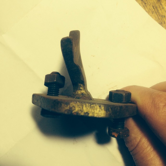

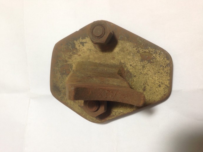

Hi Folks
An elderly mechanic passed on some home made tools when he worked on grey motors for a job. This one pictured below allows you to replace the timing gear whilst the camshaft remains in place. Remove fuel pump and install this in its place. Provides support for the cam whilst you drift the timing gear on. Works a treat.
Hi Folks
- image.jpg (50.04 KiB) Viewed 2144 times
Man that is one clever tool
. Beats the hell out of using a screwdriver.
Can definately see the practical application of this tool,
The post extending from the plate conforms to the shape of the shaft and sits behind the lobe thus preventing
the rear end of shaft punching out the welsh plug.
Thanks for your input
Cheers Lex
Cheers Lex
