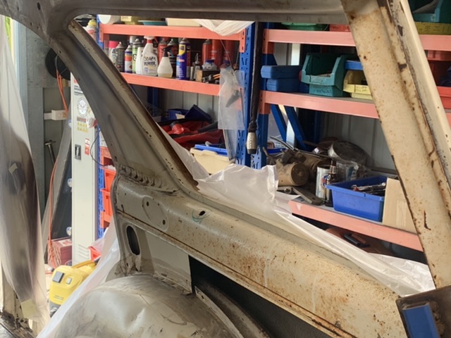

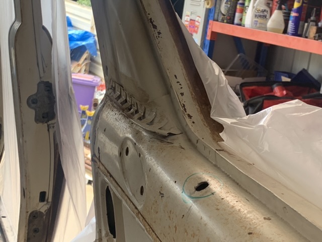

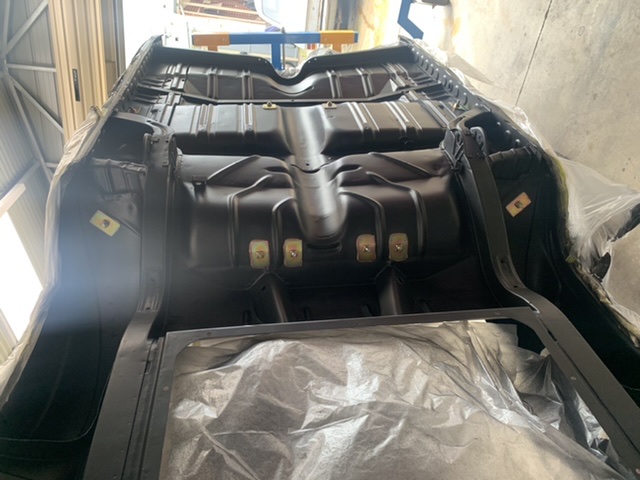

I am currently fitting the seatbelt mounts in my rig.
A friend who is a trimmer came and marked out where to drill the holes but there wasn’t any calculations or reference to codes and I am wondering if this arrangement is going to be ok/legal.
2 pics below of the floor mounts and 1 of the hole drilled behind the C pillar / below the rear side window.
Rear top of the belt will be mounted on hole circled in green.
Do you guys think this will be ok?

My set up will be the same as this but is this configuration going to cause me any legal drama if inspected?
