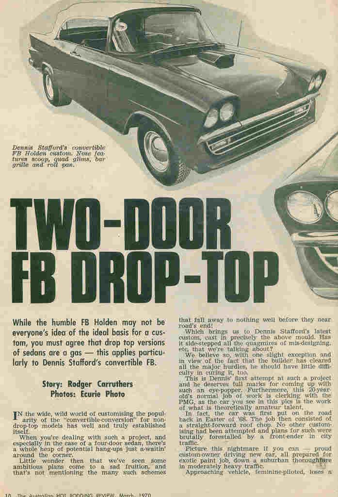

Sweet, remember seeing in SA a red EK with white vinyl roof, looked ok but not a fan of the roofs.
I've seen a yellow and a nice metalic blue convertable but everyone does them differently.
Good to see another.

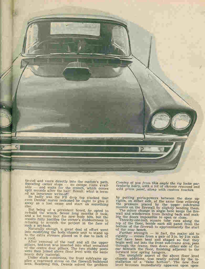

Body strength seems to be a real problem when the roof is removed on any vehicle, this car and mine seem to have similar body strengthening.

the strengthening in mine was good triangulated sills and chassis connectors, you could jack up opposite front and rear corners and all 4 wheels woul come off the ground pretty much even

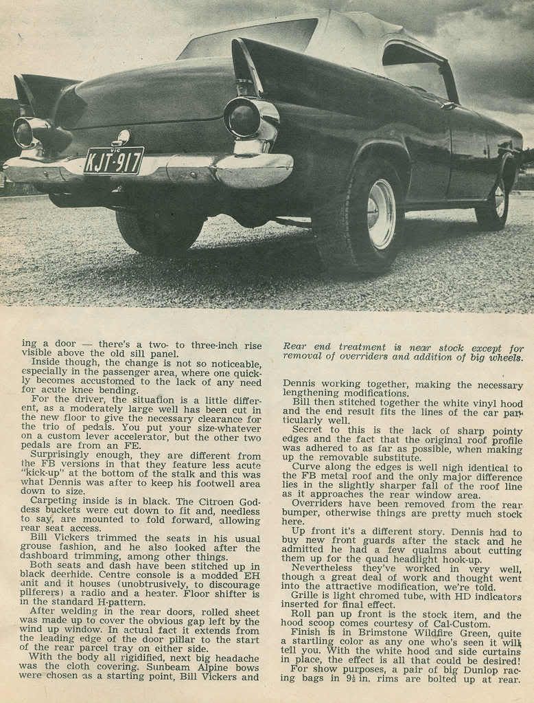

That is an extremly good convert roof for a one off custom
Proper folding bows with a headed that fits the screen shape and by the looks good sealing on the side windows.
