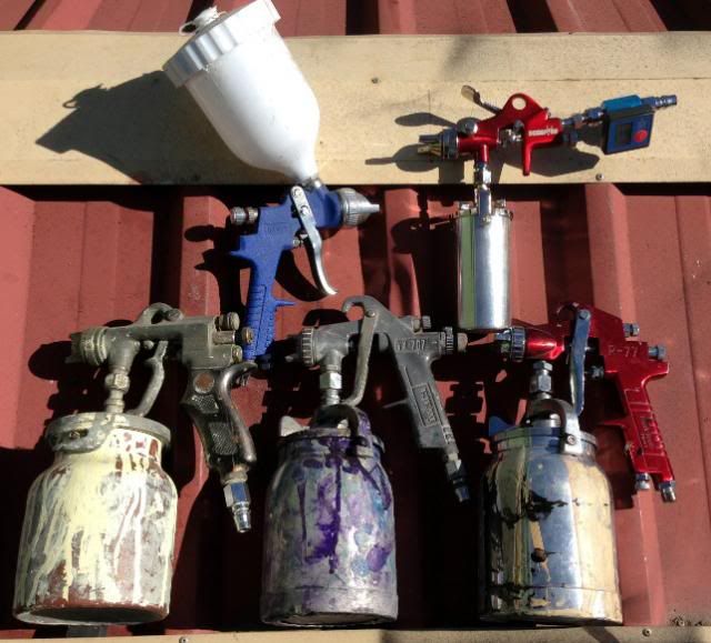

I have a few guns now.
Some in better condition than others.
One my son used a few years ago, and when opened was still half full of paint.
Which ended up on the floor of my garage, because I didn't expect it to be full of paint.
Anyhow current guns.

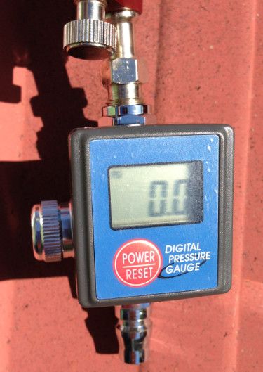

And this was the pressure gauge/regulator that I use on the guns.
Fairly quick to swap it over on each gun, but as you said Rosco, once I know the pressure at the gun is in range, I probably don't need it.
Just need to check that the pressure doesn't change as I adjust the screw. Otherwise it could be quite different when removed.
Its not difficult to swap, just screws on and screws off, so I might leave it in place.

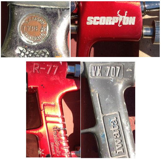

Unfortunately the Tradetools is the newest and probably the best condition, with a 2mm.
It's what I will probably use for the body in the end.
The gravity feed gun doesn't even have a name, I think it was a SCA (supercheap brand) and I found it difficult to use. It was also a HVLP gun and I'm not sure it if needs to have different pressure to the others.
I only got it for doing the roof because I thought if less likely to hit to car with the gun.
