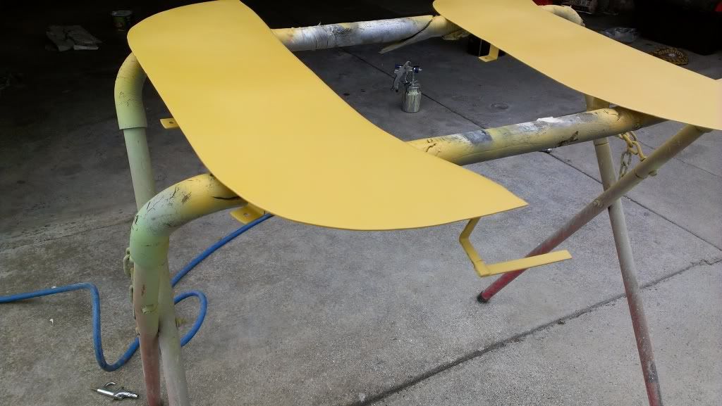

Heres a pic, not even sure if they are genuine or repos.
I didnt get any bits with mine so really unsure about the fitment.
They obviously need a rubber but apart from that not real sure.

Look like repops.
Mine are originals (as far as I can tell) and have a lever-and-catch arrangement on the back of the spats at the end that is closest to the rear of the car. You install with the lever facing up, and then swing the lever down towards the front of the car as the catch rises and grips on the inside of the wheel arch. One side is a doddle to fit, the other is a pig. Never worked out why.
My understanding is that repops don't have the lever, and kinda spring-fit into place instead. Can't tell the difference once they're on

You need to flatten those tabs out. With the edge rubber fitted and the wheel off slide the spat into place.
Then fold the tabs up to fit nice and snug.
You might need to play with the fron bracket to sit nice in the dogleg part of the wheel arch.
At the rear there should be a sort of spring loaded clip which holds it all tight.
That how i fitted cals repo spats.
