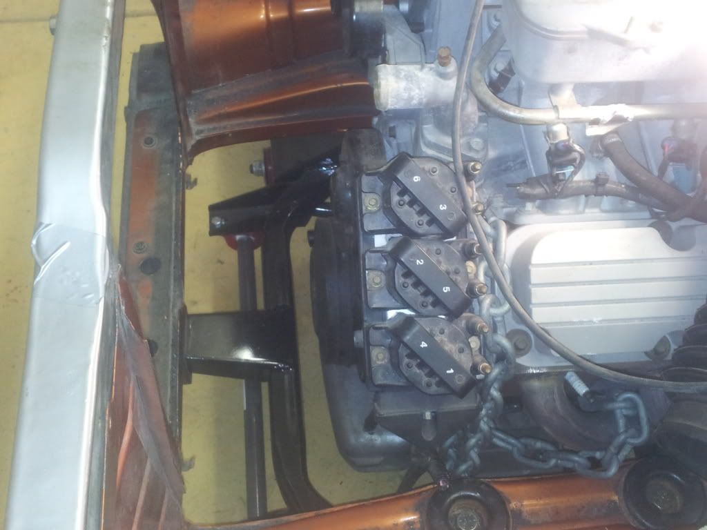

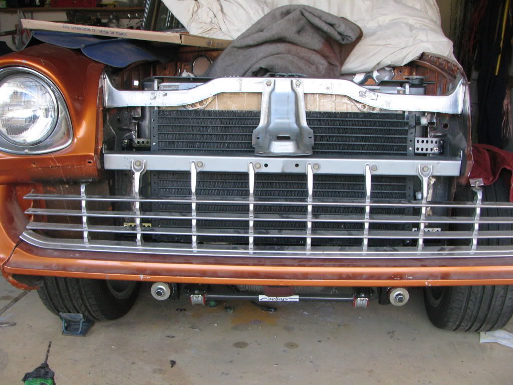

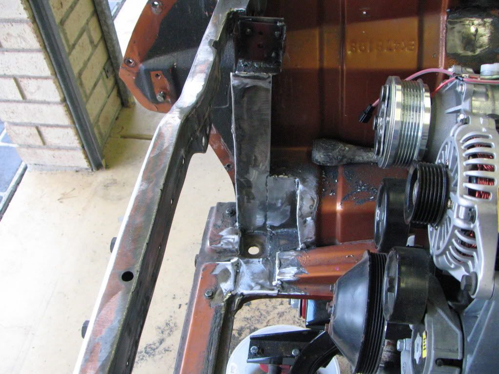

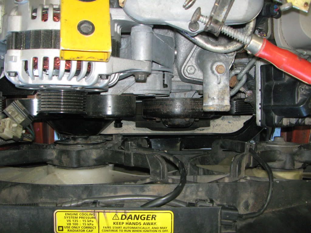

put the engine (no box) in just to check some things out
like the vt radiator & fans tight fit
and a bit of cutting

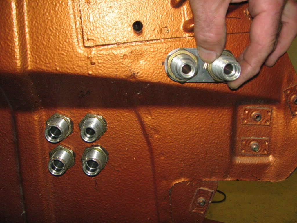

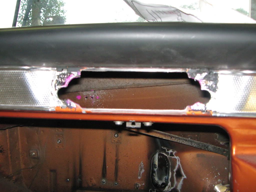

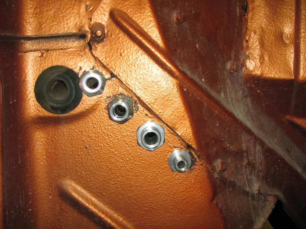

decided to put the wiring through the guards,at the same time as the air con hoses go through
so the guards are sitting in the spare bedroom for xmass

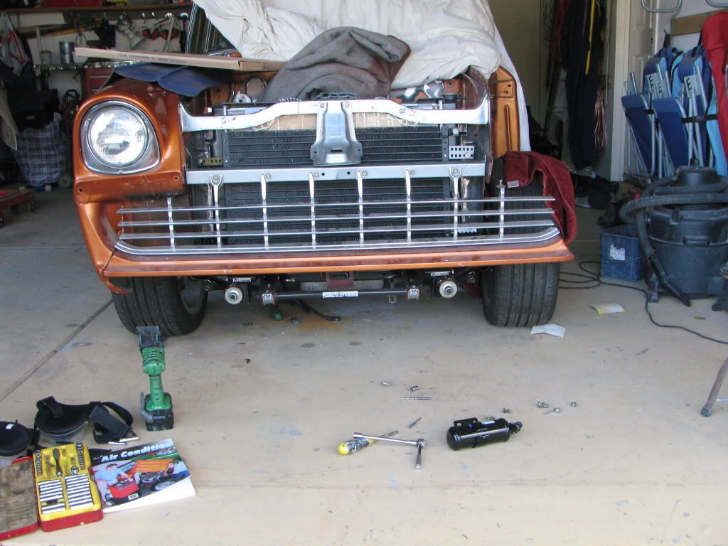

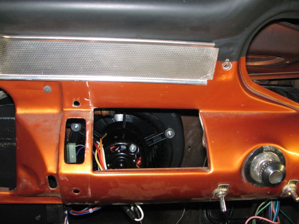

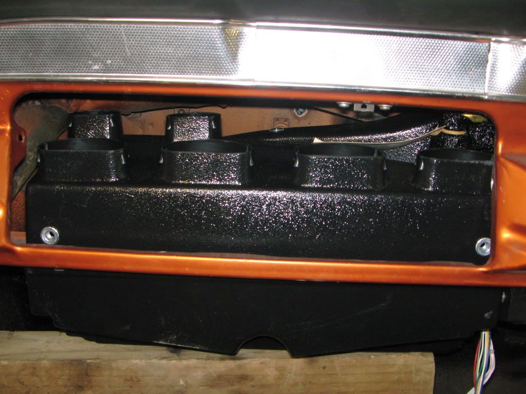

fitted the air con today to see where i'm going with the hoses and wiring

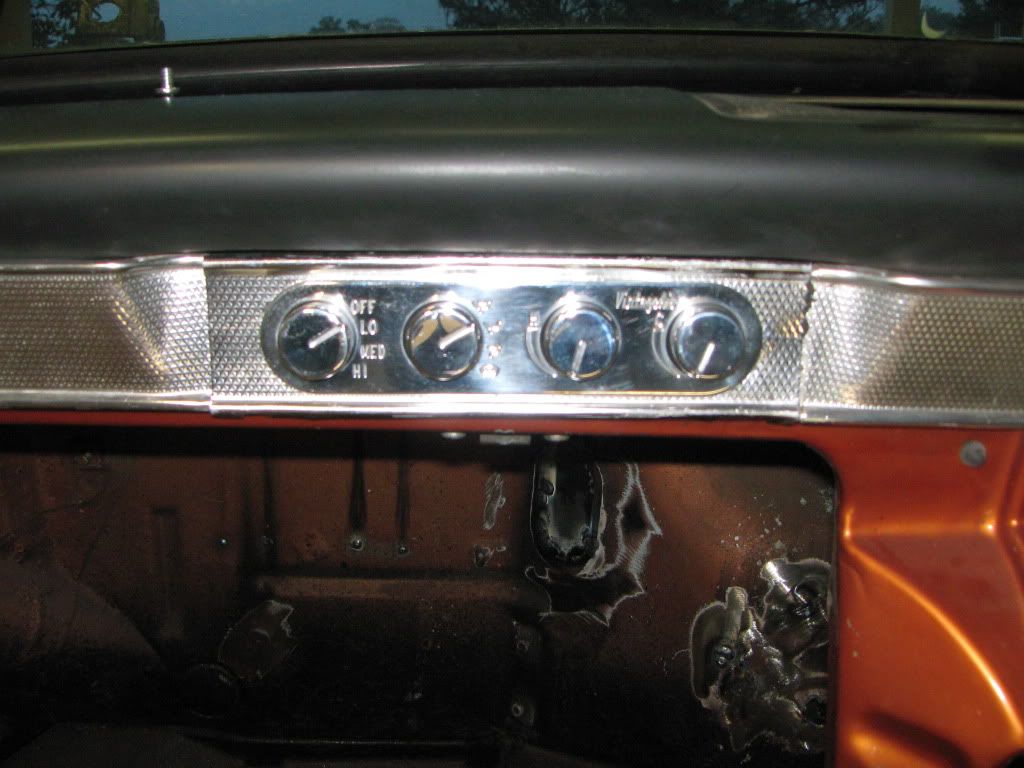

i ended up putting the bolt's through the bottom of the glove box support
the ash tray and air & heater controls still fit in and the air duck can still work
and fitted the controls for it
had to add some metal so it would fit
now i can do the hoses and heat restaint stuff and wiring

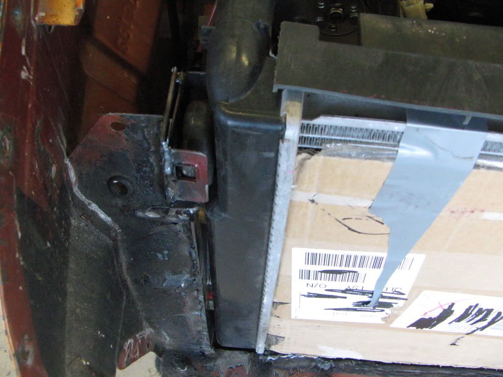

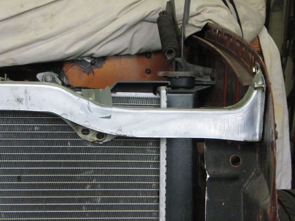

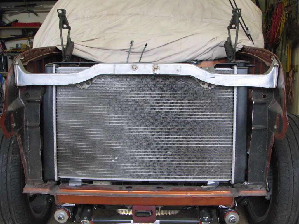

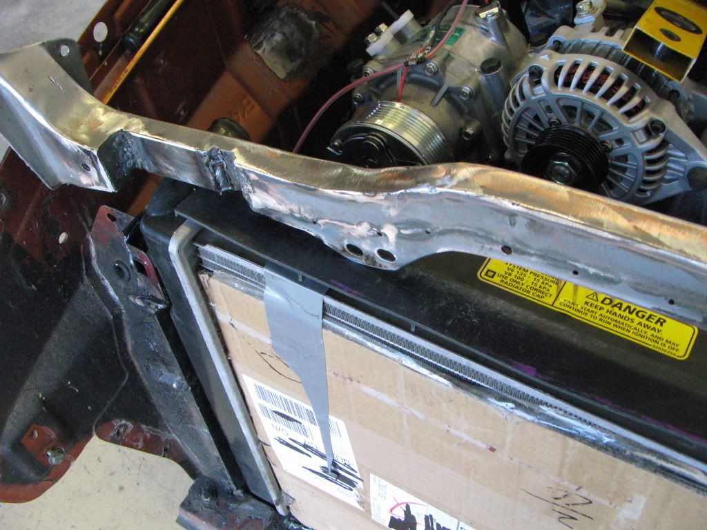

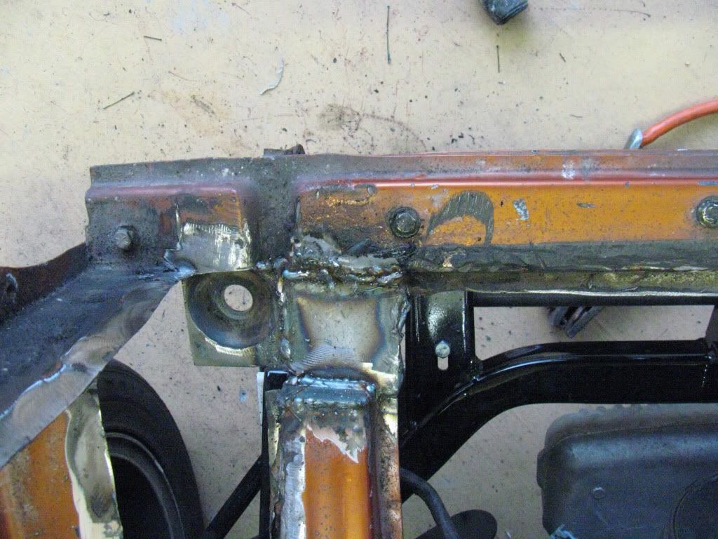

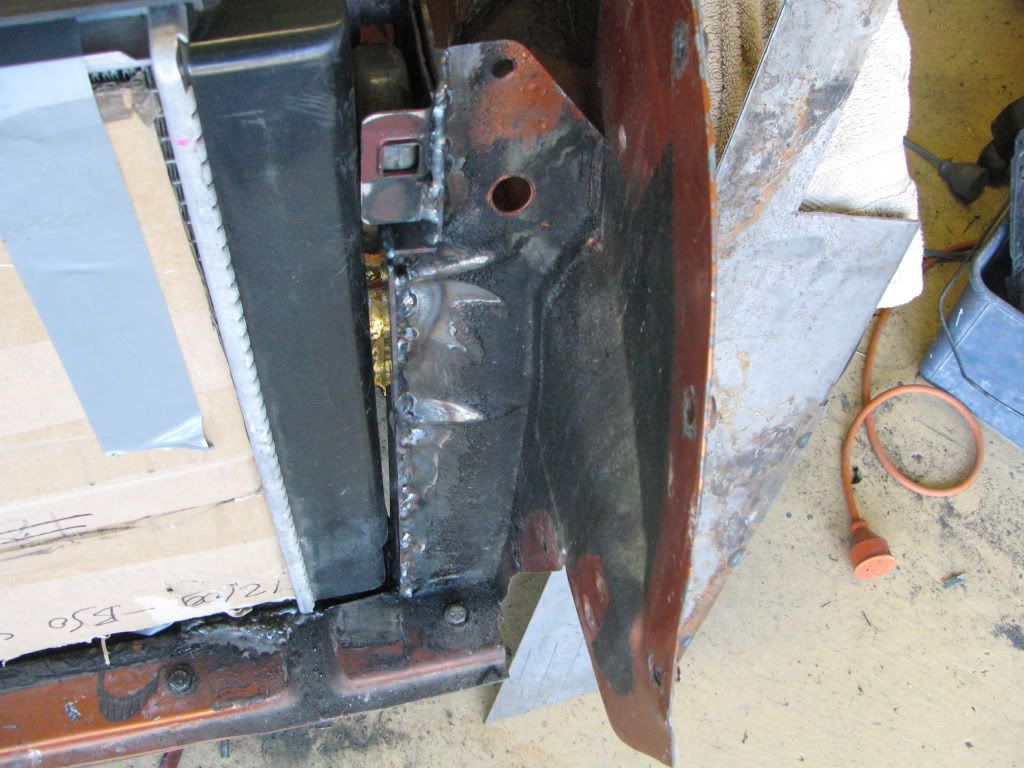

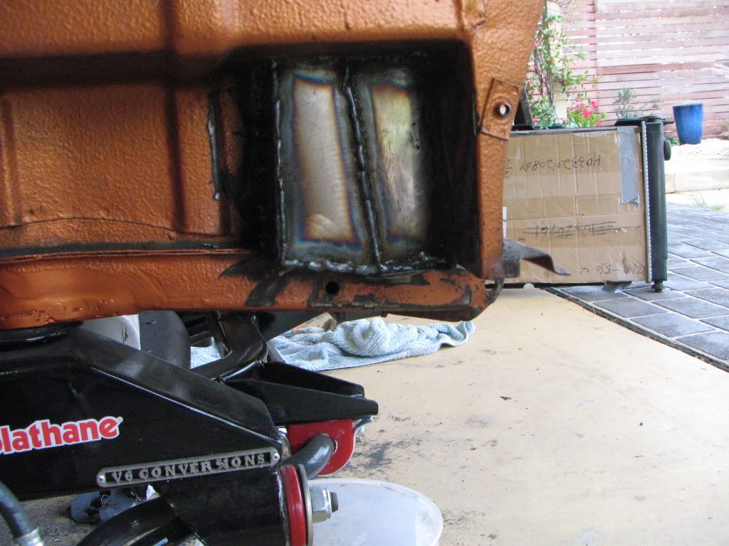

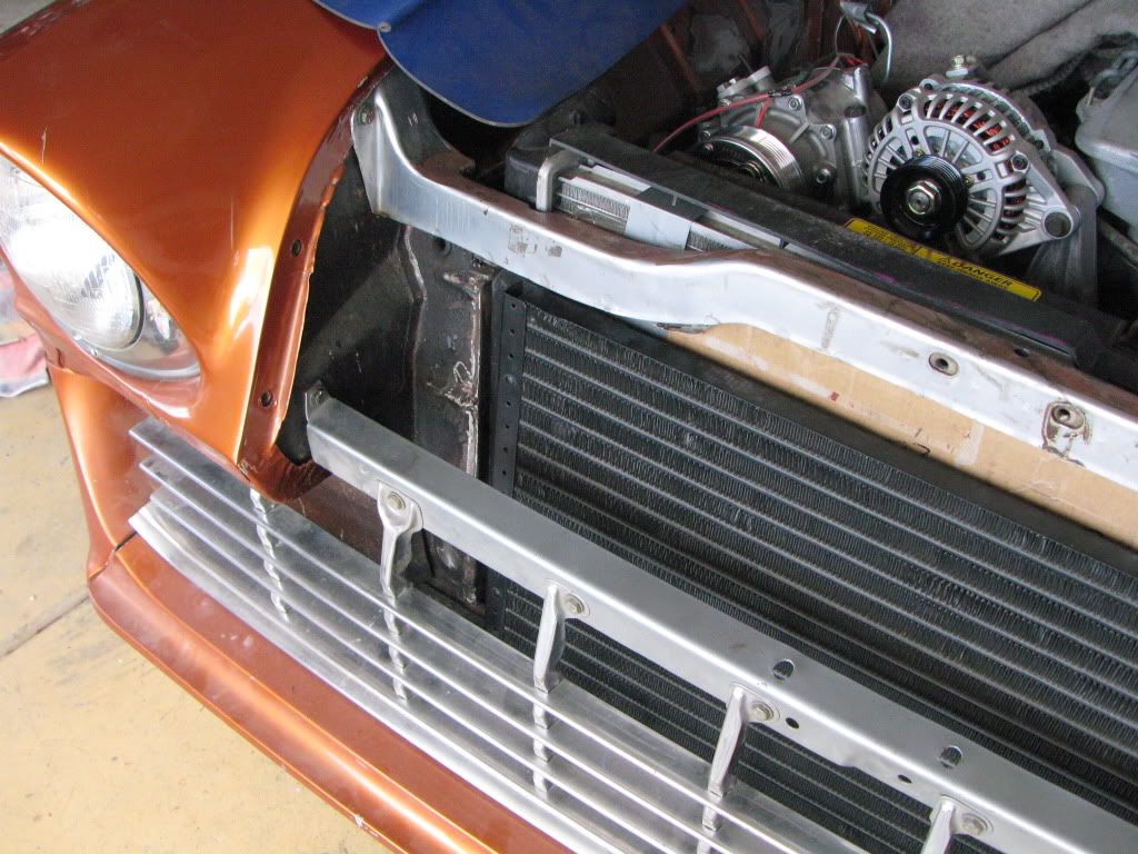

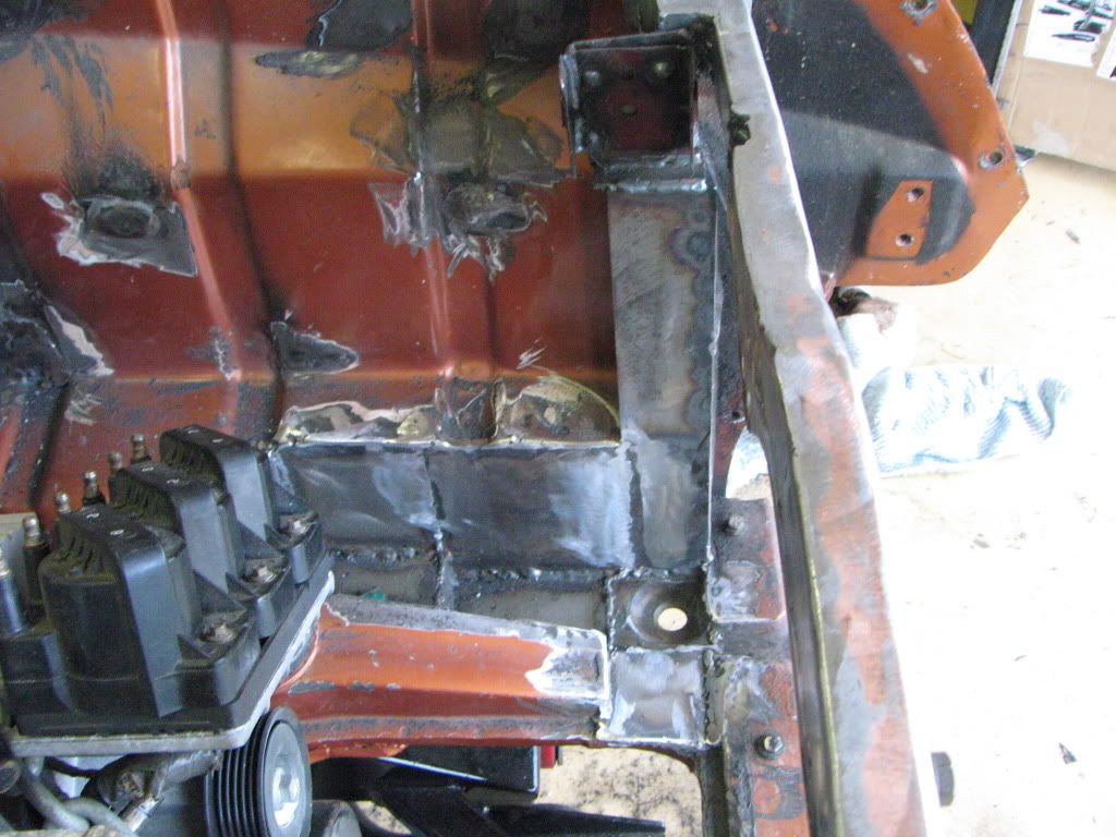

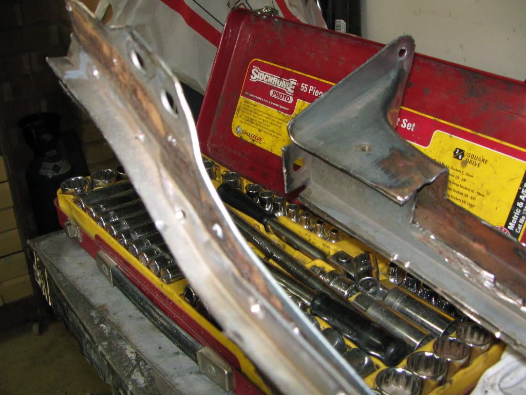

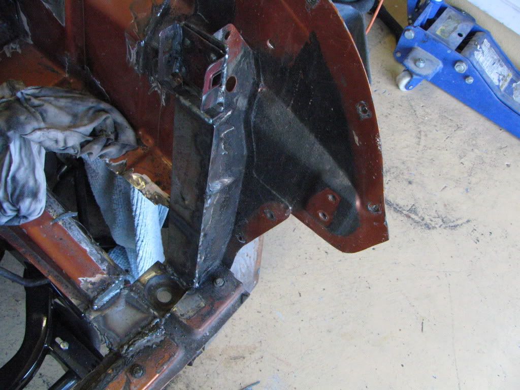

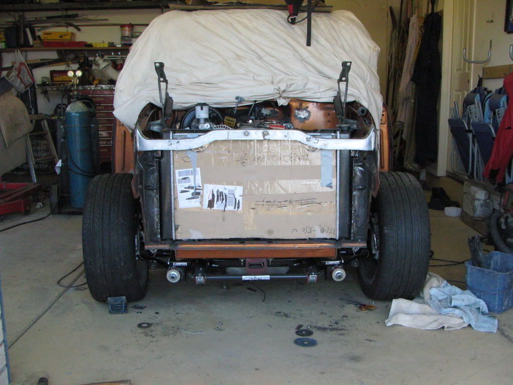

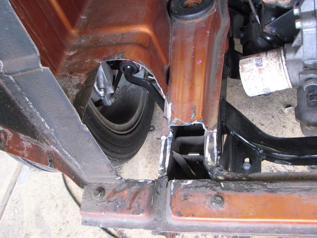

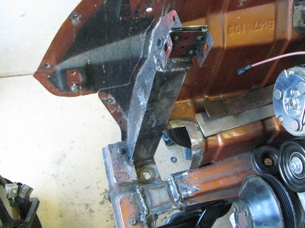

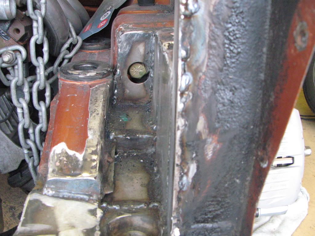

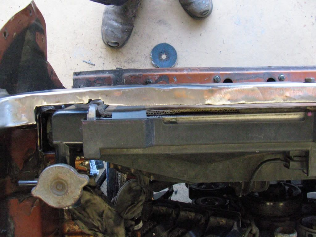

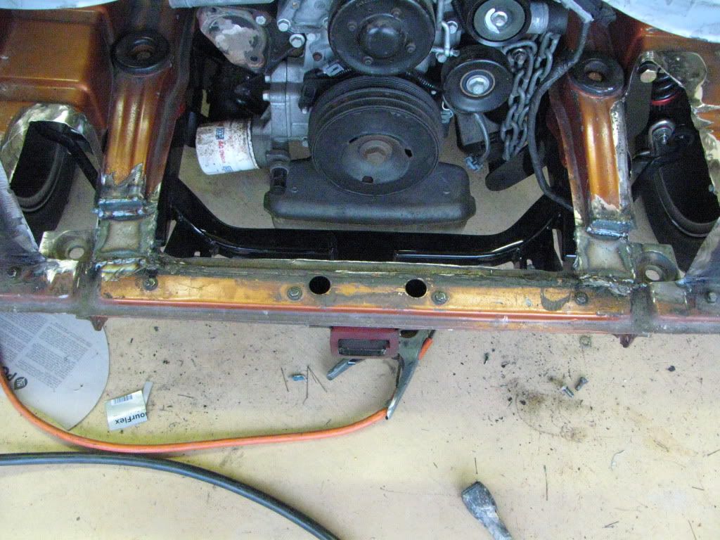

with a few hours here and there i got the radiator done.- minus the grinding hope to get that done tomorrow

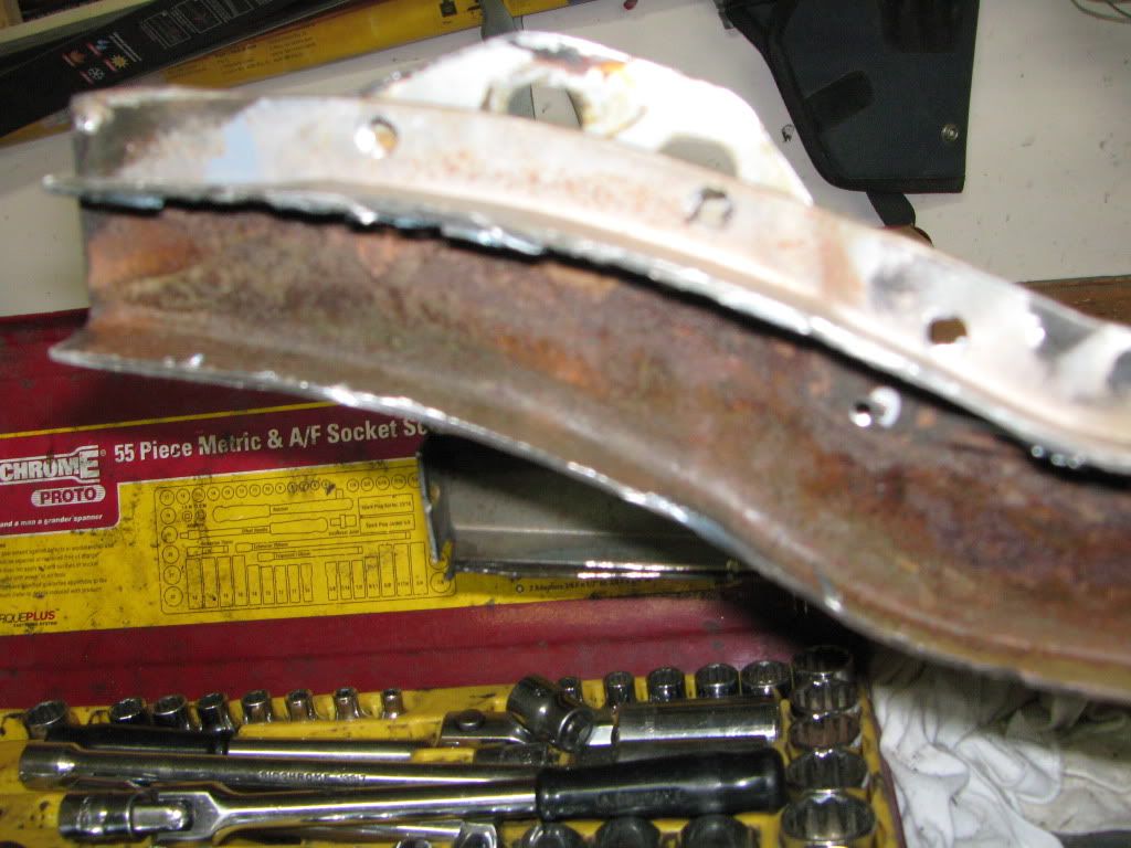

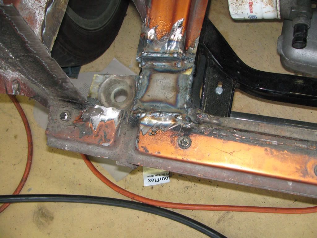

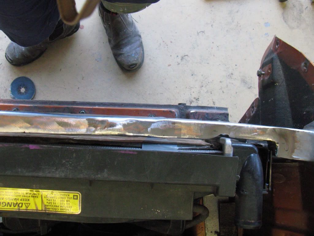

had to cut down the radiator support some 13mm to make it sit more up right,giving me more room
cut the back off and reused it for a nice fit it came up good ( had to cut in a few notches at the ends for it to fit)
got some of the radiator parts to hold it in right - makes life easier

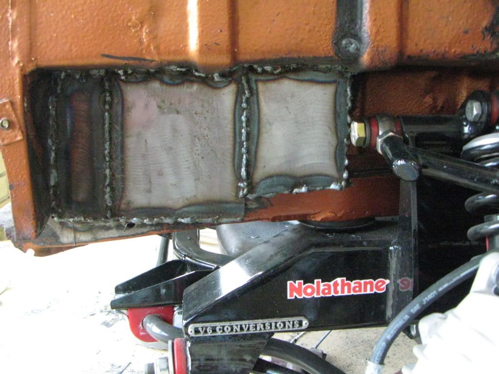

used 3mm steet metal to replace what i cut out, and added, to put the strength back into the front

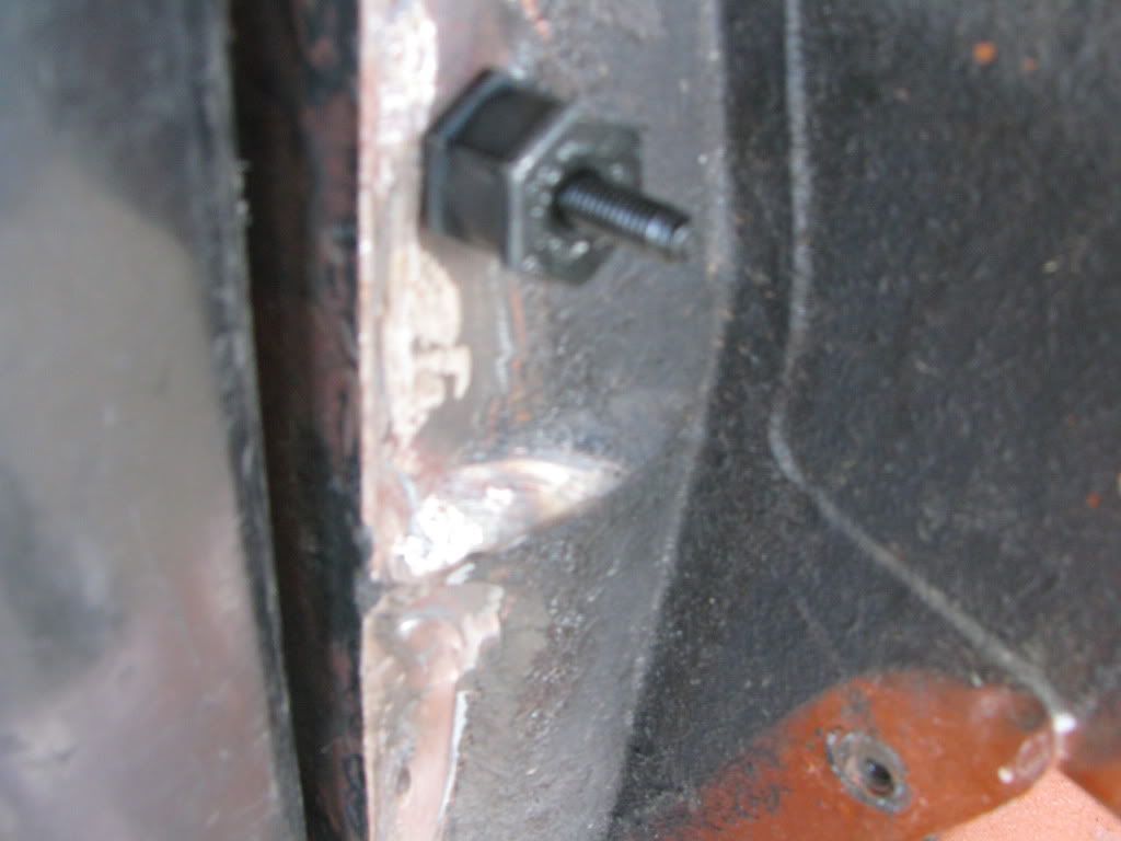

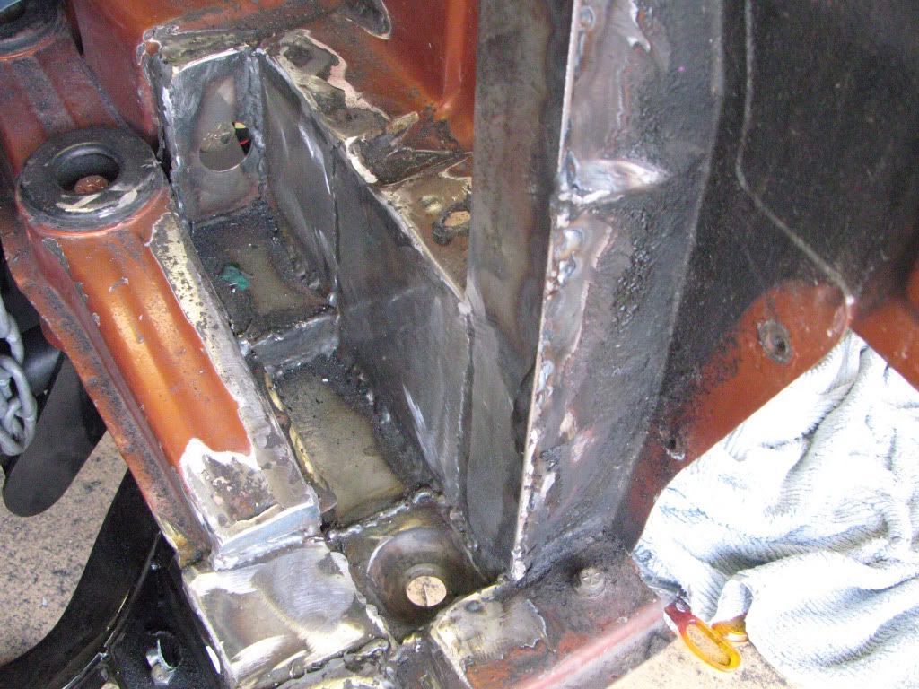

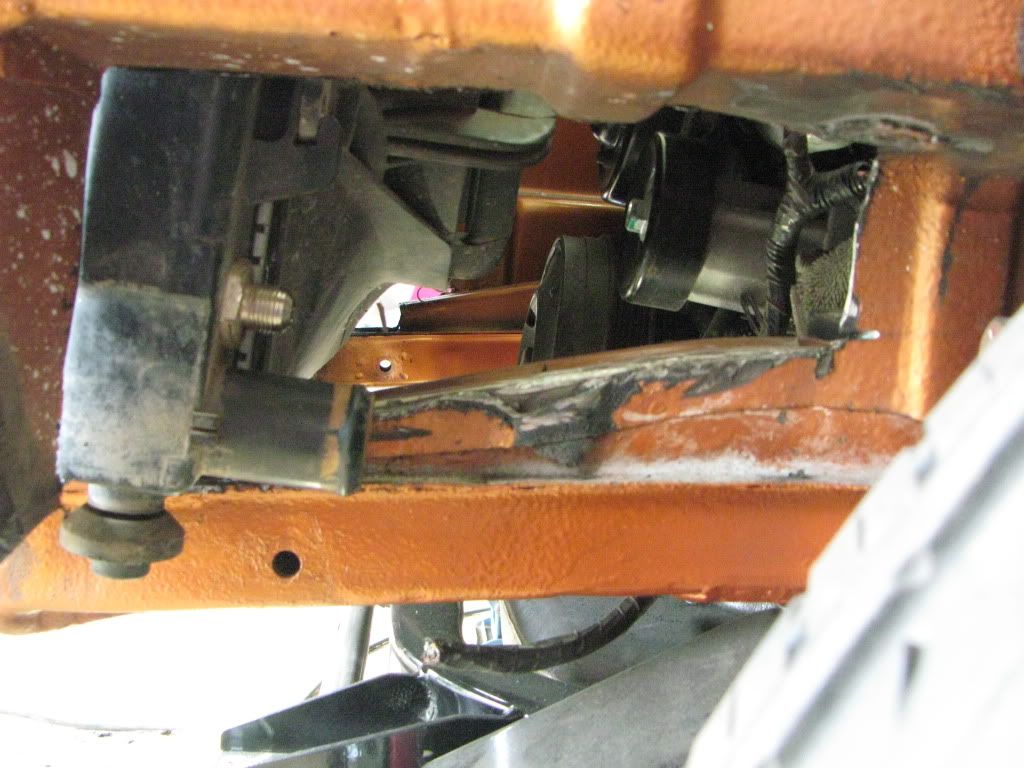

filled in the inner guards in reverse
had to cut a hole so i or someone needed to get to the bolt on the front end

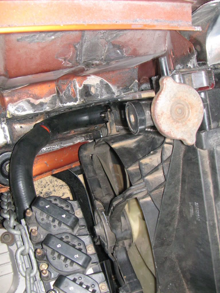

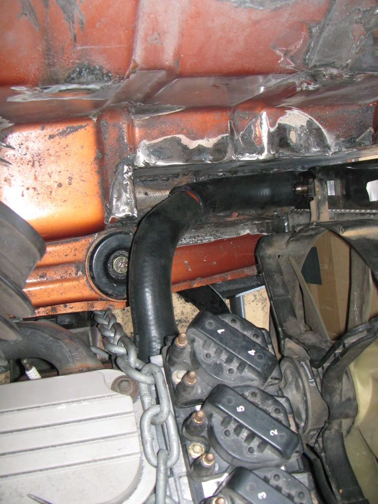

had to cut 150mm or so out of the bottom hose to get to fit (does anyone know what hose will fit) would like to know ???
it all fits nicely and easy now

whats the radiator mate ? i managed to slot the std VN V6 radiator in my with almost no modifications ?
steved57
Posts: 239
Location: Cairns, Qld
Re: Tigers V6 Conversion
Post by steved57 »
Was thinking the same thing. That's an awfully big radiator for a V6 - and looks like a lot of work to fit.
michaeljohn1234m
Posts: 185
Location: AU central coast
Post by michaeljohn1234m »
ekdave1962 wrote:whats the radiator mate ? i managed to slot the std VN V6 radiator in my with almost no modifications ?
it's the std VT V6 radiator,i wanted more area for the air con condenser (radiator) and for when i put my 4.2 supper charged in
michaeljohn1234m
Posts: 185
steved57 wrote:Was thinking the same thing. That's an awfully big radiator for a V6 - and looks like a lot of work to fit.
worked out to be 4 hours to fit love ever minutue of it.
steved57
Posts: 239
Post by steved57 »
Sorry Tiger, didn't mean to sound critical - oops :oops: . To get all that done & dusted in just four hours is bloody good work.
Cheers, Steve

Post by nes138 »
I managed to stuf a VT V8 Radiator into my FC using similar method. Although I am running a 5Lt V8 and my standard thermo fans dont fit. I had to buy a 10" and a 12" slim fans to fit.
I think the vt v8 top hose upside down will fit your bottom hose. They're heaps shorter.
What did the engineer say about the rail changes?
michaeljohn1234m
Posts: 185
nes138 wrote:I managed to stuf a VT V8 Radiator into my FC using similar method. Although I am running a 5Lt V8 and my standard thermo fans dont fit. I had to buy a 10" and a 12" slim fans to fit.
i'll try that hose, and i haven't talked to an engineer as of yet, i think it should be fine as i cut it in front of the engine,I'm now too busy back at work to do anything,except order the things i need.

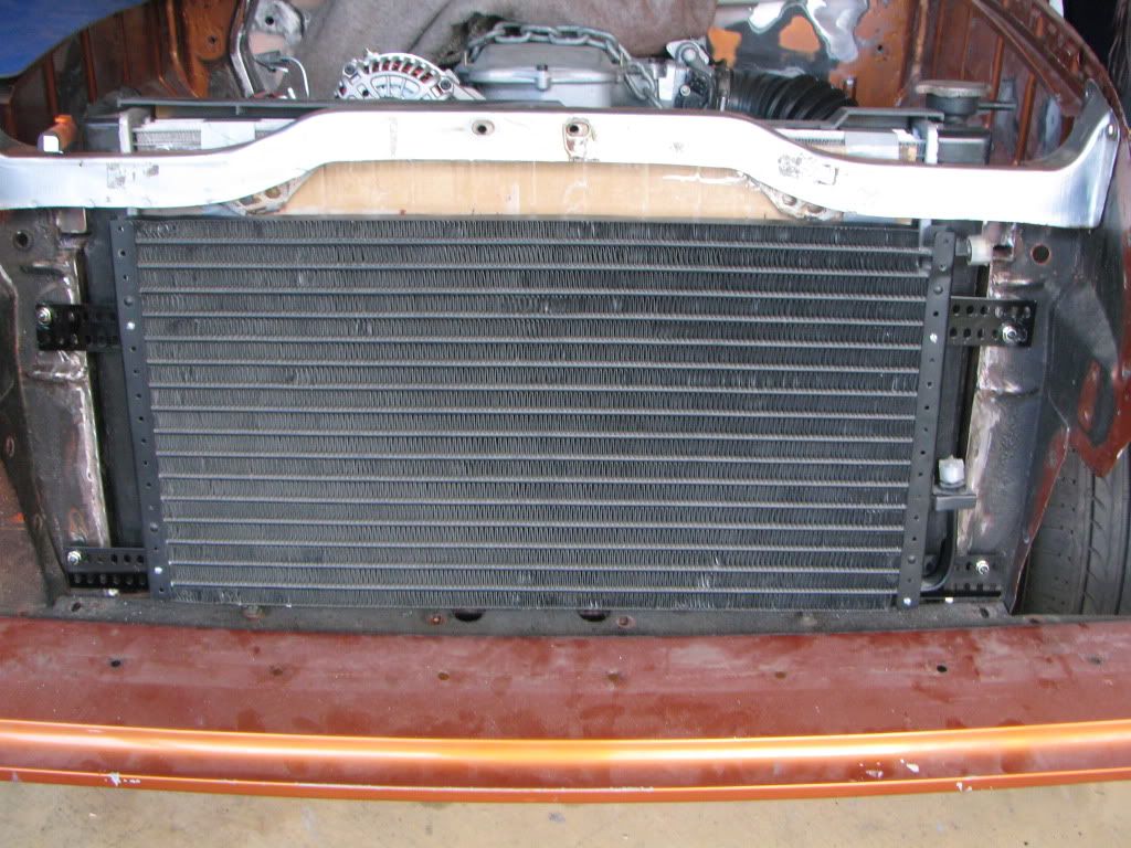

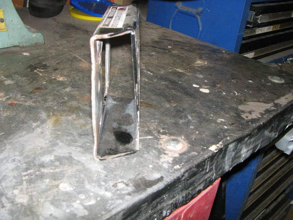

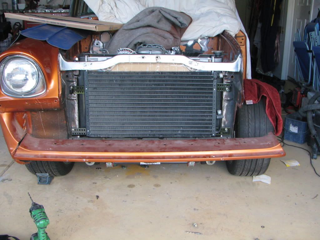

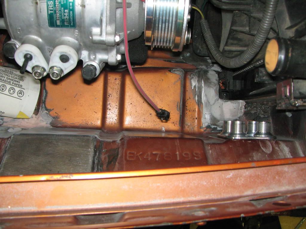

got to spend part of today doing some work on the air con condensor
it's 710mmx350mmx20mm, fits perfectly over the TV radiator
got to do a little bit of cutting on the bonnet lock bracket so it fits on other wise it fits nicely

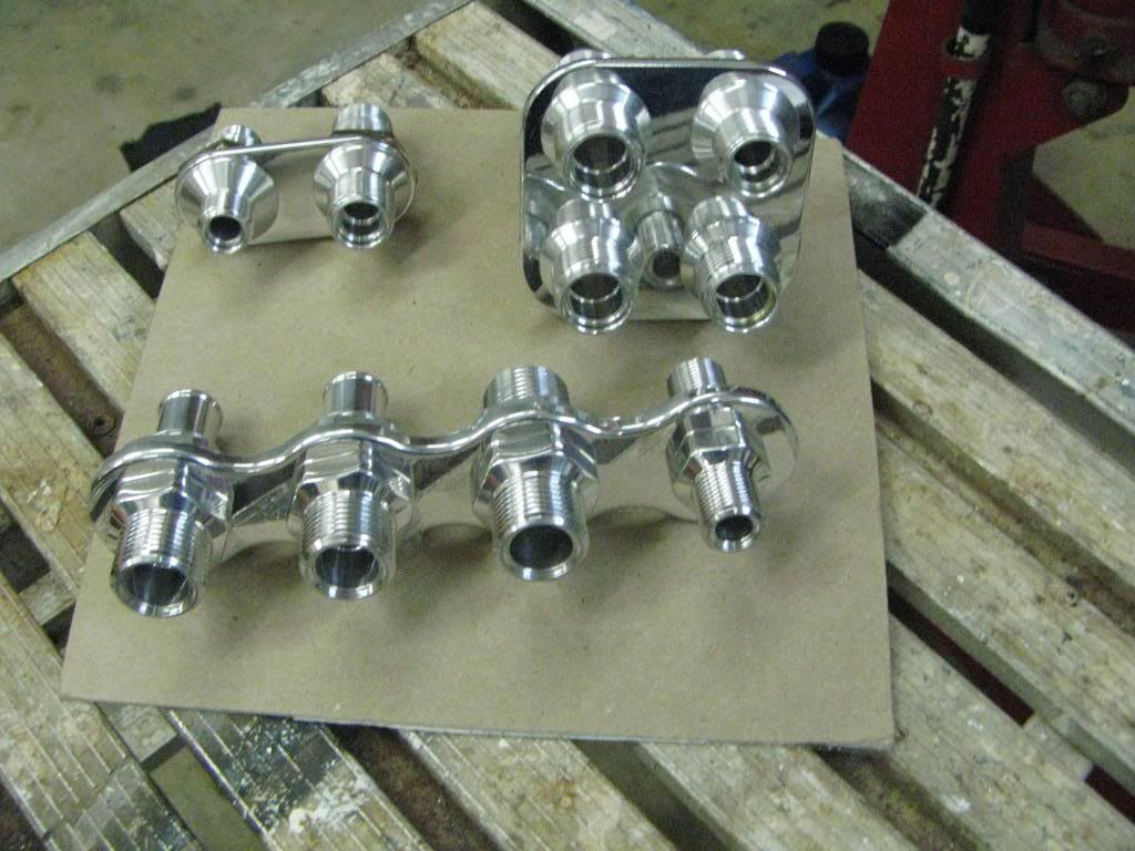

had to use three lots of bulkheads to keep the hoses out of the way and so i can take the engine out without to much trouble
now it's in i can order the rest of the O climp fitting, that i need. and take the motor back out and respray the bay,when i get a weekend off (end of march)

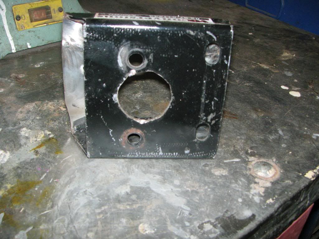

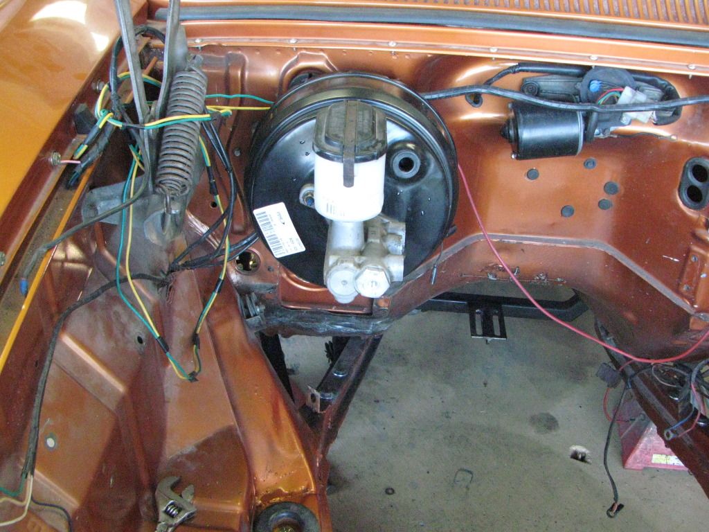

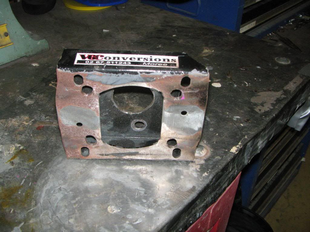

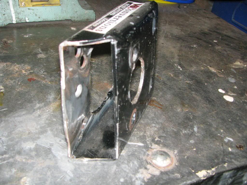

Can you answer a few questions about your brake booster set up please.

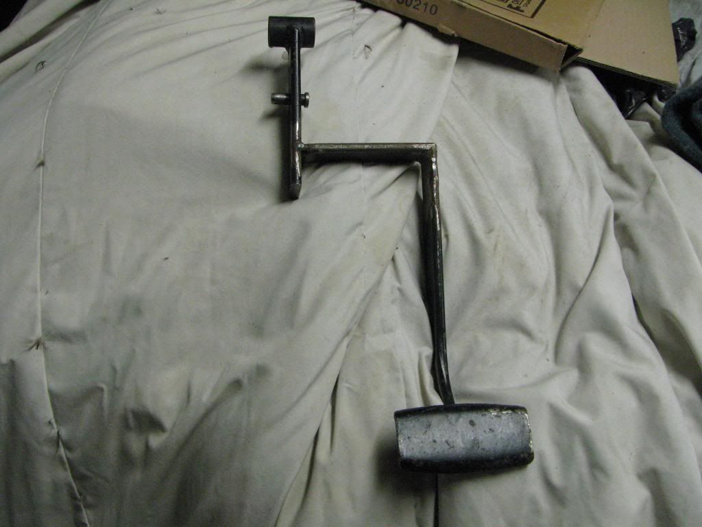

Does it mount through the original clutch master cylinder opening in the firewall? What pedal set up are using?
michaeljohn1234m
Posts: 185

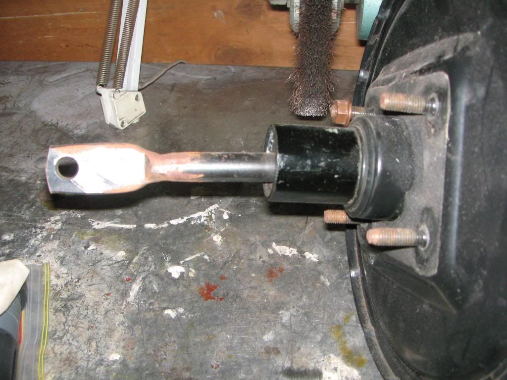

[quote="Cogburn"]Can you answer a few questions about your brake booster set up please.

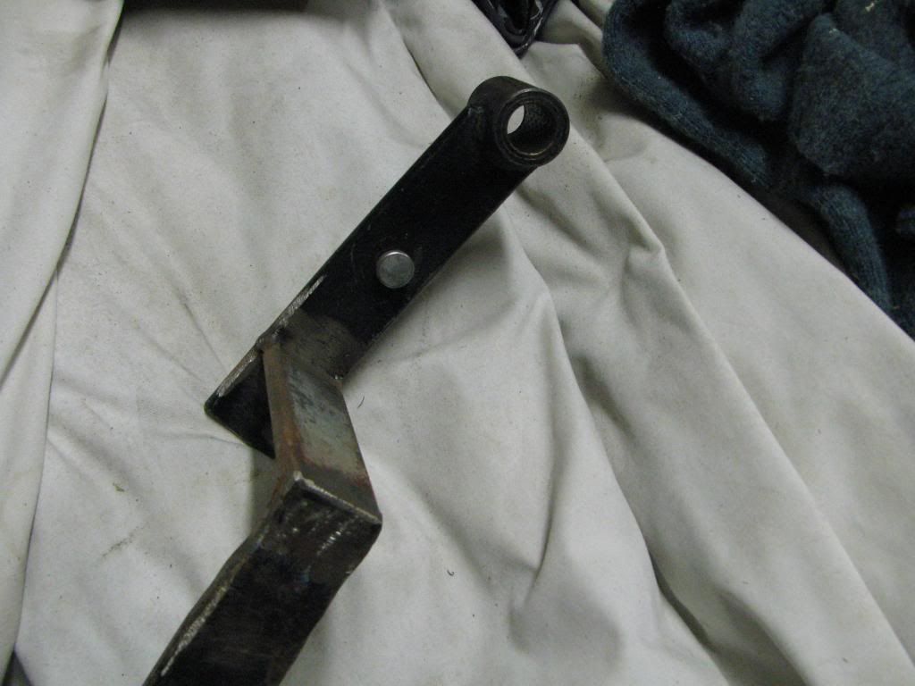

Yes it does mount through the original clutch master cylinder opening in the firewall,i used a V6 Conversions mounting plate that i adapted to fit or you could make your own,had to shorten the power boosters rod also( to long),as for the pedal, some just bend it over near to where it should be , i though it was way too short so i cut it and added to it using a VS one i had.if you have a mig and a grinder it's not that hard at all just time,What engine are you using

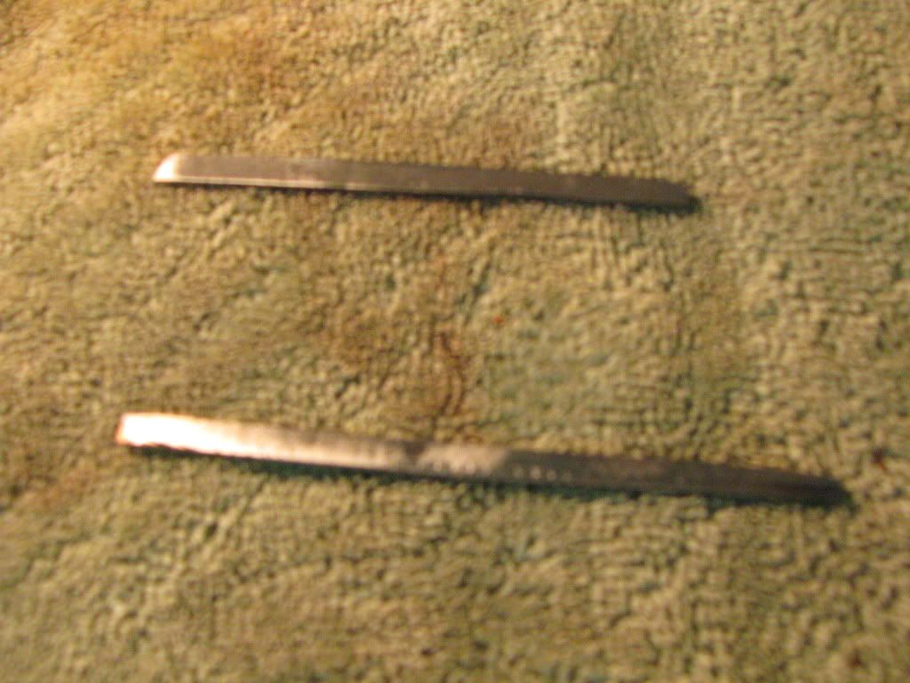

shorten
cut to fit in right spot and angle
