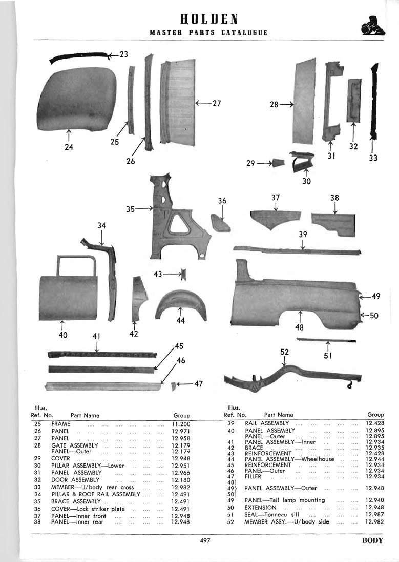

hey Danny... WOW!!!
thats some rust.
heres some pix from parts manual that might ??? help. good luck mate.
sam
sam
- body parts - 1_Page_2.jpg (197.73 KiB) Viewed 2477 times
