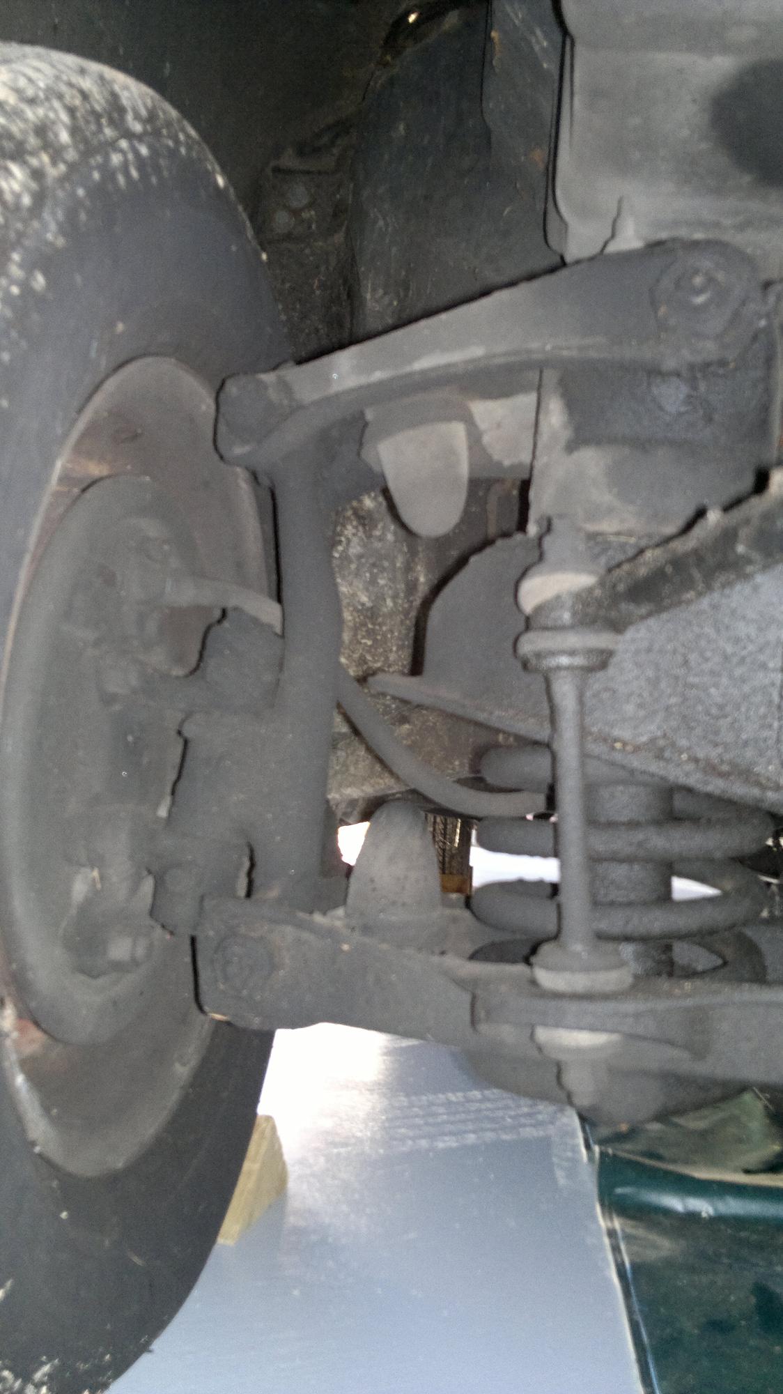

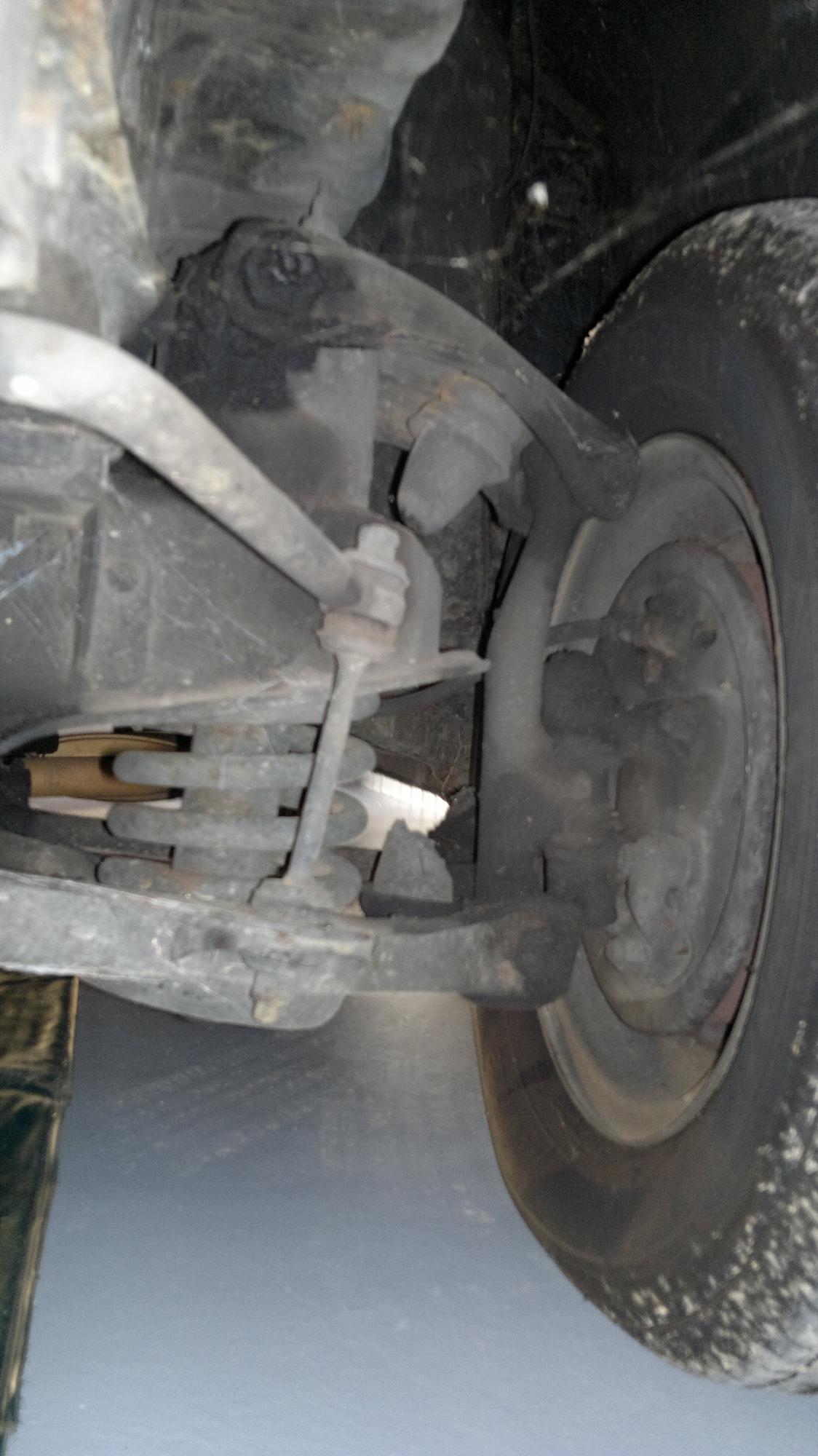

Hey guys,
Here are some photos of each side, i am pretty sure it is a king pin front end but was hoping you could confirm that for me.
If it is a king pin front end that means that it still has the original front end in her right?

Re: Front Help
King pin alright
, as original

Re: Front Help
Be careful mate,
just because its a kingpin front end doesn't mean its original to your EK.
EJ, EH, and HD's came out with kingpin front ends as well.
In the past some people used to fit them to EK's and earlier models to either get the larger brakes and or red motor mounts. After that there was HD ball joint front ends with drum brakes, then after that HR disc brake front ends appeared and all the rest fell by the wayside.
You need to check your brakes to see what width they are, whether they are leading trailing or duo servo, etc
Also check to see if the outrigger is rivetted to the front end or welded. If welded that would indicate if there was a swap in the past.
One quick give away would be to see that there is either two brake adjuster slots at the top of the brake backing plate or one at the bottom. FB & EK had the two adjusters at the the wheel cylinder mounted in the top of the backing plate. EJ onwards had duo servo with a single adjuster at the bottom.
Hope this helps.
Hope this helps.
Re: Front Help
Not sure that the lower bump stops are fb/ek, unless there was more than 1 type?
Fb/ek are shaped like a light bulb?
Someone might correct me on this

Re: Front Help
i've seen more FB/EK front ends with this type of bump stop than the bulb type (unless they've all been changed)
and as for the brakes they look to be FB/EK brakes so i'de say there's a pretty high possabillity that it's the original front end

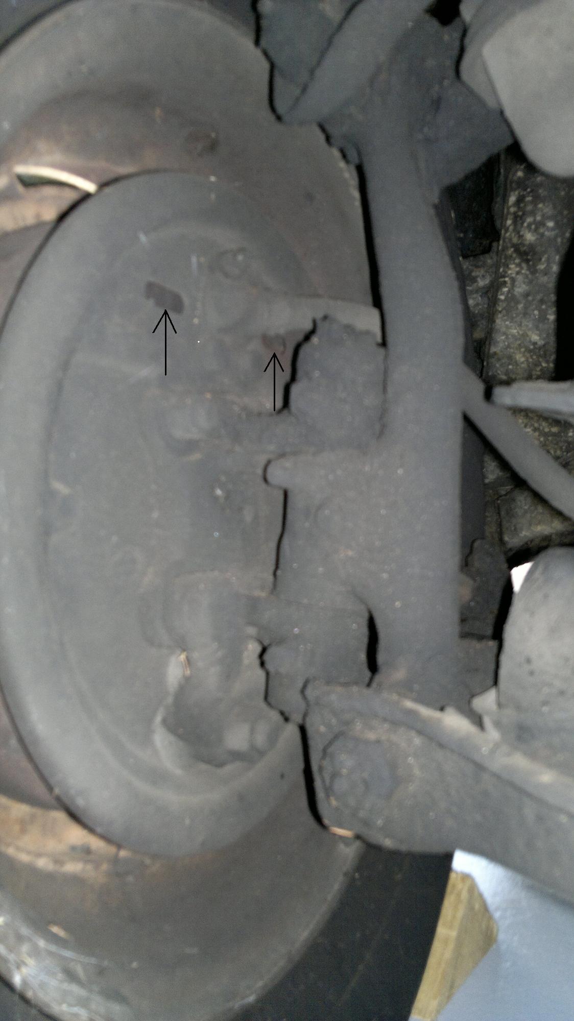

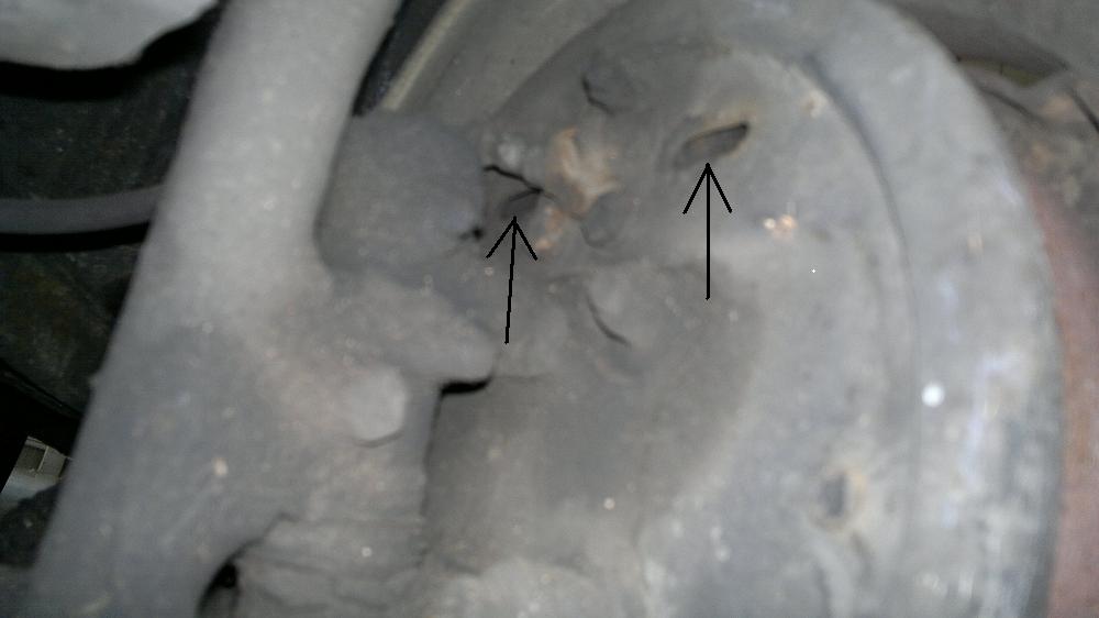

I checked the front brake adjusters and found that both sides have 2 slots either side of the wheel cylinder as can be seen in photos, so would it be save to say it is the original front end????
A huge thanks for all your help too guys!

Re: Front Help
definately not EJ or later
