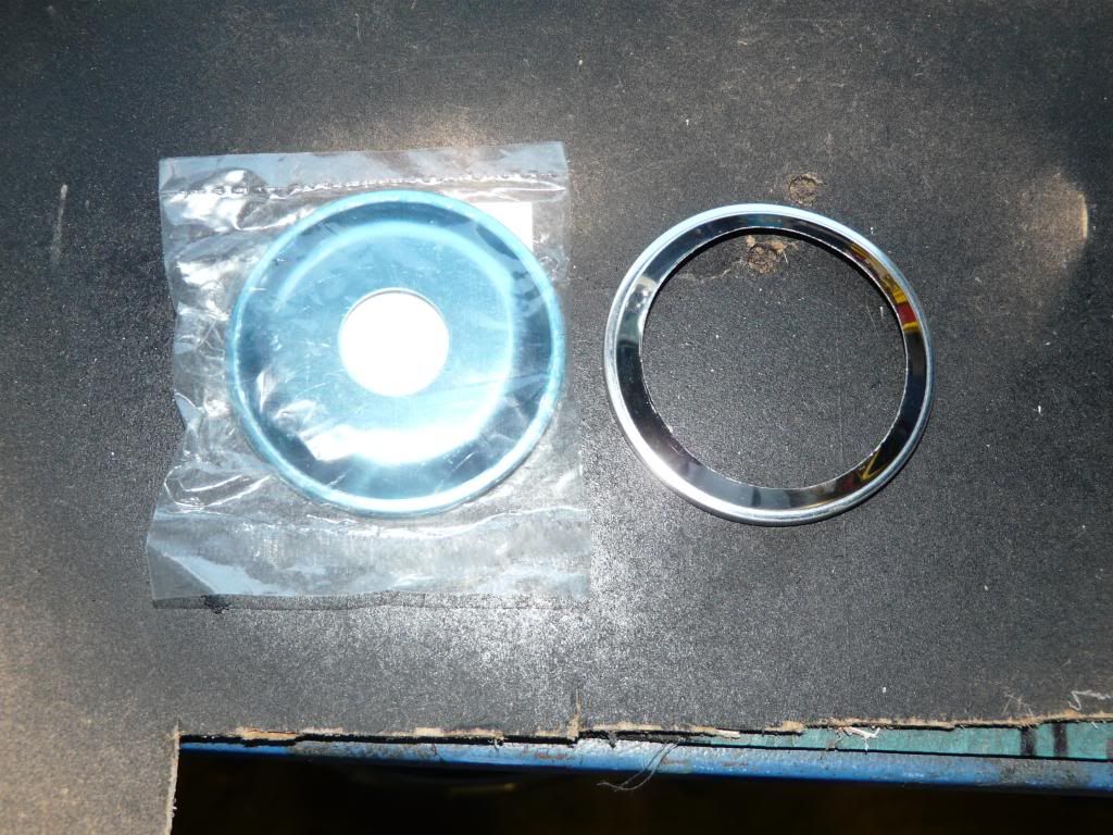

Finally here's something that might be useful if fitting 2" gauges into the EK housing:
Chrome tap surround - $1.70 at the hardware shop:
Center filed out (not hard, it's pretty thin - and I used the electric file!) to take 2" gauge:
and Bob's your uncle. Not the best photo but you get the idea. in the flesh it looks like it was made that way.
