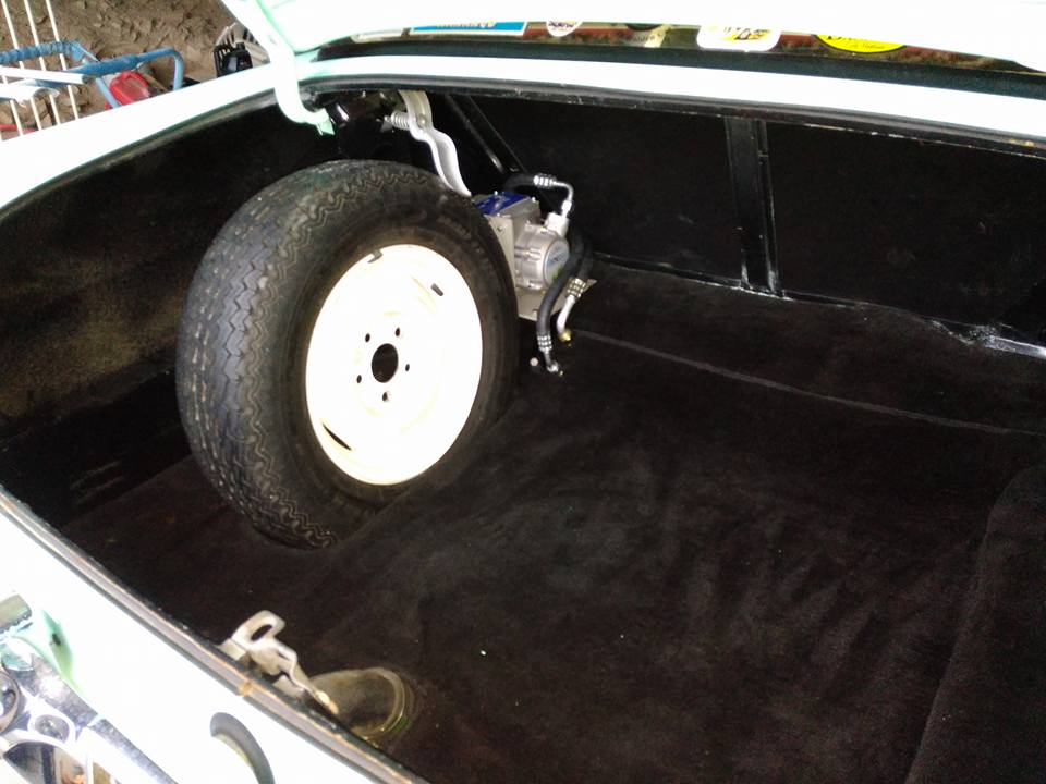

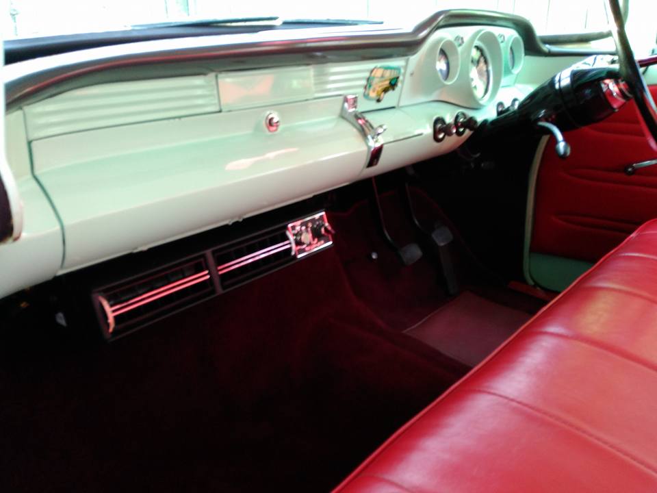

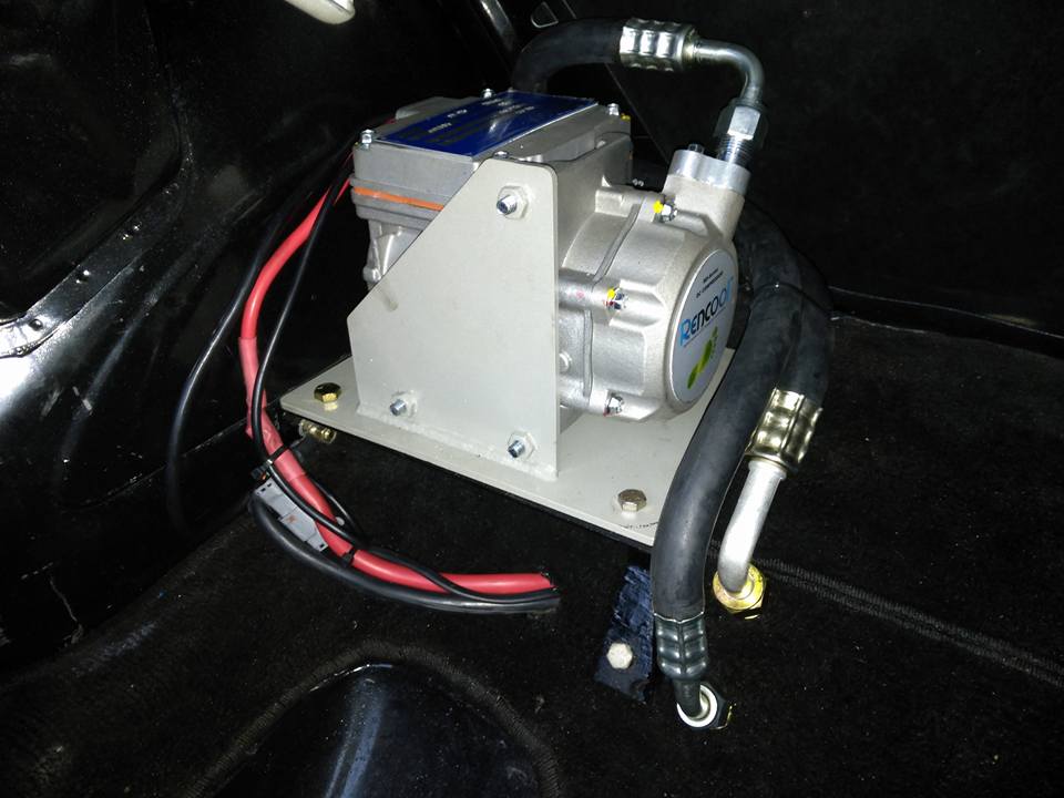

G'day Folks,
The Mad Air installation is very interesting and looks tidy in the standard FB. I have pasted some pics from Facebook. What has been done is to install a 12 volt electric compressor in the boot, which is made by Rencool (Qld Co) rather than have the compressor engine driven. The refrigerant discharge line and suction line would be slightly longer than standard installation but not a big issue and may well be routed under the floor?
What would be an issue here is your elect system as the compressor specs show the current draw at 36-55A. Mad Air has upgraded the alternator to a much larger unit given the original grey motor generator is good for around 240 watts from memory. Of course you woul need some decent size cables to handle that current and minimise voltage drop too.

That's pretty cool if you'll excuse the pun. I wonder how much noise they make. Thinking that it could be mounted under the load floor in commercials, thereby shortening power and gas runs. Any idea on pricing Stephen?

When I enquired about price I was quoted $4,400 for the same kit in his fb standard including the alternator conversion (needs a 120 amp alternator minimum) and installation

D-MAN wrote: Fri Nov 03, 2017 10:56 amneeds a 120 amp alternator minimum
:shock: Thats a monster alternator just to run AC on a grey.
The VL runs all the electronic sorcery and electric fruit, including AC, and only pulls a 70A alternator. The VE only runs 100A.
