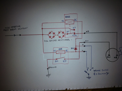

My magic box involved a couple of relays and some semiconductors for the speed control. I'll sketch a diagram and send it when I get a chance. If you've got half a brain you could build one, I did and I've only got half a brain. The basic setup without intermittent has been working fine in Trevs wagon now for a while, and it's been raining here in Melbourne.

Right, here is the basic circuit as is wired into Trev's wagon. When low speed is selected, only the "on" relay energizes, grounding the sw terminal of the wiper motor. The batt feed comes in via the two bridge rectifiers, which drops 3.5-4 volts. This brings the wiper speed down to about two thirds, which i reckon is a more normal wiper speed anyway. When high speed is selected, both relays are energized and the bridges are bypassed. So the motor gets the full whack. It's designed to go straight into a standard circuit with the single speed motor. On my car, the slow rate is about 35 cycles per minute, on high it's about 55 cycles per minute. My engineer for my project FB wants >45 w/m at high speed, so it works for me!

cool ,those are great speeds ! my last ek had factory (?) 2 speed and i had to silicone the screen AND take an average over 15 seconds and multiply by 4 to pass inspection.....
